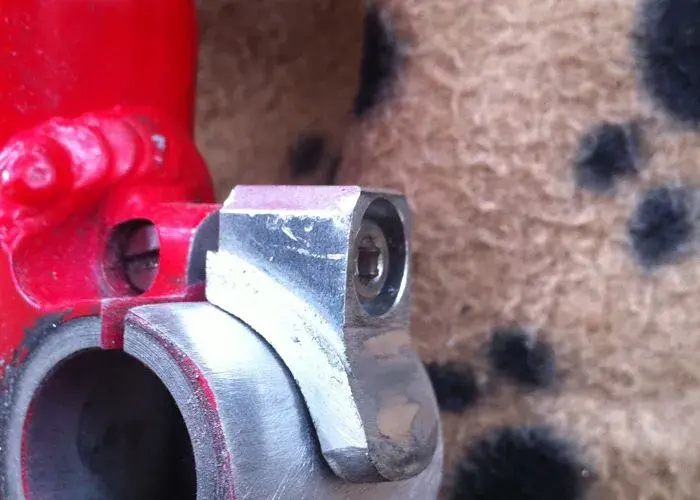

ive totaly stripped down the bike and cut off the pinch bolt tab that was cracked, going to weld a new one on tomorrow. also ive found that the drive side horst pivot point was ovalised so im going to weld the hole up and redrill the hole.

and i might paint it a new colour once ive fixed all the bad points ill keep this updated as parts are fixed or replaced for now here is a picute of the crack that ive now copped off.

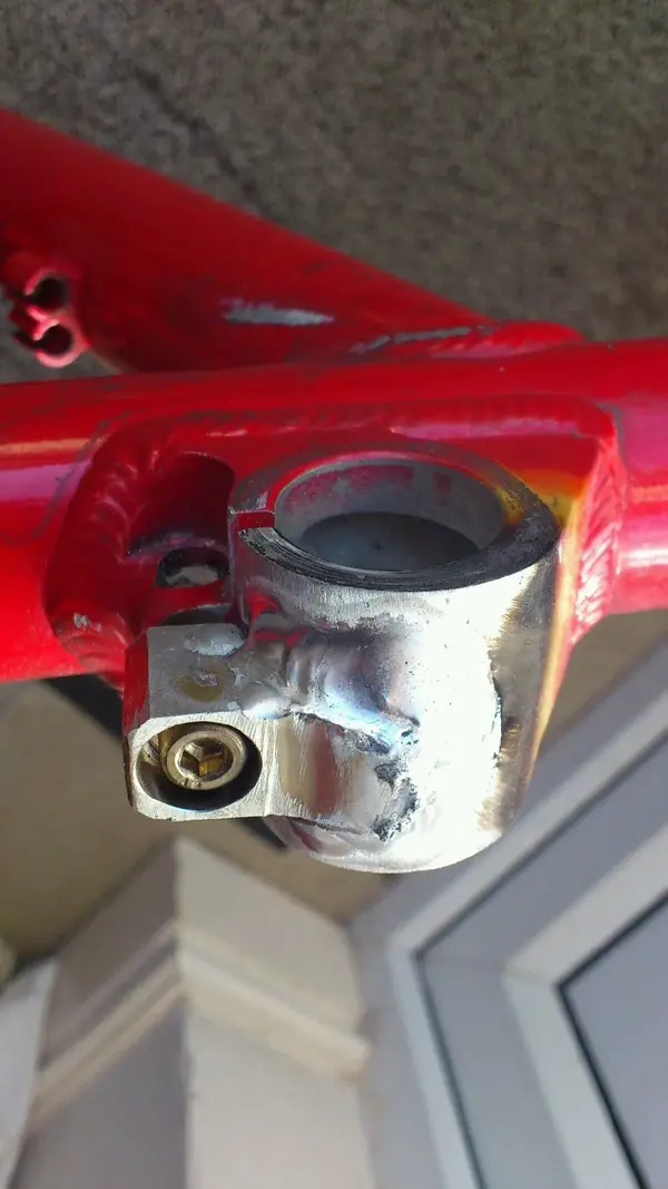

i made the new part of the pinch bolt and now its goning to get welded on

so i got some pics finally of some of the repairs ive done they still need tidying up ect
the first pic is the horst pivot point that was welded up and then reamed out to the correct size as it was oval
all looks messy but ill have it looking pretty soon
