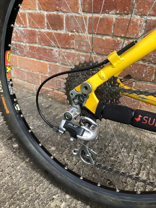

Seller also failed to mention cassette was 9 speed as was chain and shifters were 8 speed plus the headset was shot with missing bearings and gouged races😡

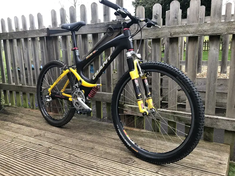

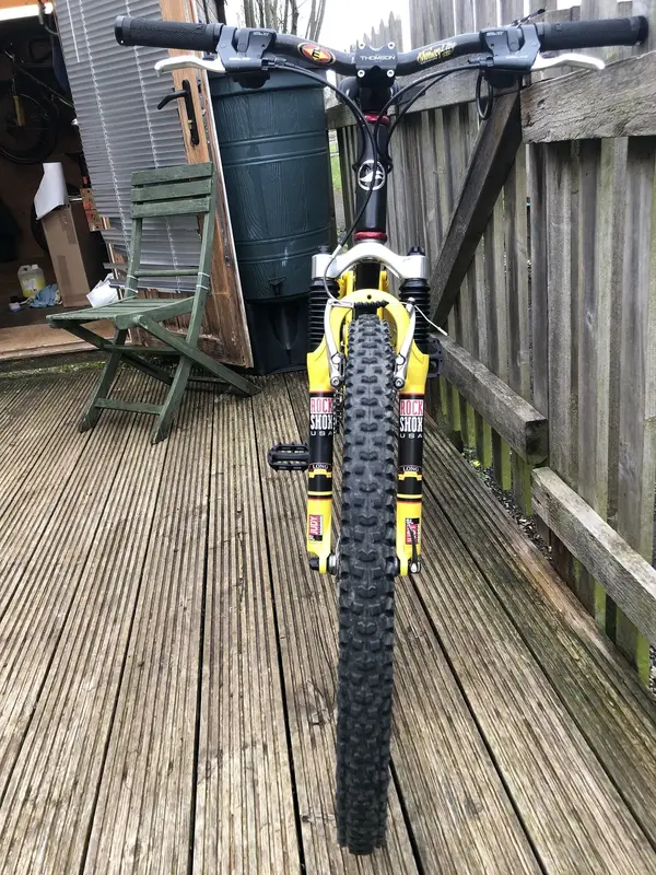

Pretty much done other than awaiting the new fork decals, didn’t realised I’d purchased them from the US when trawling eBay, wish I’d contacted Gil now given the time to post but still…….
Quick ride around the village, over some fields and back has been successful other than I may need to acquire some harder springs/ elastomers for the long travel Judy SL’s, comfy ride and everything else works great 😎

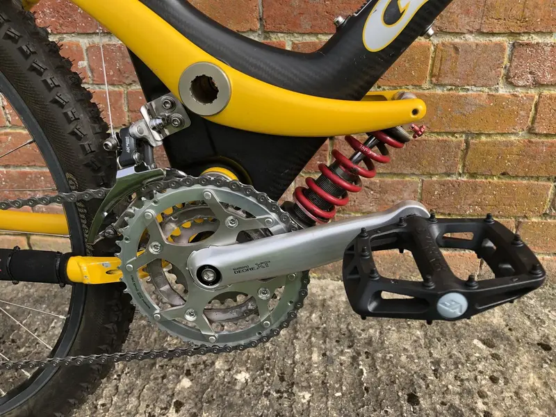

Hey Teus, thanks buddy. Haven’t had any Thomson bits on a bike for a while and they just look great, had to be a King headset and I’m bored of using XTR and the XT just looks and works beautifully 😎
I wasn’t sure about the pedals as when I bought them I realised the spindles are stiff as you like, apparently they use bushings rather than bearings so I guess if they are tight they don’t wear so quick. Still, they pedal fine and with good looks, a low weight and great price, what’s not to love?
Ordered a set of springs for the forks to stop them bottoming out, old inners can become spares for the Mrs’s Judy’s:

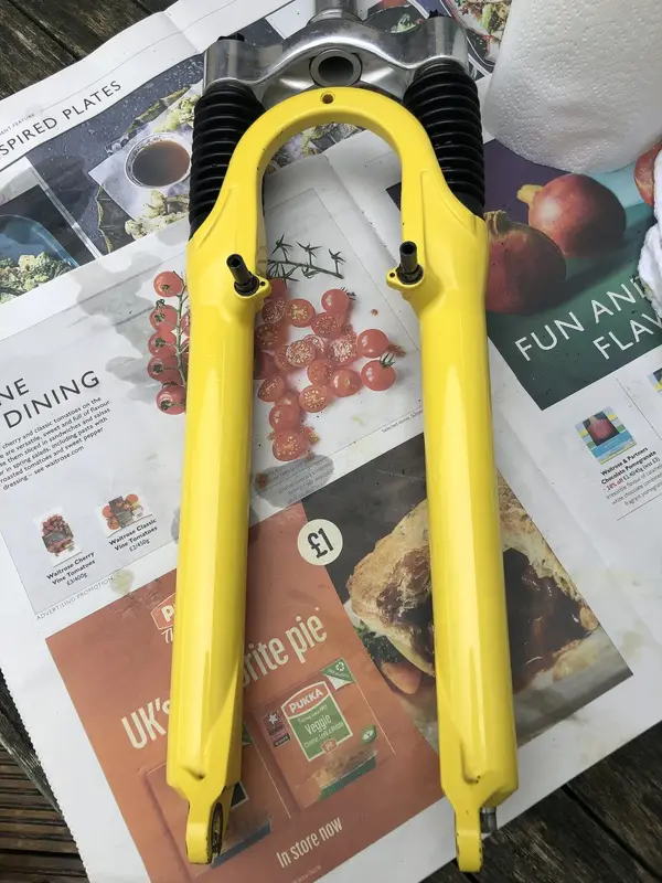

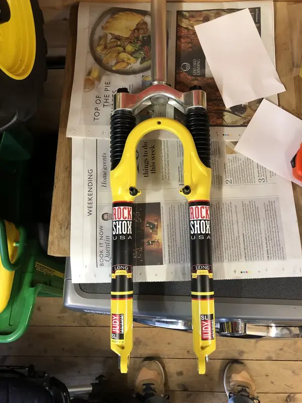

Time to give the 98 fork some love, first step, replacing the worn and peeling decals with some from 97 to match the catalogue look:

And mounted, just the new springs to go now:
