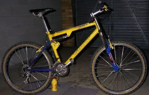

i imagine it came new with a single crown fork , I bought a new ATX 990 in 97 and that's all it had (and still have it for visitors) it had 8speed gripshifters XT parts and a noleen rear shock
Here's my little ATX 970 budget-ish project. :D
