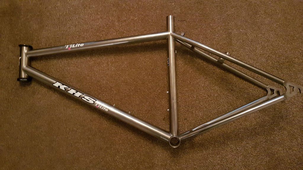

So, I bought another KHS. Thats not a surprise as I own a few already. Except that this one is unlike the others as it is Titanium, my favourite metal for bike bits BITD as there was no way I could afford a Ti bike as a poor student at that point in time.
I stumbled across it on ebay by myself recently. Bid on it, won it then found a thread on here commenting on it : viewtopic.php?f=4&t=366773
So here are the pics copied from the advert:
Nice side view

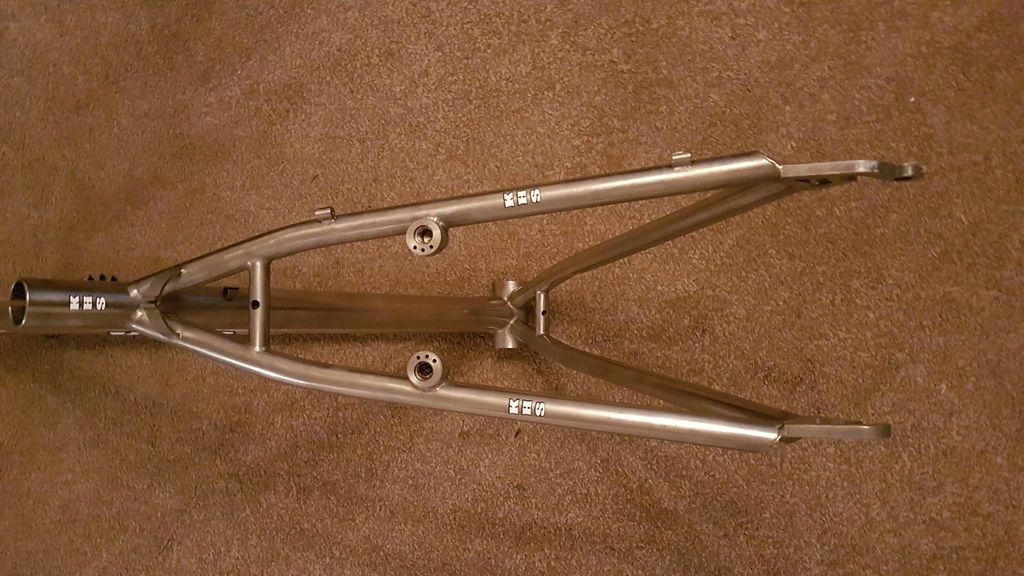

View from beneath. Could FM be a sponsored riders' initlals?
I need some rear brake bosses:
Tyre Rub:

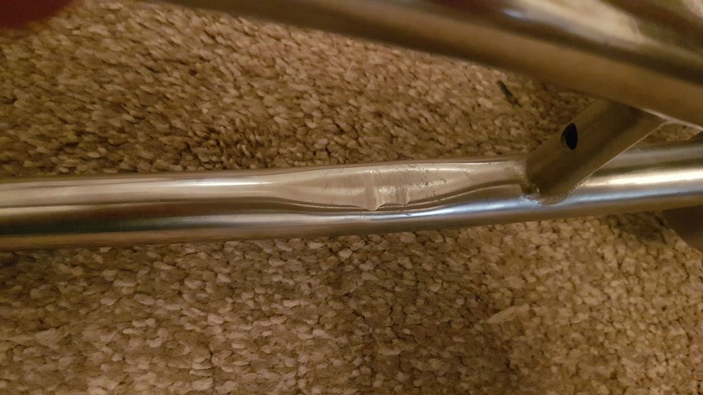

Top tube dent:

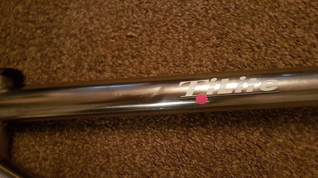

That was about a month or so ago. All I had was a frame and no knowledge of what the spec of the bike originally was. There is literally no knowledge out there of this bike other than a handful of people on here in the last 10 years also trying to find out more about theirs to no avail. It is known they are from Litespeed, built in 1995 and most likely sold as frames as they aren't in the catalogue or catalog as they call them over the pond...
From the RB ebay thread I was advised I should be looking at building it with XT M737 and Mag21's as good for a 95. And of course I'm not going to do that. As such I've acquired a full XTR M900 groupset for this frame. I had a nice Bontrager Ti handlebar in the stash. I've acquired a nice Ti Syncros seatpost and a Litespeed Ti Saddle (which makes a change for me as Flites are my normal standard). I've acquired a NOS Ti Stem that is as shiny as the frame, its a Ballistic and I've never heard of them but that isn't saying much. I've acquired a 107mm Royce Titanium BB for the M900 crank. In the stash I have a pair of wheels with an XTR M900 rear and a silver Hope Ti front hub with silver Mavic x517 rims with double butted spokes. They are very nice indeed and inreally nice condition. I've got a pair of new re-issue Smoke and Dart tyres with amber sidewalls too. Should be very nice. In my infinite stupidity I've managed to buy some Rockshox Judy DH's with 80mm travel which should go nicely on here. The only bit missing is a headset which will be a 1 1/8" Chris King in an undetermined colour, silver to match the frame, black as that seems to be the most popular colour for sale or red to match the forks.. Who knows...
I'm hoping to get this one built this year but am in no mad rush as I've a few more projects in the queue ahead of this, the 93 Montana Team from Wadsy (I just had to buy that) and the 93 Raleigh Torus LX in no particular order...
