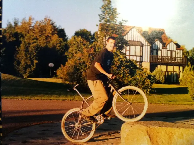

thanks guys!
I just found this picture!...it is about 1996ish...at this point the tioga's had long worn out and had been replaced by smoke and dart magics. (simliar to the XC magics I had) Also, the drivetrain and shifters were whatever could be found cheap!..still had the 737 at least!
I am looking for a pic when it had the psychos and original groupo. I know i saw one years ago..
