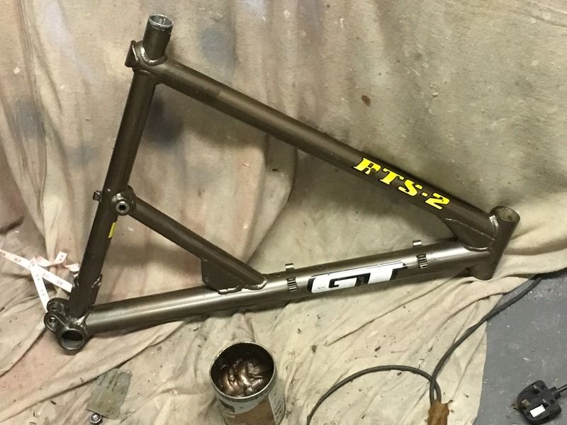

The rear triangle got stripped back to bare metal then etch primed, primed, painted, new decal apply (thanks Gil), clearcoated. Only a DIY rattle can job but came out well and certainly looks loads healthier than it did. I actually went to the trouble of getting the frame paint matched too as I was going to do that as part of the original plan but have left it as is for this build. Whoever has it next can have the can I had made!

Repainted rear end

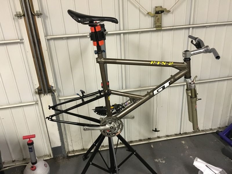

The rebuild starts (the Judys had a minor service while they were off the bike)
Back end and chainset on

.......and it's done. Not many pics of the rest of the rebuild as a) it wouldn't have been hugely exciting and b) I have really nastily done my back in this week so things have taken longer than planned and have been more a case of "get it done".
Anyway, all back together now. I'm still not wholly happy with the rear hub as it's rather grumbly. I think the cones may be goosed. Will have another go if time allows but it spins and there is no play. Both ends bounce pretty nicely, the brakes and gears work sweetly and it all feels tight. The tyres are, in my opinion too wide for it at the rear being 2.35s. There was a slight rub on the non drive side but a quick bit of truing sorted that but it's still plenty close on either side.
Nice looking bike though now she's back together. In hindsight i think I have cabled it up incorrectly with both mechs down the right and the rear brake on the left. Reason is that the stop on the rear of the seat tube for the FD is angled such that it'd be better being fed from the left hand side of the bike. However, with V brakes having the rear brake going down the left hand side makes for a neater cable run to the V brake noodle so I'm not too bothered.
