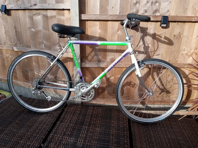

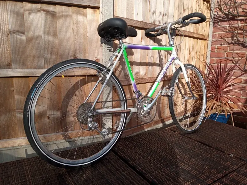

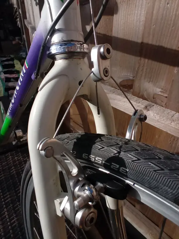

After lying dormant and partly completed in the shed for several years I have finally added a few more bits to this build and decided that it is now probably as finished as it ever will be.
I acquired the frame several years ago in a used condition and eventually decided to add contemporary Campagnolo ATB components. Some of these I acquired as NOS from Nigel Scott at Campyoldy and some NOS or used from Ebay. I had to have a new longer steerer tube fitted to the front forks which meant I lost some of the original green and purple paintwork but luckily the chrome on the forks survived.

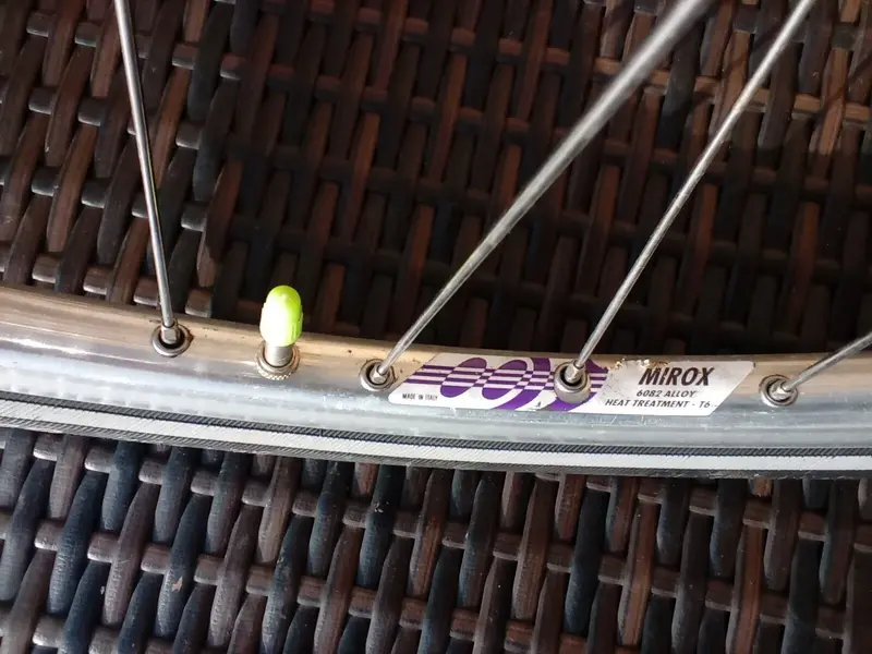

The wheels were built by Pedal Power in Loughborough using NOS Campagnolo rims and hubs which I had acquired from Campyoldy.

Main components are:-
Frame: Simoncini Falck nickel plated steel tubing – 47cm seat tube – 51cm top tube

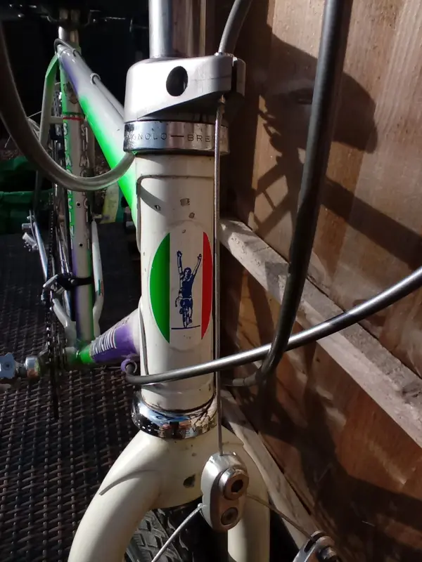

Headset: Campagnolo Centaur - NOS
Stem: Kalloy Short reach forged stem 25.4mm - new
Handlebar: Humpert AHS Basic Sport with comfort bar ends - new
Brakes: Campagnolo Record OR – used

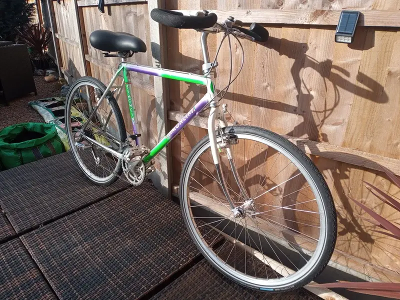

Brake Pads: Campagnolo
Cantilever cable hangers: Campagnolo - NOS
Brake Levers: Campagnolo Euclid - NOS
Shifters: Campagnolo Euclid - NOS
Front Derailleur: Campagnolo Olympus - NOS
Rear Derailleur: Campagnolo Centaur - NOS
Freewheel: Sachs Maillard Aris LY95 7 Speed 13/15/17/20/23/26/30 - NOS
Cranks: Campagnolo Centaur - NOS
Chainrings: Campagnolo Centaur triple 24-36-46 - NOS
Bottom Bracket: Campagnolo Centaur - NOS
Pedals: Campagnolo Centaur SM - NOS

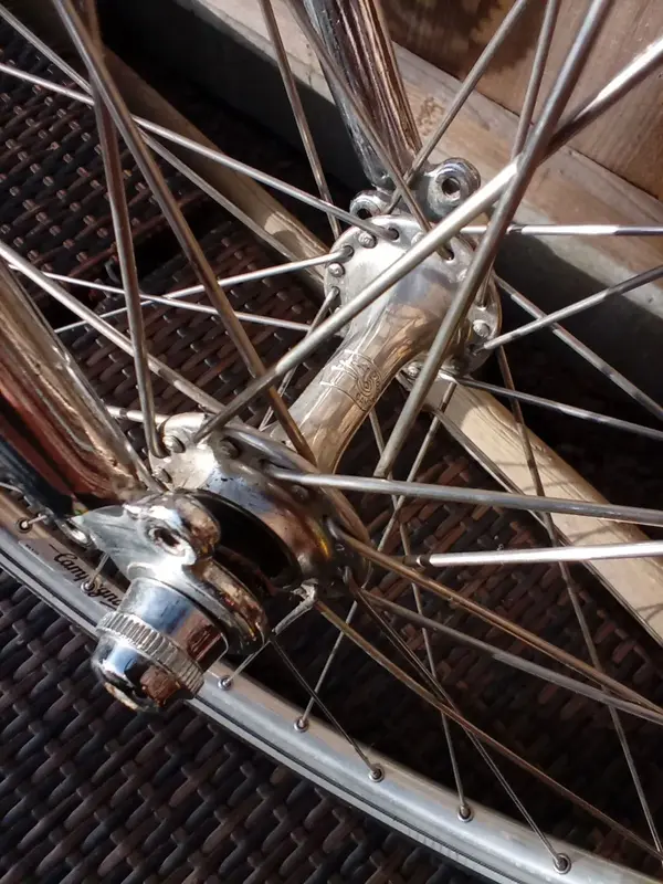

Hub Skewers: Campagnolo Centaur NOS
Rims: Campagnolo Mirox 36h - NOS
Hubs: Campagnolo Centaur - NOS
Tyres: Schwalbe Marathon Original 26 x 1.25
Saddle: Varies depending on the ride – shown with Selle SMP Big Bum
Seatpost: Generic seatpost to suit saddle
Weight: 28kg
I will hopefully use this bike for leisure/commuting including light off road stuff, unpaved bike tracks etc where my road bike won’t go,
