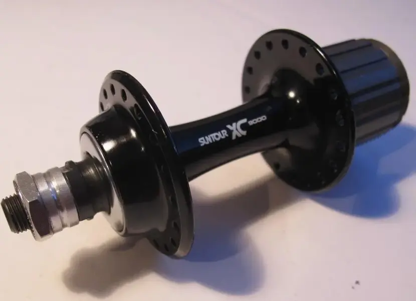

This it up for sale on eBay at the moment but it's the six speed (FH-XC10-R6) version and the shifters I've just picked up are seven speed... Presumably I could change the freehub body to make it seven speed? untitled.jpg

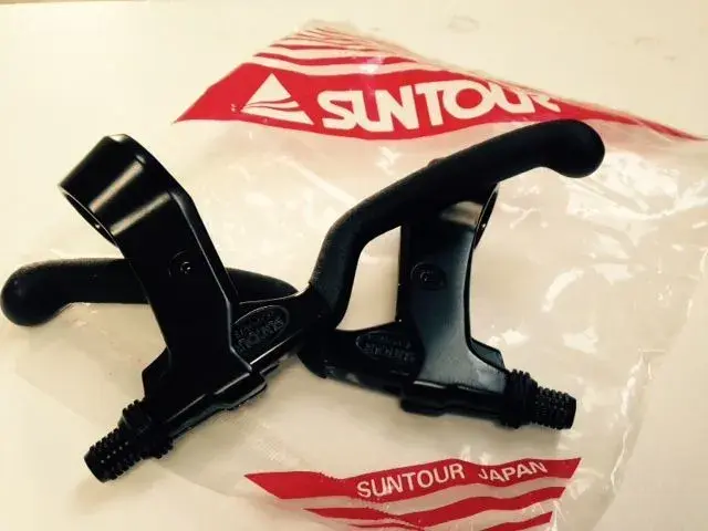

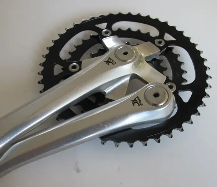

How jammy was I last week when I won this? It's "only" a Sugino GP but it also carries the Suntour XC markings... I've only only seen one other in the last few years of looking, so in my book it's pretty rare.

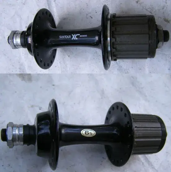

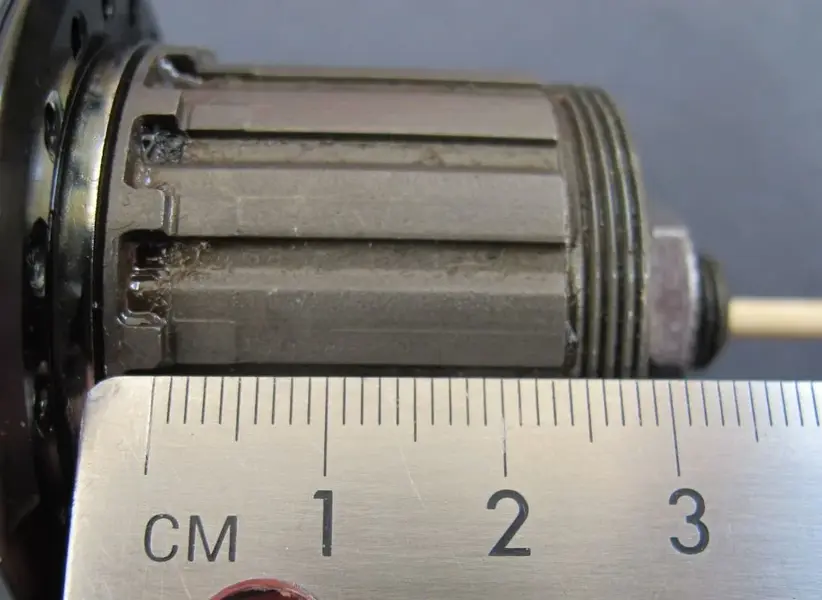

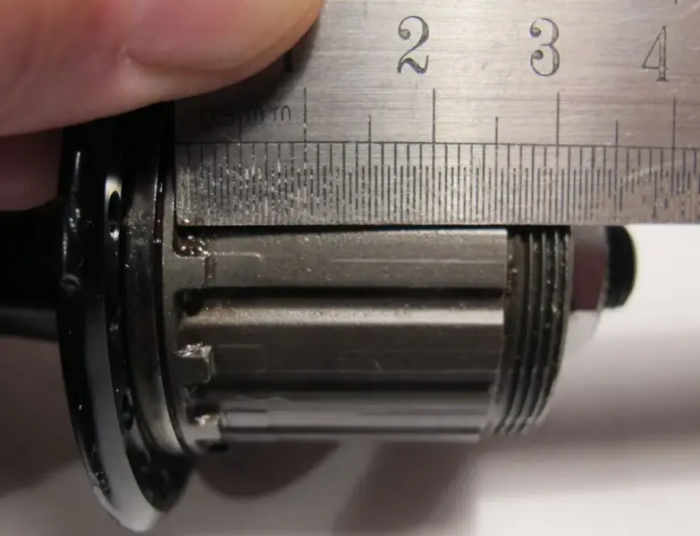

Okay firstly it's 36H not 32H, which isn't a catastrophe but the "6S" sticker is missing. So is it a FH-XC10-R6 or a FH-XC10-U7? From reading this I'd say it's a 7 speed hub; would you agree? suntour_spline_826.jpg XC9000 FH-XC10-U7.JPG IMG_5927.JPG
Are you getting money off on it for not being the hub advertised?
Saying that, what is not so easy to see in the diagram is the spline is measured from the sticking out knobble. At least the picture shows that (It's from Sutherland's 6th, I shipped it out way back).
Check with somebody that used the older 6speed bodies)
In that case it's a 6 speed, so I can't complain.
