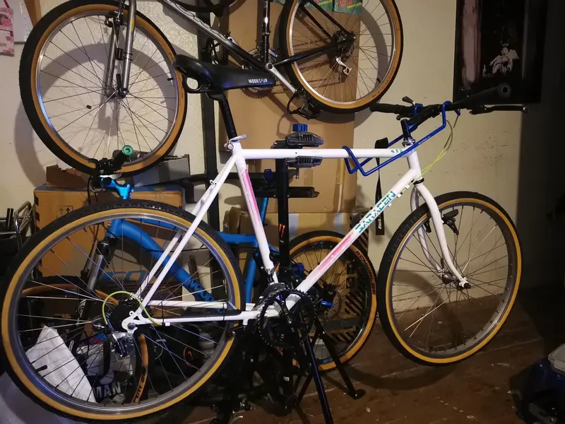

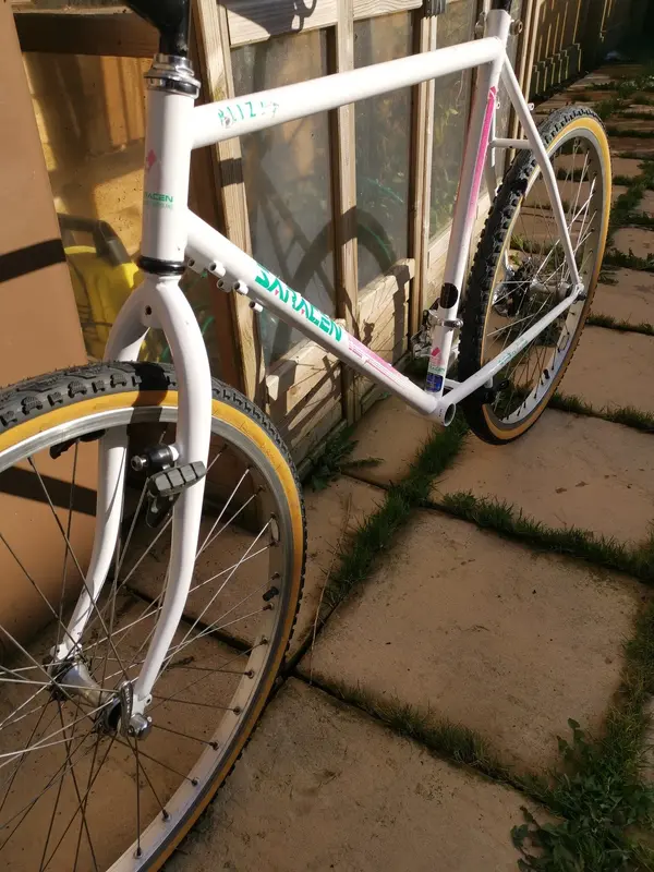

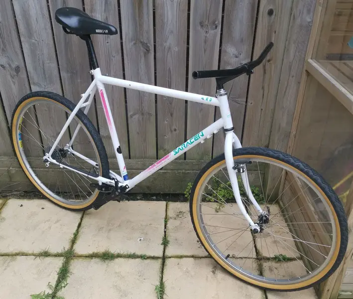

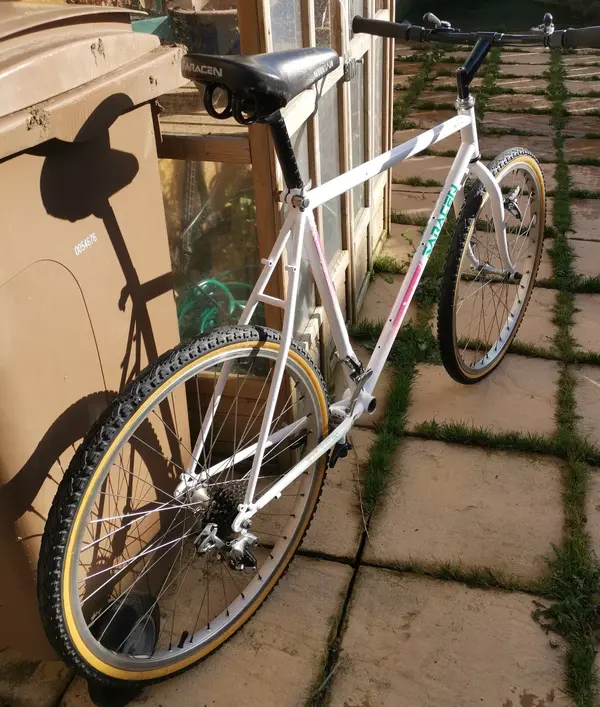

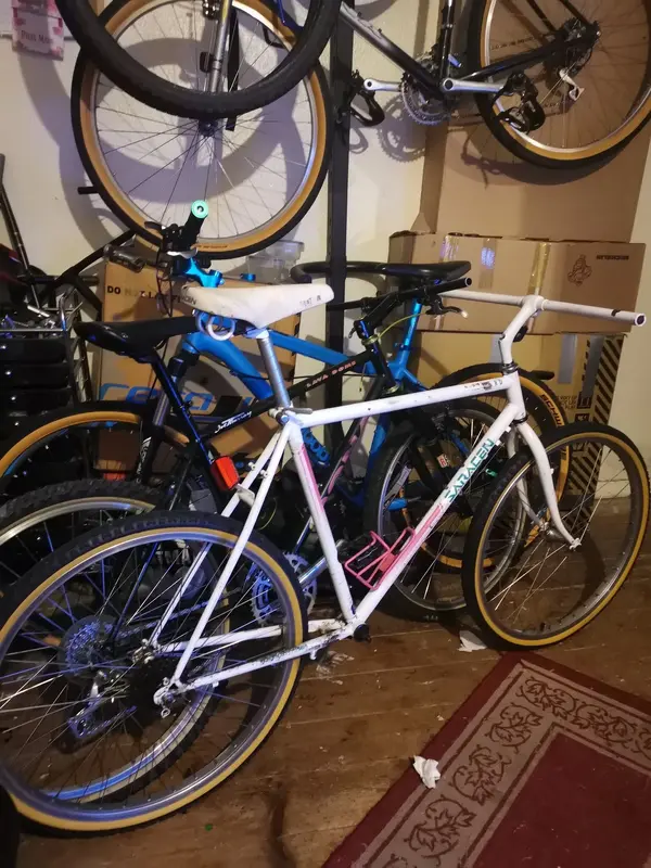

Saying i'm going to start having a downsize of the collection and this Blizzard is on the list of ones to go.
I thought i'd do a build thread because i've had an idea for a nice overhaul and the potential new owner gets to see it come together.

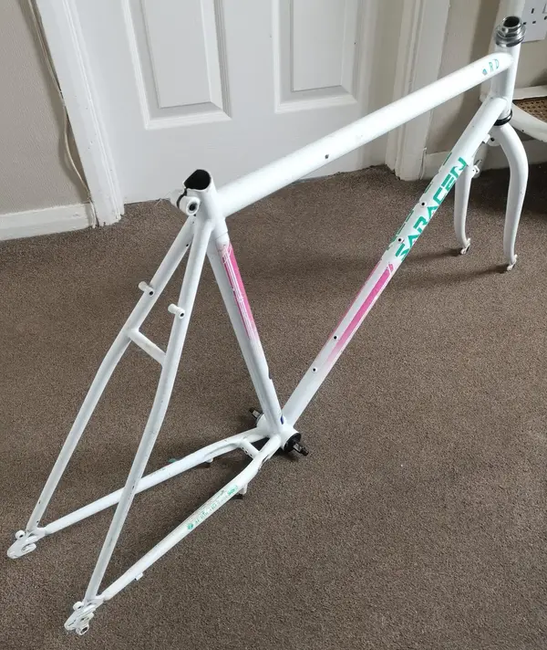

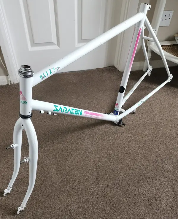

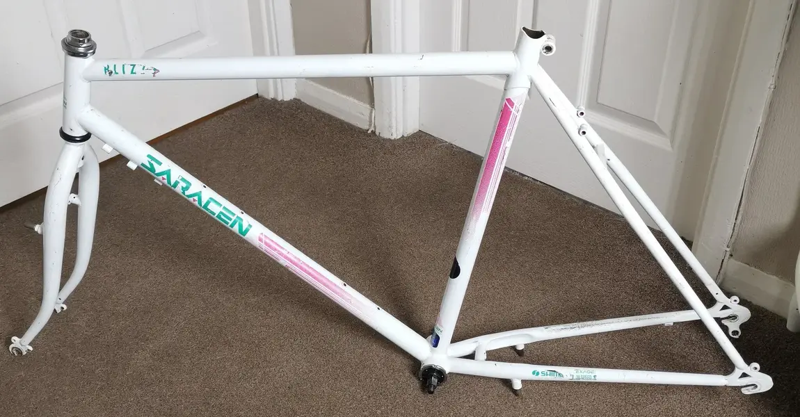

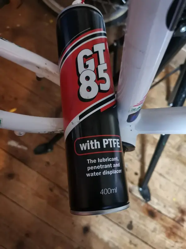

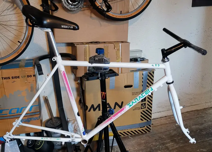

Done the first part of the cleaning using GT85 to get the grime off and it's came up looking decent with no nasty surprises, a good solid frame with not alot of paint loss.
Next stage use some cream cleaner and remove the bb and forks to have a look at the threads and headset.

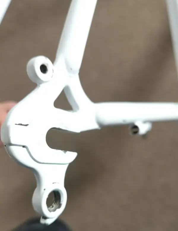

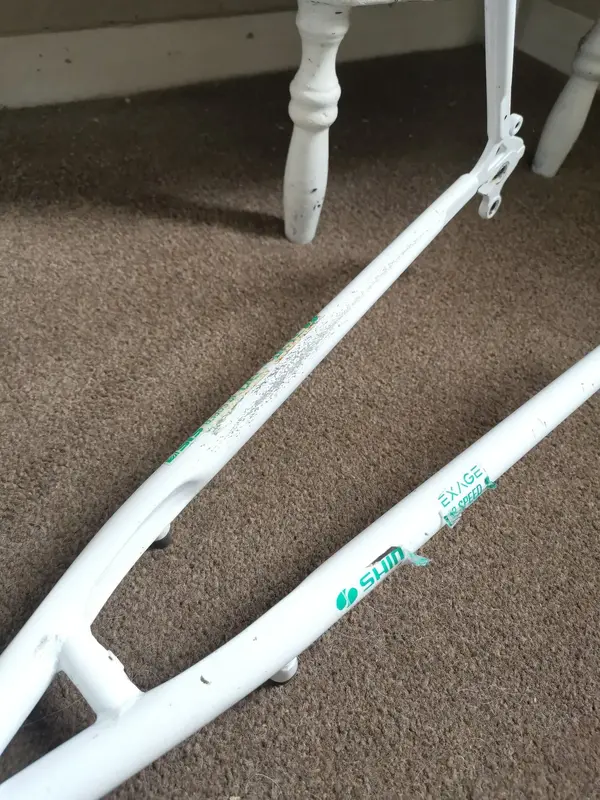

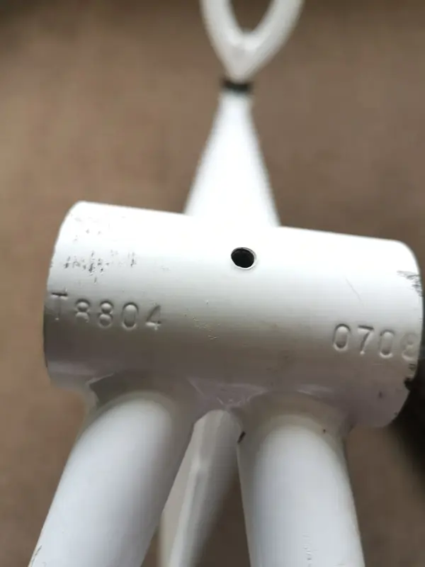

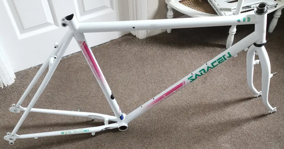

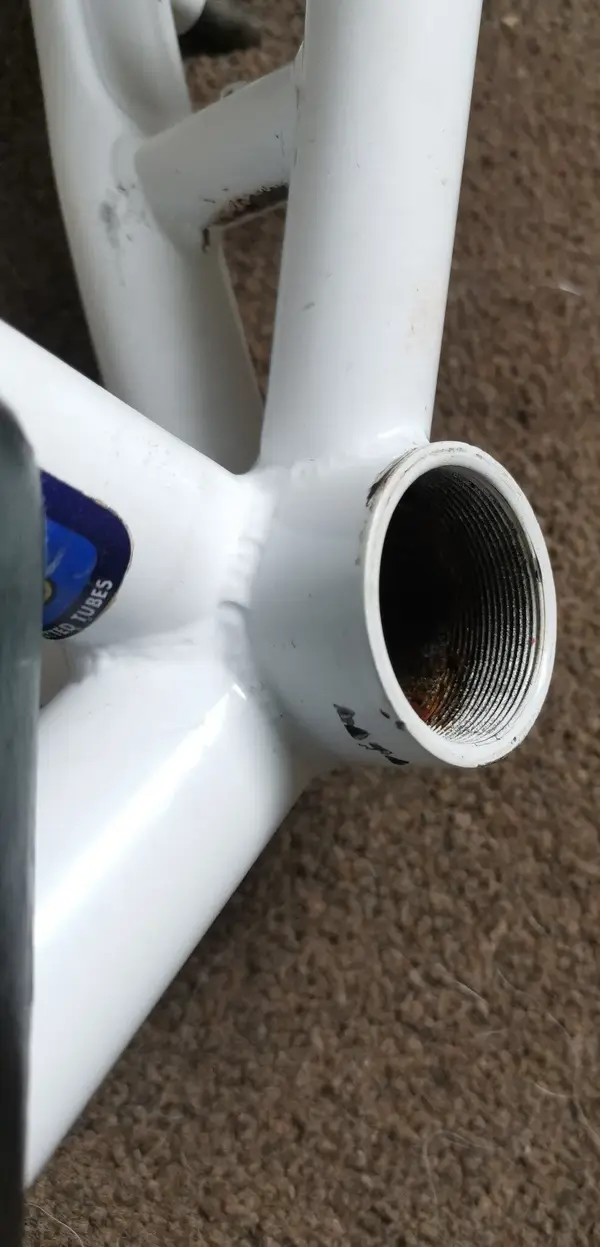

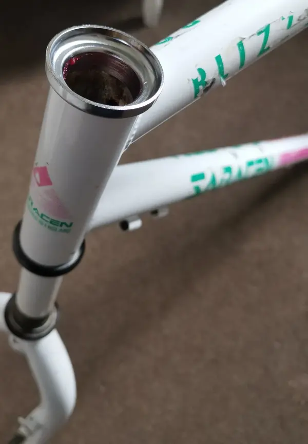

Cream cleaning all done,forks off and bb out which took very little effort coz sometimes they can be a mare lol
Everything looks good to me it's as the original owner said to me that it'd always been looked after.
Next stage is to clean the brake posts and get them shiny again to help the brakes,after that get the polish and get a few coats of that on to get the shine back because the cream cleaner can dull the paint.

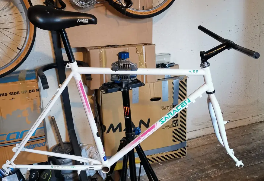

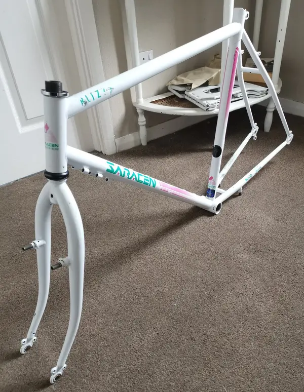

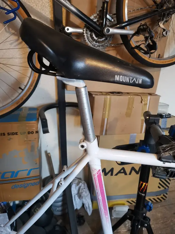

Frame and forks all clean and polished and i've decided on what to sit on and hold onto.

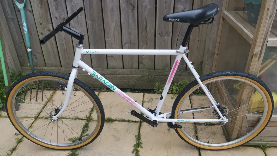

Saddle,seatpost and stem came off a 89 Trekker Comp i used to have and the bars are off the 88 Killi Flyer i've got,the wheels are from a 88 Cinneli i had and are Suzue hubbed on Araya rims.
Now for the parts 🤔

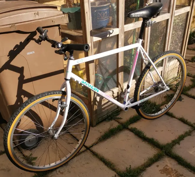

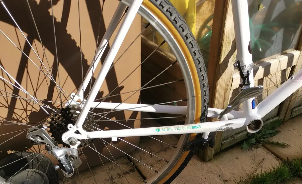

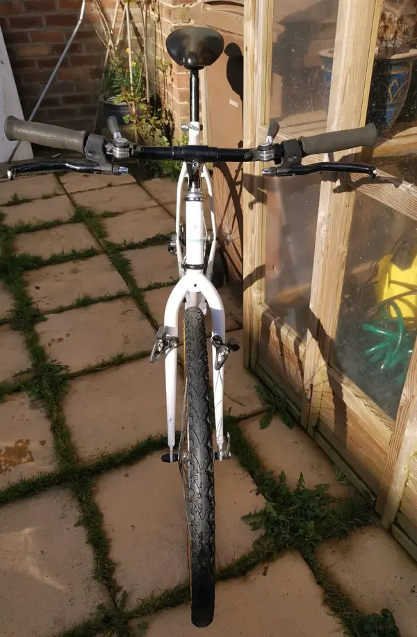

Stuck some parts on the Blizzard which i've had lying around, still not sure on the Mountain LX mechs but it would mean you could upgrade to 7 speed in the future because there's plenty room at the rear for a 130 rear hub and the 6 speed Deore shifters have a ghost 7th click.
Brake levers are M732 Deore XT with a Deore front cantilever and a Exage Mountain U-Brake. Shifters are Deore MT60 with Mountain LX mechs.
