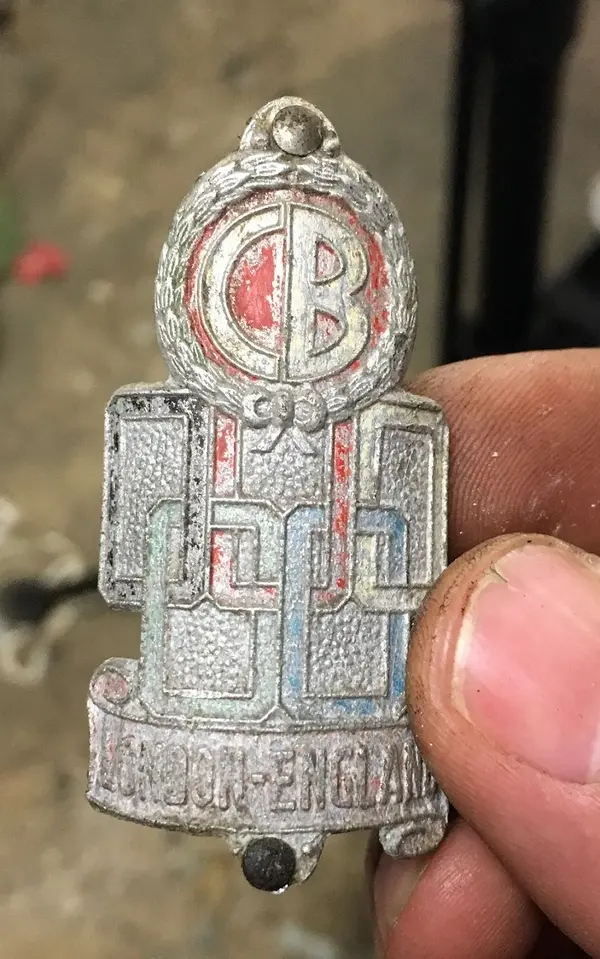

Here’s something I meant to mention, the headbadge from this massed start was aluminium, not pressed tin.
I’ve not come across this type before and I also noticed the colour configuration is the same as the first type of printed flat metal badge from early 1949 with the yellow top right. (subsequent CB badges had the yellow ring bottom left, then the post 1958 Holdsworth badges had the yellow top left).
I’ll be re-painting this after I’ve added this photo to Velobase just for the records.
