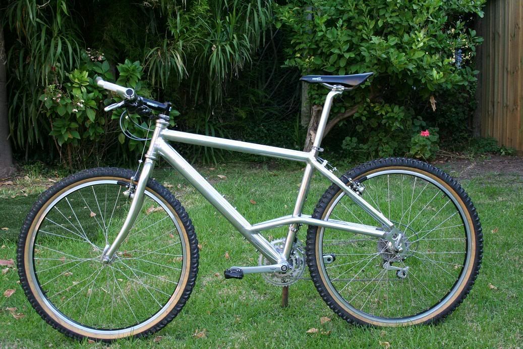

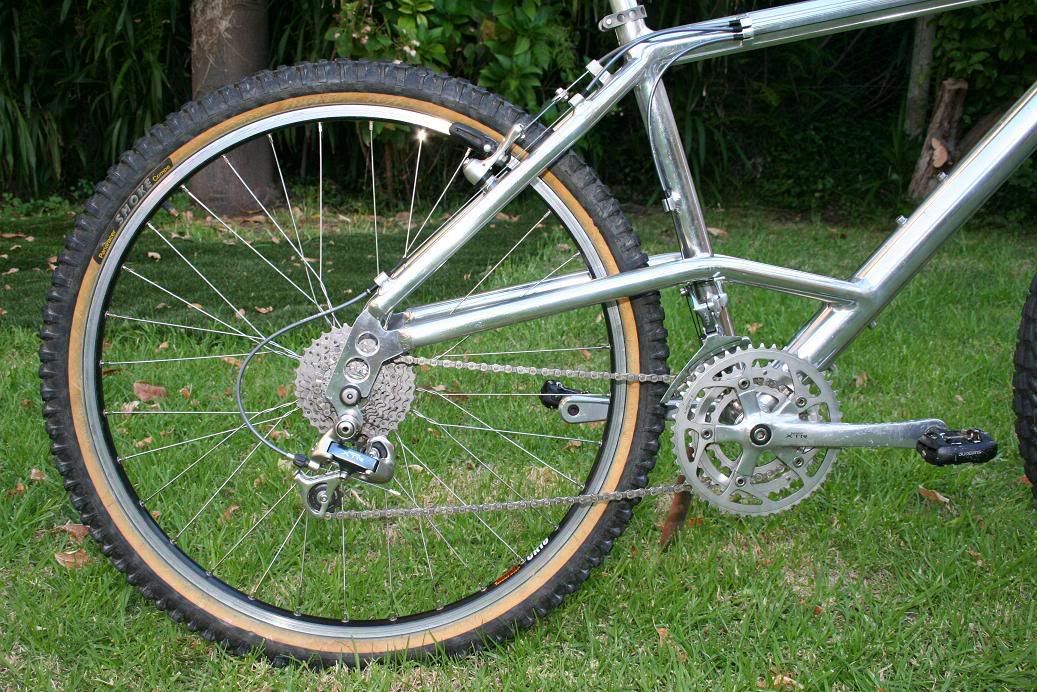

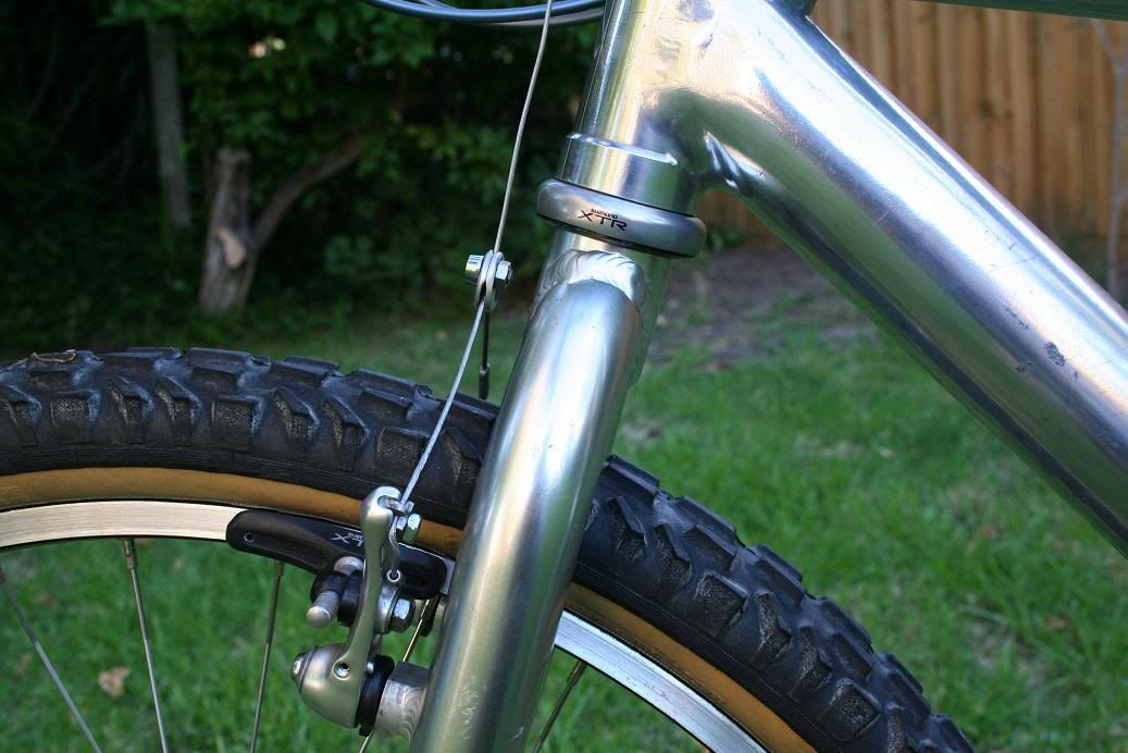

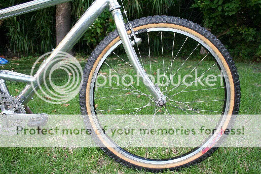

Frame: '92(ish) Funk Pro Comp, 18" polished Easton Vari-light alloy.
Fork: Cronos Alloy with cr-mo 1 1/4" threaded steerer
Headset: M902 XTR 1 1/4" (NOS)
Stem: Controltech 1 1/4" quilled. 120mm, 0 degree (NOS)
Handlebar: Answer Hyperlite, silver (NOS)
Grips: Rubber
Barends: Controltech Team Issue L-bend, silver
Brakes: M900 XTR
Brake Pads: M900 XTR
Brake Cables: Shimano Dura-Ace
Cantilever cable hangers: M900 XTR
Brake Levers: M900 STI
Shifters: M900 STI
Front Derailleur: M900 31.8 down-pull
Rear Derailleur: M900
Derailleur Cables: Shimano Dura-Ace
Cassette: M900 12-32
Chain: Shimano 8-speed Dura-Ace
Cranks: M900 XTR 175mm
Crank Bolts: M900 XTR
Chainrings: M900 XTR 26, 36, 46
Chainring bolts: M900 XTR
Bottom Bracket: UN-90 68/107
Pedals: Shimano M737
Hub Skewers: M900 XTR
Rims: Sun CR-18, 32h
Hubs: M900 XTR, 32h
Nipples: DT Brass
Spokes: DT Competition 20./1.8/2.0 (laced in 3-cross snowflake configuration)
Tyres: Panaracer Smoke Compe kevlar 2.1 (rear) & Dart Compe kevlar 2.0 (front)
Tubes: Panaracer schreader
Saddle: Vetta SL, leather cover, manganese rails
Seatpost: Nitto 65 26.8mm (NOS)
Seatpost Binder: Ringle' seat collar with Ti bolt
Weight:24.6lb
That is cooooool, loving that a lot :cool: :cool: :cool:
Funk's are my fave e-stay ever, fantastic condition, and a quality set of components..nice!

very nice- except for the snowflakes of course :)

That looks fantastic, really nice clean lines. Well done that man on a restoration well done, i'm sure it will be a pleasure to ride.
