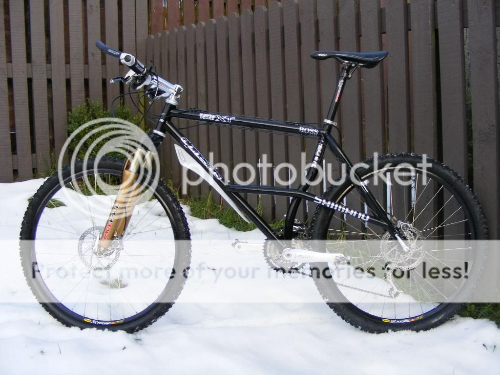

Project No. 6: alpinestars Cro-Mega SS
My aim is to build a unique single speed for use in next years UKSS championships. I’ve been watching from a far as people have pioneered this single speed mountain biking revolution, now the time has come to join in the fun and compete in this excellent championship series run by our very own Gil_m.
I’m looking for this single speed build to be several things:-
- Fully rigid (my preferred kind of riding at the moment)
- Low rolling resistance (to save as much energy on the slogs as possible)
- Brake consistently (so as not to scrub off too much of my hard earned momentum)
- Climb adequately (perhaps the undoing of many a SS bike)
- Valve for money (I’m looking for a lot of smiles per pound from this build)
- Ultimately have the character and charm of a retro steed.
To achieve this I’ll be mixing the old with the new, a situation I’m fairly familiar with after successfully completing my first Retrobike project, a 1992 meets 2008 alpinestars cro-mega XT, a ‘hotrod‘ if you will.
So for this project I taken a backwards step and tracked down my old alpinestars frame from the project above, almost exactly a year after the original build was completed. As an EOS (Elevated Oversize System) alpinestars it oozes the old school character and charm that I’m looking for. But better than that it’s already converted to accept a rear disc brake and the frame was designed purposely to climb well with it’s super short wheelbase. So by adding rigid forks, some low rolling resistance mtb tyres and keeping cost to a minimum, all my wants should be satisfied.

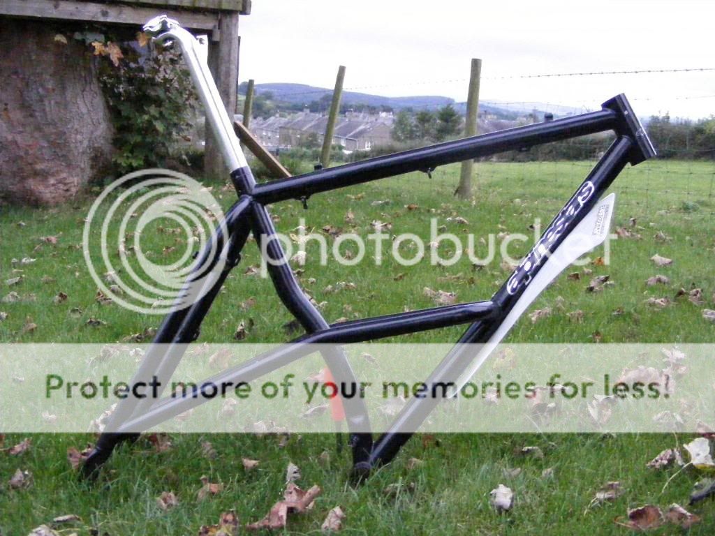

Frame:
To refresh your memories, the frame is a 19” 1992 alpinestars cro-mega. It’s been modified with a rear disc mount, an E type front mech, crud catcher mounts and has had it’s cable mounts rearranged to suit the hydraulic cabling and top pull mech. Thus, I’m not worried in the slightest about chopping and changing the frame further. When built as in the picture above the bike had a very fine margin for getting it set up correctly due to all it‘s modifications, this is the reason why ultimately I broke the bike up and moved on, when it was right the bike rode absolutely fantastic but when it was misbehaving it was a frustrating beast, rather like owning an Alfa Romeo I believe. Fortunately I gave the frame away for karma to friend and fellow Retrobike member Kingcutter, he built up the frame to his own tastes before dismantling it many months ago. The frame has since laid dormant in his workshop, until he kindly allowed me to have it back for an equal dose of karma.
My plans for the frame are fairly simple. I’m going to de-boss the frame as much as possible. With no need for any gear cables or front mech hangers, these might as well be removed to give clean lines. The frame is currently painted in 2 pack black, this will be removed and a rattle can paint job applied. I was considering an all singing and dancing professional paint job, but I want to keep the costs down and want this to be a hands on project as much as possible. The paint job I’m hoping to achieve is based on the 1991 alpinestars design, despite this being a 1992 frame. This is for 2 reasons, firstly the 91’ design is my favourite and secondly Gil_m has the 1991 graphics loosely on file but no 92’ graphics. As I own a 1991 cro-mega DX I’ll be copying the detailing of the paint job as best as possible from that. The colour scheme is totally undecided at this time, but it's likely to bright as it is an alpinestars after all.

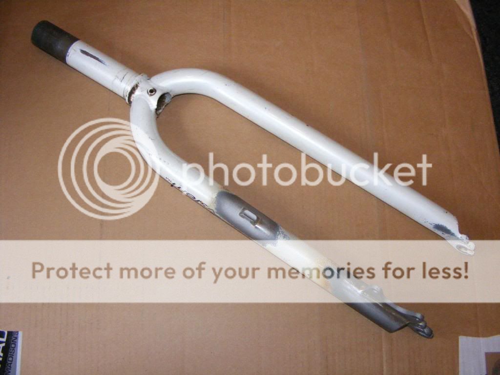

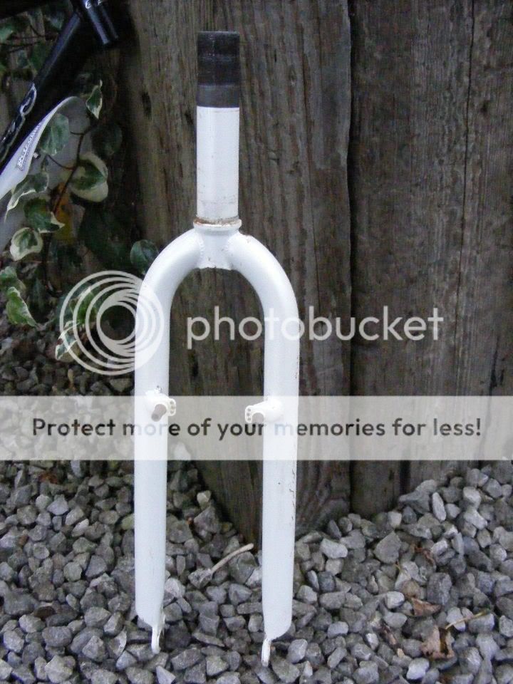

Forks:
I have had a set of 1992 alpinestars rigid forks lying around for a while. They are 1 ¼” threaded and currently have mounts for cantilevers only. The plan with these is to have an I.S. (International Standard) disc mount fabricated on to them and the canti mounts removed. I’m going to entrust the job of fitting the disc mount to a professional bike builder, this should ensure correct alignment and a proper job.

If your fork is curved a disc mount is probably a bad idea. Even if it is straight you may have problems.
I know Bob Jackson wont weld a disc mount on curved forks...

Frame

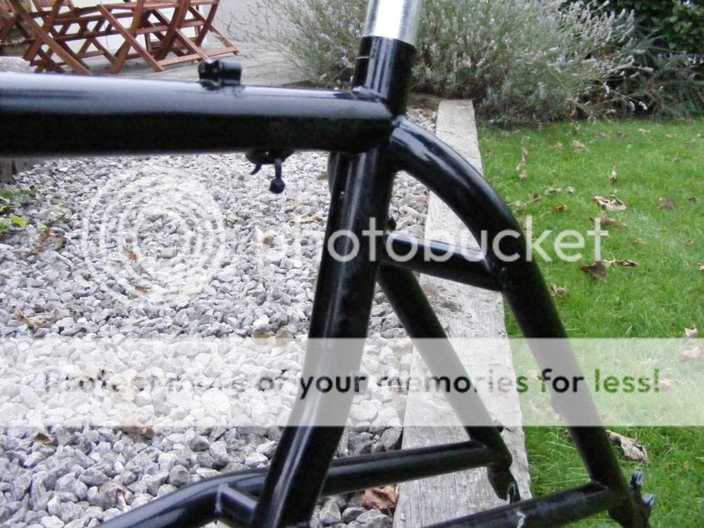

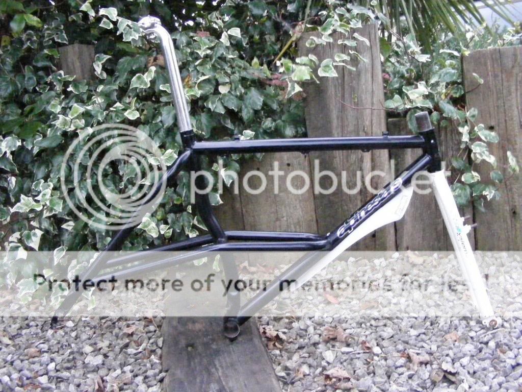

So the frame is back with me and I’m delighted it’s back. After all the stresses and strains it took to build last year, it has a special sentimental value to me. Thanks once more to Kingcutter for allowing me to have it back.

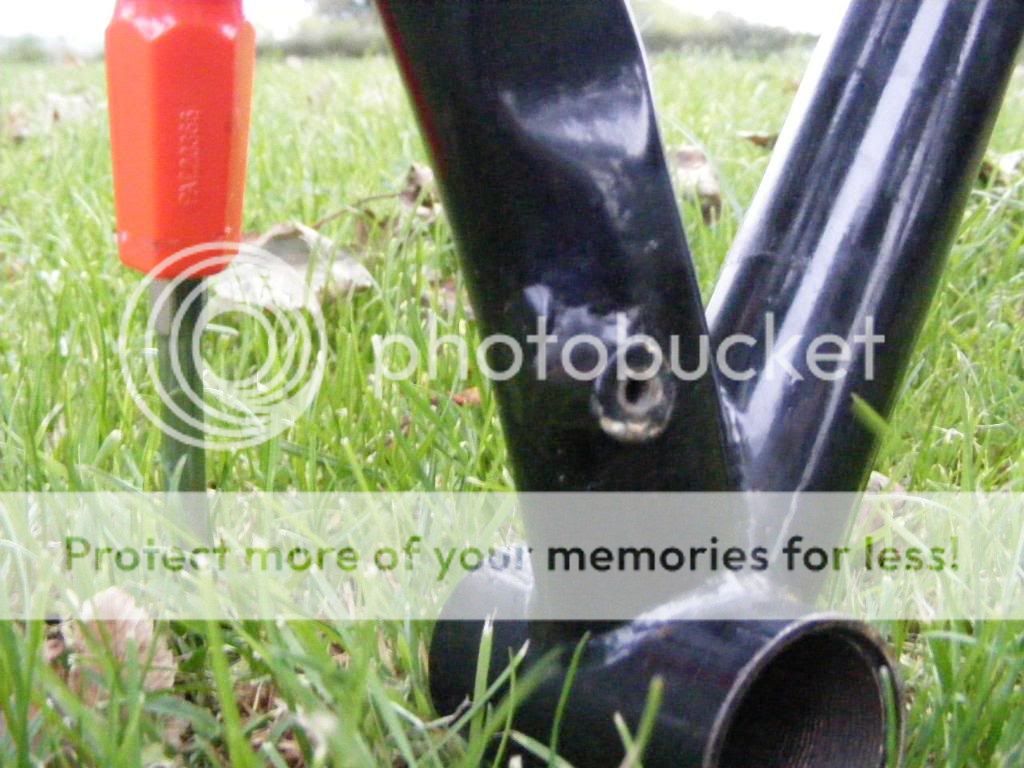

Metalwork
So after much thought I’m slowly concocting a plan of where to go with it. I really looking to show off the design of this frame as best as possible, thus I going to go as simplistic as possible by removing all unwanted features. These include cable bosses, traditional mudguard mounts, e-stay mounts and most radically the rear mech hanger (I did say I wouldn't be shy in chopping it). The rest of frame will be smoothed by filing down the rougher welds and using filler on areas of pitting and denting (including the dent in the seat tube for the e-type front mech to sit).
Rough welds to be filed down and smoothed around the rear disc tabs:
Cable bosses for gearing to be removed:
E-type mech boss to be removed and dent for mech to be filled and smoothed.
Factory welds to be filled down lightly to smooth the finish:

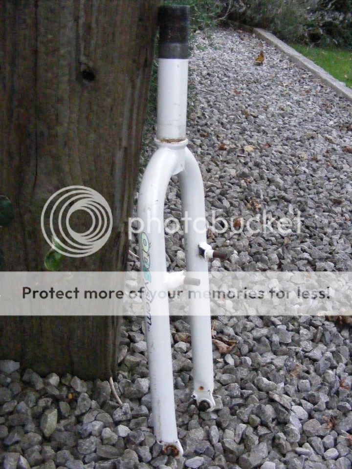

Forks

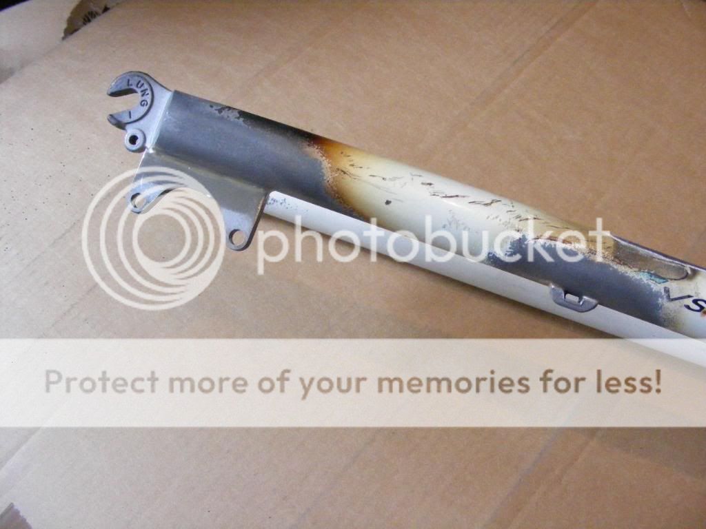

The forks are the original 1992 cro-mega LX forks. They are tiny bit less oversize than those used on the other 1992 e-stay models but equally nice looking. They are a 1 ¼” threaded steerer with totally straight blades, thus I’m very hopeful that a bike builder will undertake the job of adding International Standard disc mounts to them. The canti mounts will then be removed to give clean lines.

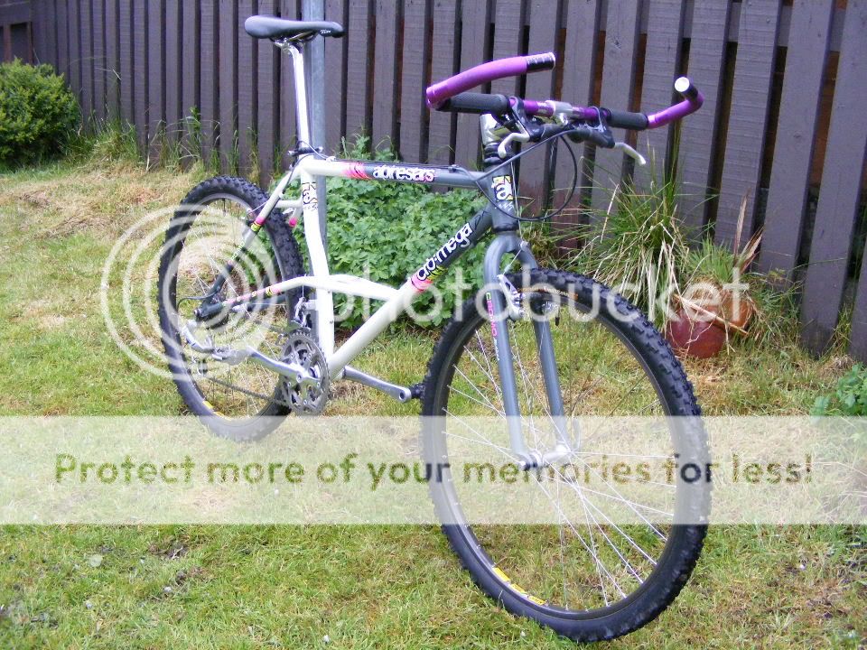

Unless a set of 1992 graphics surface in the meantime, the paintwork will be in the colour scheme of the 1991 bikes. The colours will be those of the year which were black, bright yellow, bright pink and alpine white, I’ve no idea what order they’ll appear in yet but the middle section will certainly be white.
My 1991 cro-mega DX demonstrates the 91’ colour scheme:

Forks
Sent the forks off to Bob Jacksons Cycles in Leeds for disc tab, cable guide and the canti bosses removing, much to my surprise and 4 days later they're back.
I choose not have them painted as I want the paint to match the frame when I respray it all. This means I get no warranty for the work carried out but these forks are 17 years old anyhow. As a temporary measure i'm spraying the forks black to match the frame.

Fork looks great. That's a super tidy job they did. Really like how this is shaping up, can't wait to see the finished build pictures.

Forks cost £65, which includes next day delivery. Which is quite a lot but the quality appears to be first rate. To have them painted at Bob Jacksons is an additional £30.
As for retrospectively fitting disc mounts to old forks I don't see any issues with it tbh. Old school steel forks, especially these alpinestars ones are extremely robust. When you consider the forces running through the crown and upper legs when running good canti/v-brakes or Maguras I'd consider discs to probably be more friendly to them.
I'm looking forward to building this now. Should be interesting to try this singlespeed stuff. Going with 32/18 gearing to start with and then go from there.
PostPosted: Thu Oct 15, 2009 8:40 am
Joined: Thu May 08, 2008 3:18 pm
Posts: 2218
It's entirely different loads, though. Plenty of old fork legs are thick at the top, as far as the bosses, and then get thinner. I'm not saying that it's guaranteed not to work, just that I'd keep an eye on it.
Certainly a tidy job, look forward to seeing the finished bike 8)
