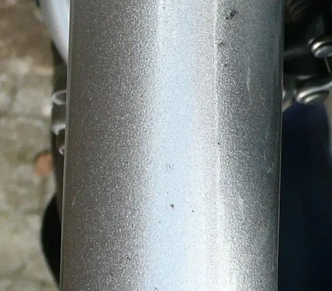

I then had a go at cleaning the frame up. Firstly gentle and with some soapy water, then something a bit stronger. I also tested some of the worst bits of the frame with some light-sanding but it wasn't coming up that well. So having sorted the vital bits (bb and headset) and established that the project was worth doing.. I started to look around for resprays. I have always liked oranges ever since i had a clockwork around 89/90 and it was very tempting to try and make it look good. In the end I decided to hang the expense and it get it blasted and painted properly by argos in Bristol. I went for a metaliic silvery colour that, whilst not original, had an early 90s look about it and also looked like it was something orange might have used. Some more recent silver finishes on orange bikes also convinced me of this. So around Christmas time I posted the frame forks, headset and BB off to argos and waited patiently.
