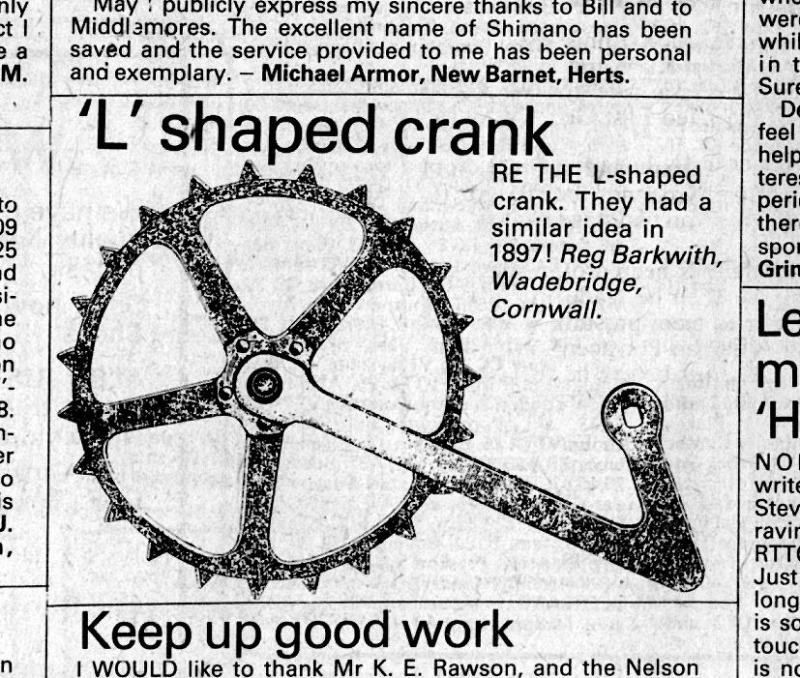

As usual, there's nothing new, how to ride long cranks without having long legs:

If you look at the crank with the pedal at the 12 o'clock position, it looks like if you push the pedal straight down you can still turn the crank, but of course you can't. So it's a bit like an optical illusion.
