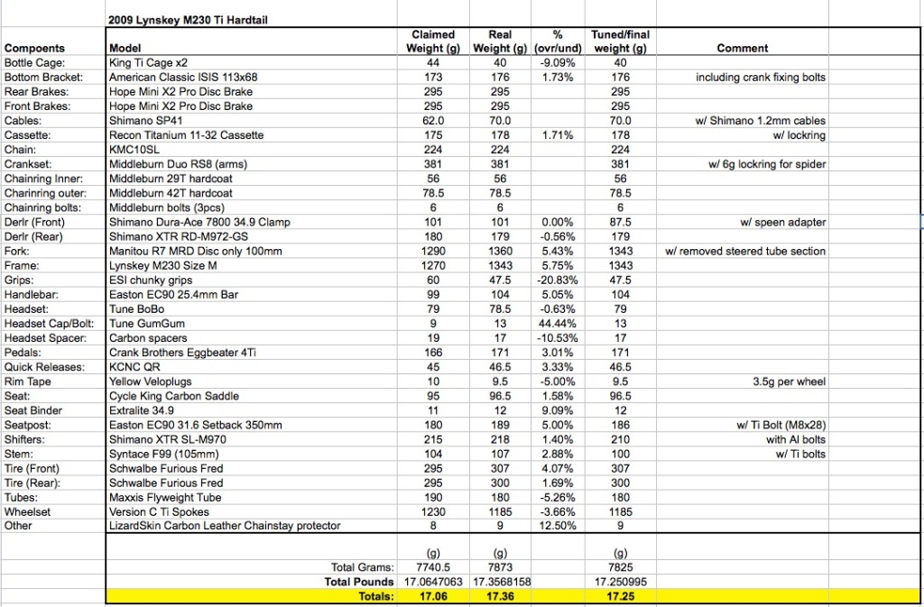

The idea behind the parts selection was, Light as possible without going stupid. I can not come to terms of buying thm clavicula cranksets, or Ax lightness saddles and posts, nor could I ever justify a schmolke handlebar. So I picked what I felt was the best parts that mainstream manufacturers today have to offer. The Hope brakes pay homage to the days of CNC'd bling parts. The Easton carbon EC90 seatpost and handlebar reflect that they were one of the first companies to offer carbon fibre parts to the bicycling industry and I always wanted one. The wheels are just simply amazing, originally it was just going to be Notubes ZTR Race. After talking with Jeremy Parfitt I was again convinced to go full custom like I have done on all my other bikes.
I'm not going to re-summarize the discussion on each and every part. I do thank everyone who has contributed their 2 cents on the pros and cons of each part I have asked about:

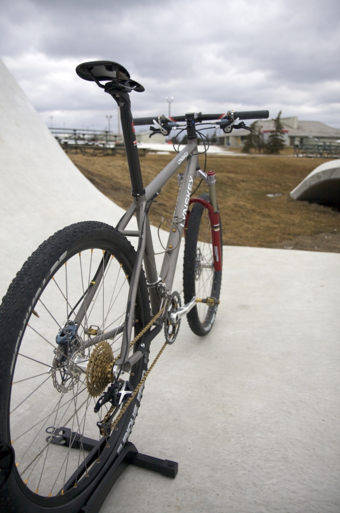

So here are some pictures...

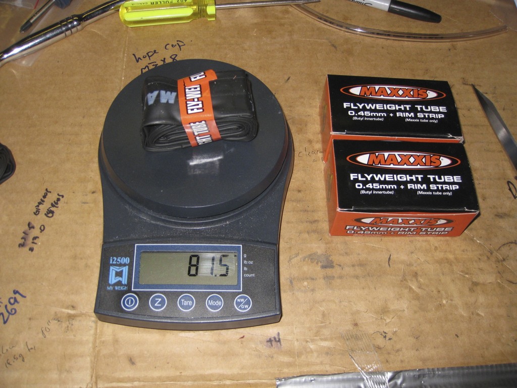

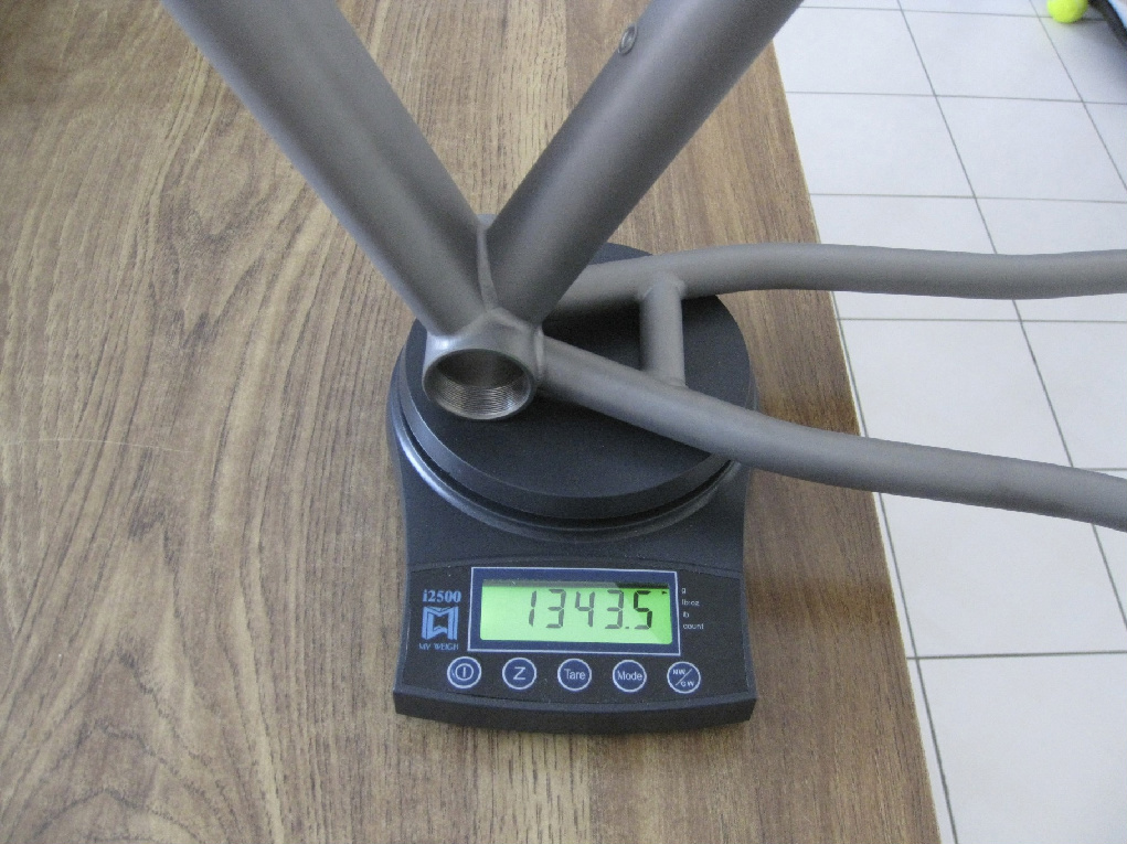

Frame weight
Breezer Dropouts

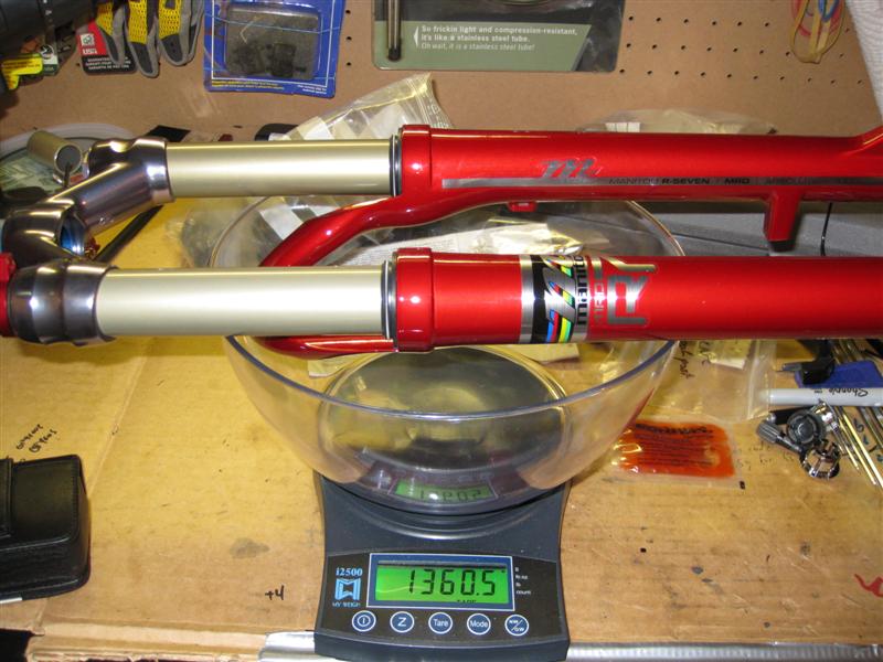

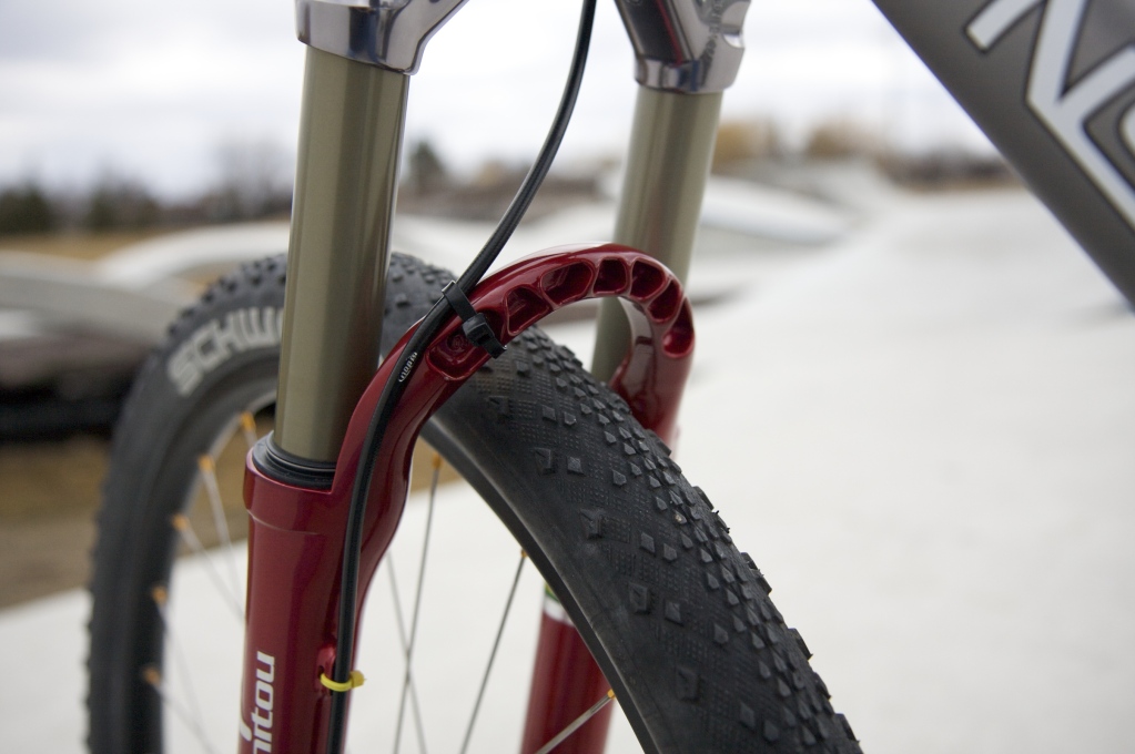

100mm Manitou MRD R7 Absolute

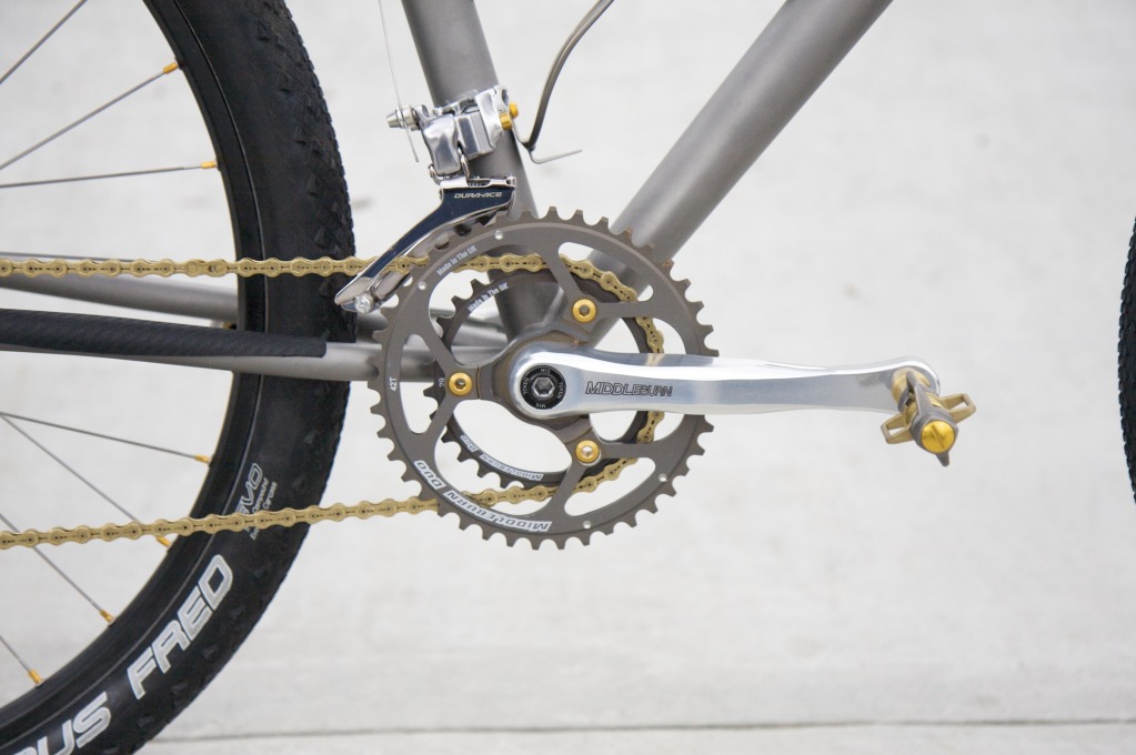

Middleburn RS8 ISIS DUO 29T/42T

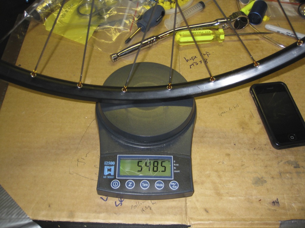

Front wheel
Rear Wheel

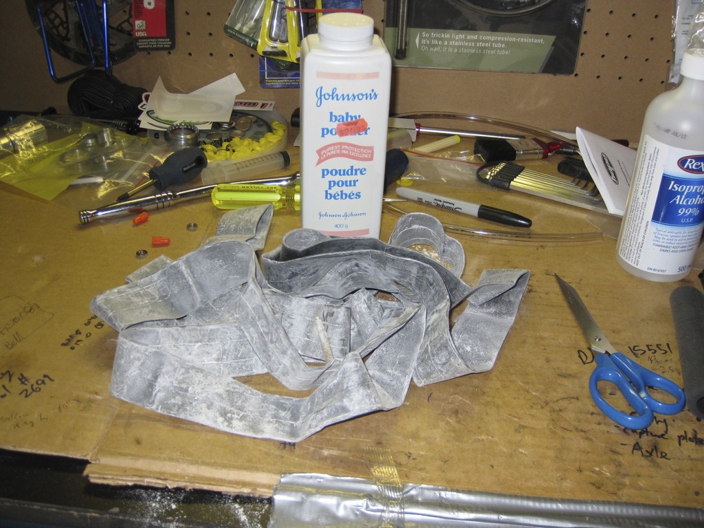

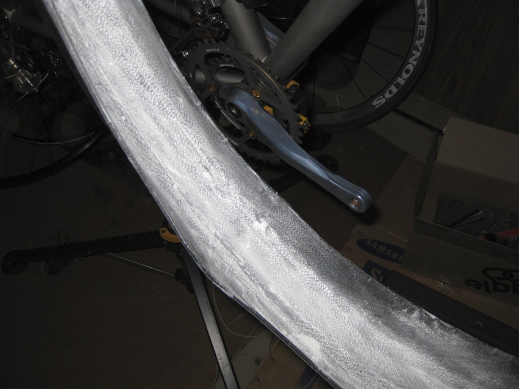

Talc'n the tubes and inner tire (helps a bit for pinch flats, plus your bike smells nice afterwards)

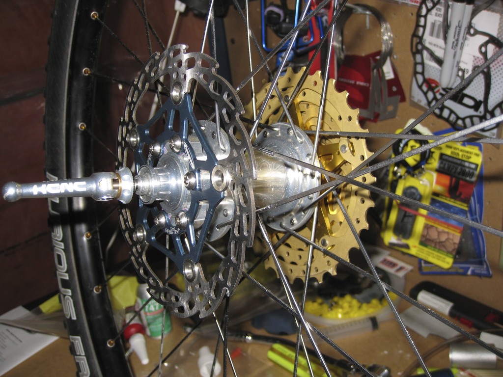

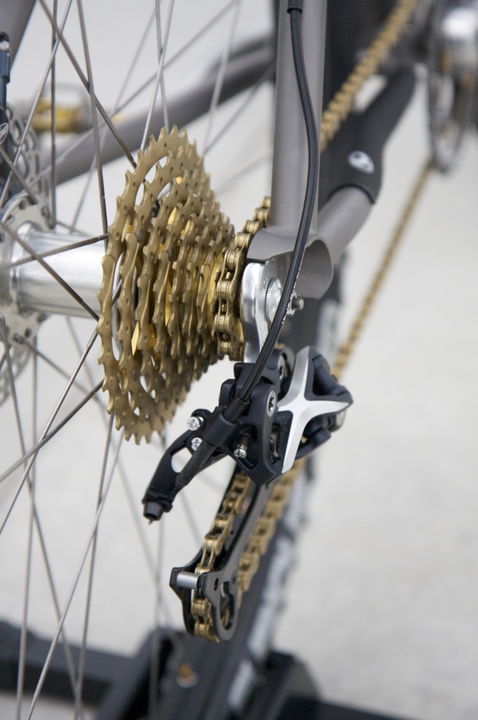

The golden bling Ti cassette

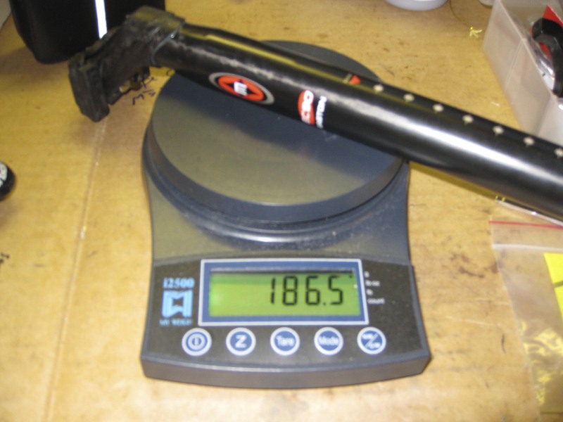

Easton EC90 setback seatpost 31.6mm w/ Titanium bolt
Cycle King carbon saddle
Anything that didn't get copper antiseize got threadlocking compound. No threads were left bare.

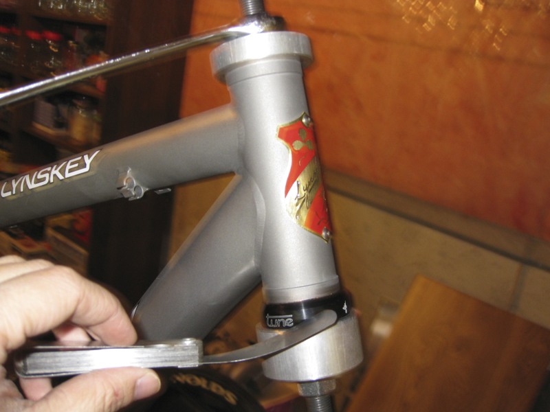

checking to see if there is still a gap... .0015 feeler gauge

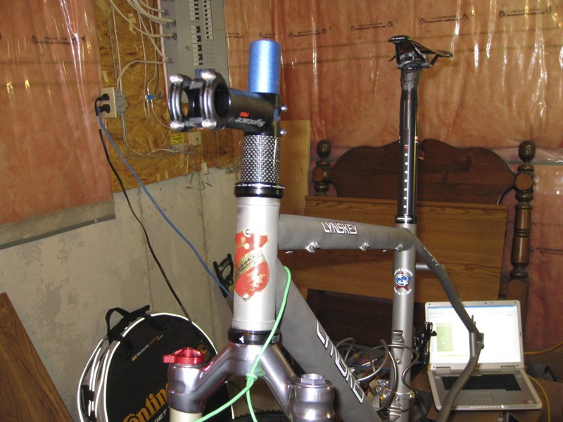

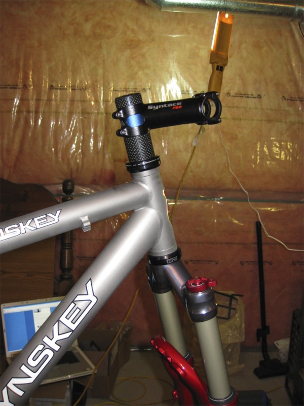

fork sizing

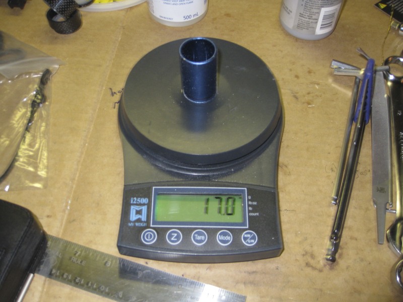

weight of remaining steerer tube
fork, stem, headset, spacers, cap installed

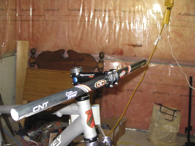

104g EC90 bar installed. If you have been following this forum you will know the story.
tuned w/ anodized aluminum gold bolts
Rear wheel put together
The bike being weighed
The final built weight

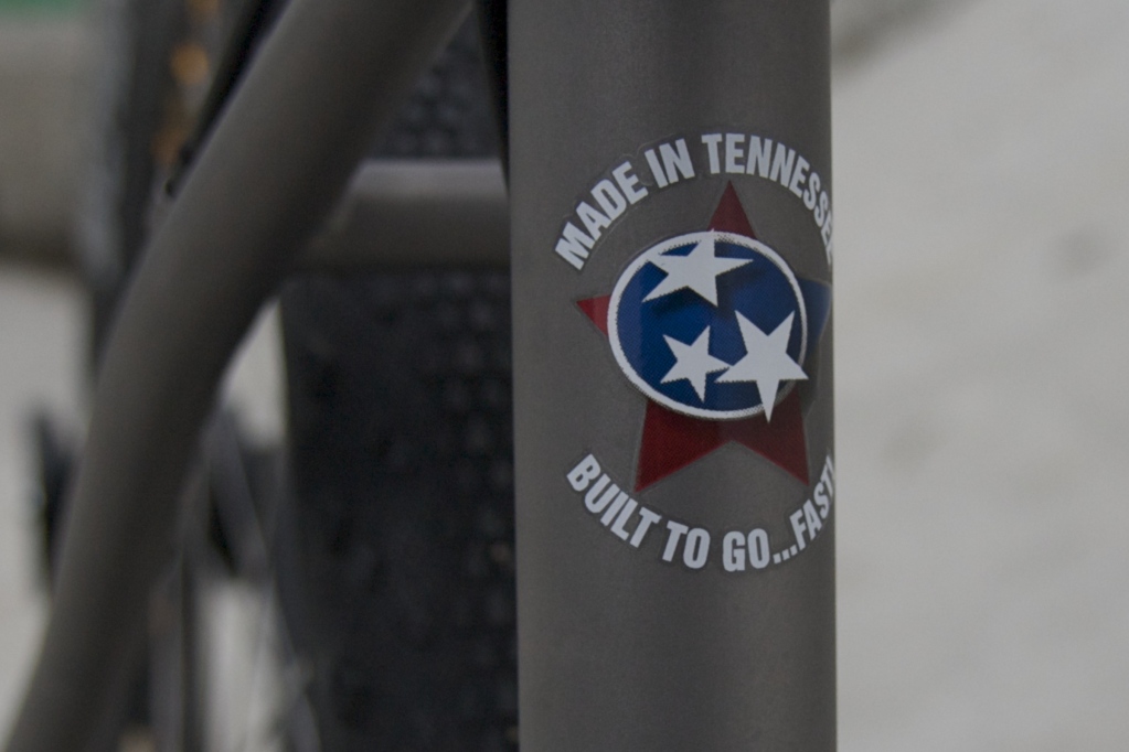

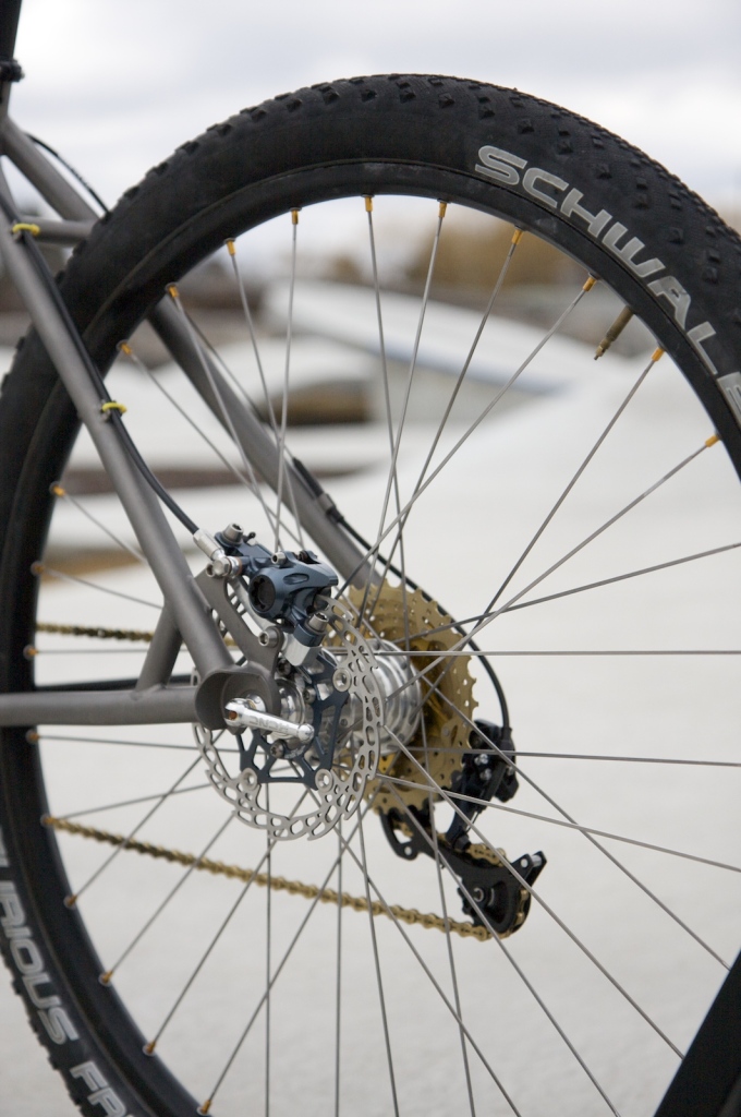

Those are my poorly taken pictures. Now for some beauties that my friend Bill took for me to use to submit to the http://www.light-bikes.de/eng/2009/02/06/bike-of-the-year-contest-2009/ contest.
The bike has been assembled following all the NASA standards, processes and practices for mechanical integration of space flight hardware for manned and un-manned flight that I have learned over the 4+ years as an Aerospace Manufacturing Engineer. Comments and criticisms are welcomed.
