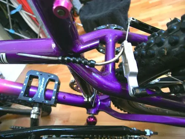

here's a pic of my little bodge - it costs nothing and works pretty much perfectly tho. i'm sure with a bit of thinking it could be done neater (the andgle of the straddle cable could be improved maybe) and my small frame makes things a little cramped as well! its not super-mega pretty, but neater than some, no drilling of the frame etc, and as this bike gets ridden a lot, v-brakes are a necessity for me. im not sure how this would feel with an xtr parralelgram jobbie as they always seem to feel a bit spongier, but the pauls feels great and very solid.
hth! BC

Carsten":1v8kw3yk said:
the nicest and most advanced solution i have seen so far is this one
May look nice, but sooner or later that cable will cut through the canti bridge. (Unless there's a hidden steel guide in the bridge) :wink:
to me it looks like there's a liner over the cable up to where it leaves the bridge. in addition to the thicker liner.
