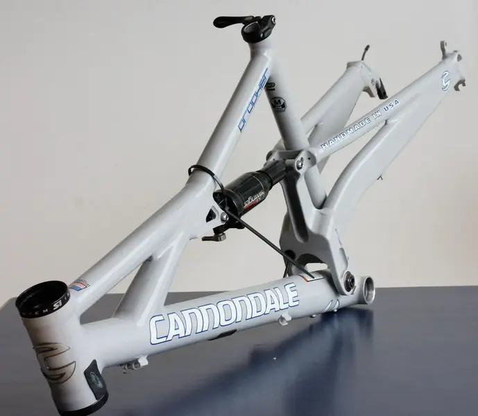

I saw this Prophet on Ebay couple months ago. Basically NOS. Good price.
Its simple. it has enough travel. it doesnt have any ugly graphics. Still quite retro to be honest :)
What i hate on modern AM bikes is the weight! So i want to do it reasonably light.

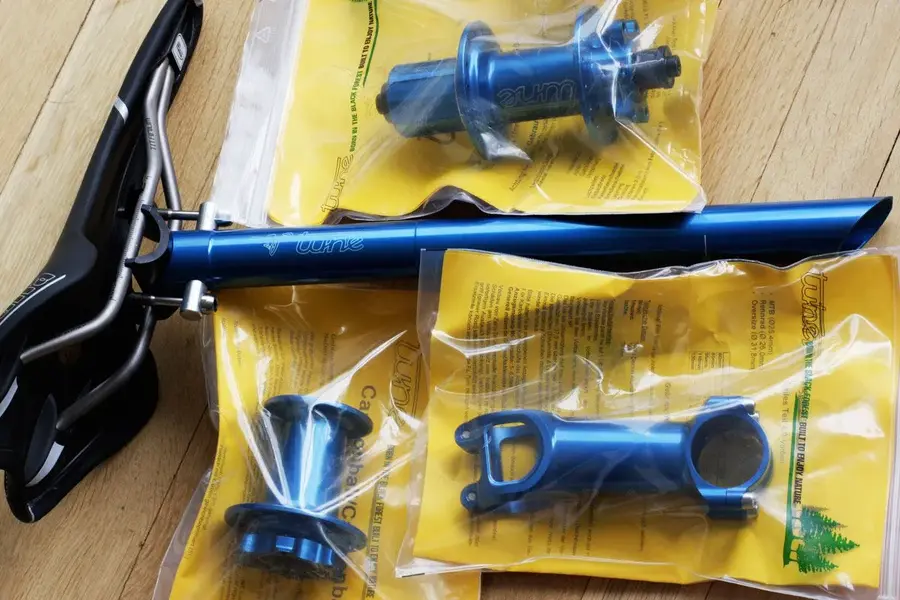

For parts, I got inspired by those blue outlines... :roll:
Bit of carbon goes well with grey frame imo :)

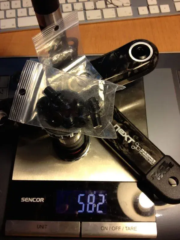

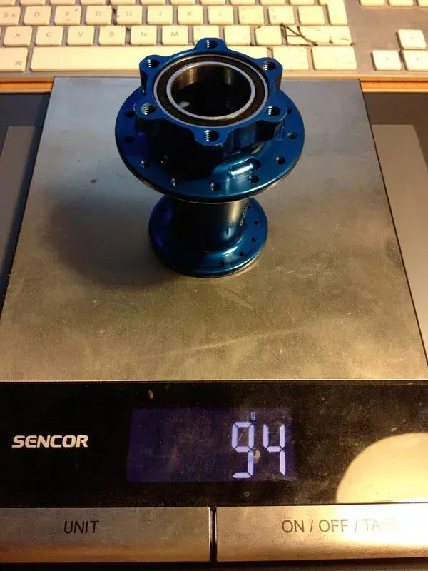

some weights. The rear hub is very impresive. Also Next cranks r very light (unlike some other carbon cranks) I was very surprised when i red that these are cactually made in Canada!

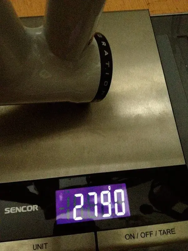

Frame: 2770

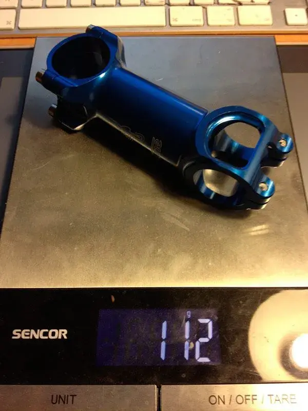

Stem: 110

Cranks: 582

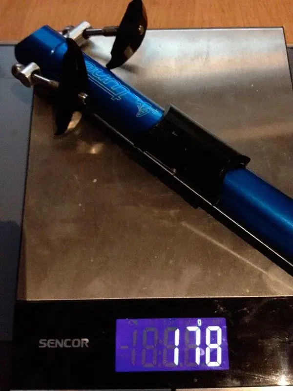

Seatpost: 180
