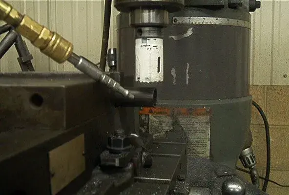

Hey guys,

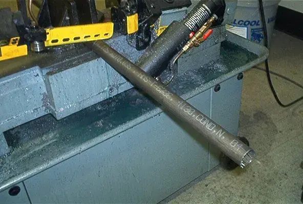

From the interest I've received through email I thought everyone would enjoy a quick pictorial trip to describe how Alan's (Ti fat man) fork came to be. I did not take a lot of pics, but have a few so Alan could follow the progress.
First step was sourcing original materials. The Campy forged dropouts were cast in an Italian factory that ceased production two years ago. The availability of these has become rare as milk from boar's tits. Luckily, I was able to pry two pair out of a fellow framebuilder :D .
I chose to go with slightly heavier wall tubing than the original BOI to stiffen the fork up laterally as I always thought it was a bit flexy. The steerer tube and crown ring were original equipment from a west coast supplier (promised not to name names 8) ).

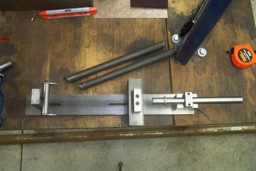

I built a custom fork fixture for the geometry of the segmented fork, adjustable for different lengths and rake to accomodate pre-suspension and suspension corrected lengths.

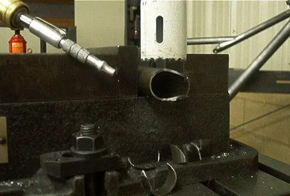

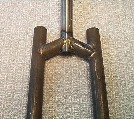

The most difficult aspect of the fabrication is the compound miter that joins the steerer tube and the legs, requiring precise machining on a very small piece. Had to make another jig to hold this crown piece in the mill to make the cut.
The teardrop tabs were hand cut and silver brazed on...a requirement for the original tubing but mere historical accurate detailing on these.
Final clean up and paint finish it off.

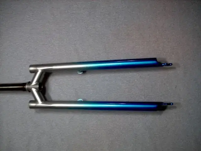

I ended up building two forks; Alan's Big One Inch and a Yo Eddy for my project.

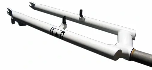

In answer to the questions...
Are the legs formed somehow? Or am I looking at the crown tubes? Do you do that yourself?
Gump...everything is handmade. The pics of the mitering is showing the offset cut made to form the scallop miter in the dropout. The cut is made, dropout inserted and tacked to the flat/remaining portion of the tube, a scallop cut piece of tubing is then inserted to match the inside radius and everything is then welded/silver soldered together to form the finished dropout.
How long did it take to build them and would subsequent forks be quicker to build?
Any plans on making more?
Steve...the original forks took a loooong time as I had to create a new fixture and work out the kinks to get the process down. A finished fork would now take me about 10 hours with paint to build one at a time.
As for making more, this was a personal project for my Yo, as I wanted to build my own rather than search for a used fork. I offered one to Ti Fat Man as I was touched by his lament of selling the original and having trouble sourcing another NOS. Morally, I would not want to profit from another's design and success (Chris Chance). As discussed numerous times on Fat Cogs, I don't know what the legal restraints would be as trademarks and patents are suspect to be expired. Would I build another for a bleeding heart desperate to complete a project....perhaps.
