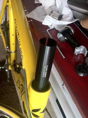

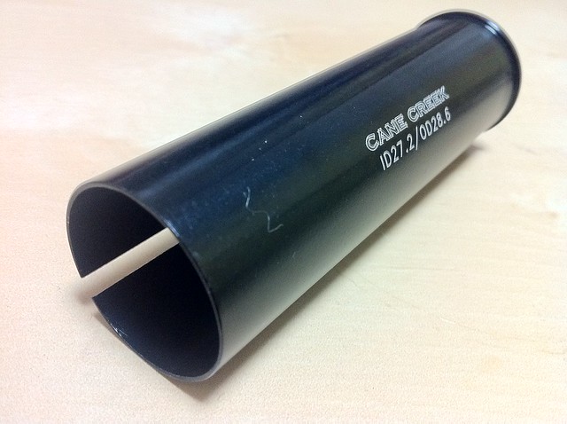

So I did some calculations and figured I need to go from 1 1/16" = 26.9875mm to 1 1/8" = 28.575mm.
A difference of 1.5875mm so the shim will need to be 0.79375mm or 0.8mm.
I found this Cane Creek seat post shim that goes from 27.2 to 28.6mm, which is a diameter change of 1.4mm or 0.7mm shim thickness. As it is so close to the correct dimensions, it should slip on snugly and mate the 1 1/8th inch stem nicely to the Klein steerer. Hopefully the 0.1mm will be fine when the stem is tightened. I am planning to trim it down to size as it is surely too long.

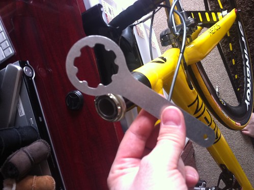

I have nearly everything I need for this little project accept for one vital thing. The MC2 tool. Luckily, one is flying to Tokyo from New York at this very moment. I posted on the Klein owners group in Facebook and someone is being kind enough to lend it to me. Shipping came to $5.60!!!

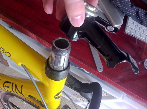

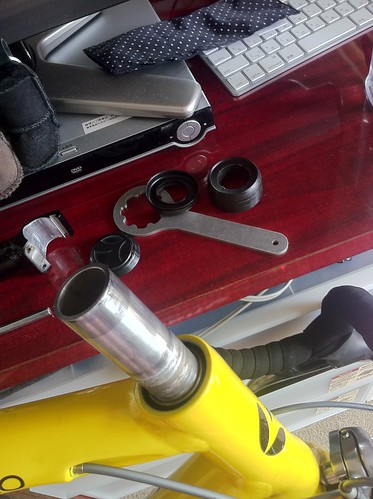

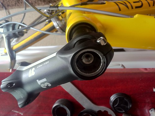

So the tool arrived in the post! Thanks Mark from New York for lending it to me!
Step 1, Remove the MC2 stem.
This was pretty easy, put tool on and turn anti-clockwise. The silver top part spins, but is connected to the stem itself.
When the stem is taken off, the collet will still be on the steerer tube, it was greasy, so I used a tissue when pulling it off.
Now the Klein Spacers can be removed. Exposing the entire tube.
Step 2, Make the shim.

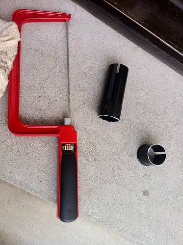

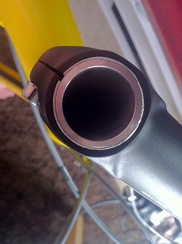

Again, a simple task, I put the shim over the steerer and used some tape to mark where i want to cut.
I then used a crappy hack saw and got a surprisingly straight cut. I then filed the bur off and removed any imperfections with the file also.
Pretty nice fit.

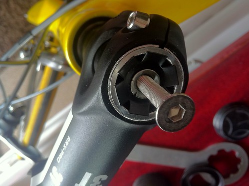

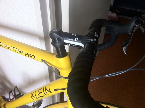

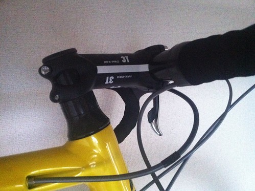

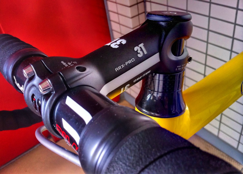

Step 3, Put the shim and new stem on.
Yawn... This is too easy, but the juicy fun part. As the Klein doesn't use a top cap to put pressure on the head set bearings, I can put the stem where I want on the stem and not use any spacers (but I will get some later).
Shim could do with 0.2mm more thickness I think, but it's on very solid, so I guess it is within tolerance.

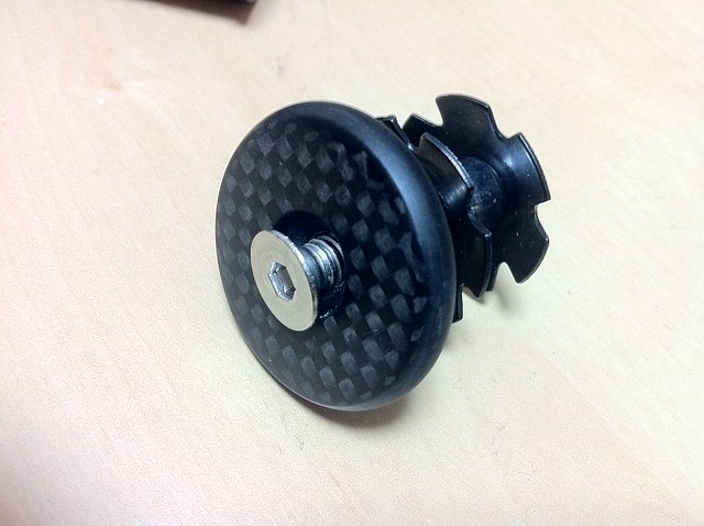

Step 4, Prehensile Top cap install.
This is really just to stop water getting into the steerer and look nice. I was thinking of an expander plug, but star nuts are so cheap. I got 1 inch and 1 1/8th inch star nuts and checked which works better. The 1 inch one looks the best fit, so pop it in and hammer away!
I then measured the amount of empty un-spacered steerer and bought some carbon 1 1/8th spacers to fit, with a flared one at the bottom.

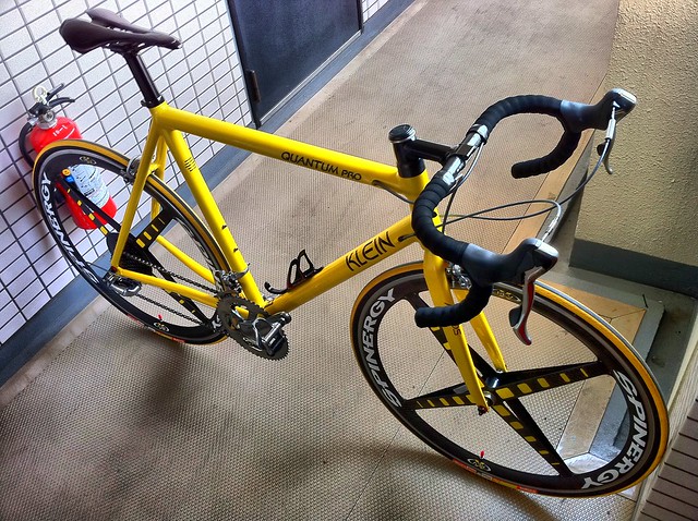

Yeah, the right side is an in-line gear indicator. The left side is a barrel adjuster for fine tuning the front derailer.
Here are some nice photos I took to celebrate a job well done after today's post rapture ride this morning.

I decided to see if I could do something about the 0.2mm shim difference as the spacers had a slight bit of wiggle room.
I cut an aluminum can to make an extra single layer shim. It is now a perfect fit.
It is very tight and I think the double layer shim will hold solid.
