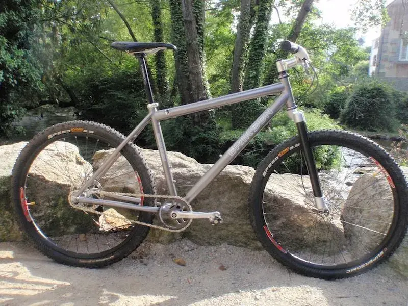

bought the frame here, so i thought i should share the build, even though it's still not finalized...
Frame: Eriksen #64 (2006)
Bushnell EBB
Fork: On-One
Headset: Chris King
Stem: Thomson
Handlebar: Ritchey WCS
Grips: WTB
Brakes: Magura Marta
Crankset & chainring: Middleburn
Chain: Wipperman
Pedals: Ritchey Paradigm
Hubs: Hope Pro II SS
Rims: Salsa Delgado Race
Tyres: Conti Speed King Supersonic
Saddle: Italia SLr Gel flow
Seatpost: Thomson
Seatpost Binder: Salsa
as per the updates, i will swap the tires for a set of conti Race King's for the summer
-i still have to decide between a Ti or a carbon seatpost
-i was considering a Use Atom handlebar
-and a Charge Knife saddle
opinions?

is't the frame designed for a longer forks? something like 100-120mm?
PostPosted: Sun May 15, 2011 9:43 pm
Joined: Sun Oct 11, 2009 11:01 pm
Posts: 583
Location: France
Quote:
"Here is what Kent has down
in his notes for that frame:
-designed for 100mm RockShox Reba
-Single Speed EBB
-12.3" BB Height
-70.8 degree headtube angle
-73.6 degree seattube angle
-rider was 180lbs. And 5'9" tall"

i think its the EBB thats making the box looking really low - because you have tightened the chain "down" .
I was just first thing assuming that the forks was too short

SpearedHot wrote:
Any ride report? :D
it's a joy to ride! :)
so far i've been using it for short, intense rides and it shined.
front triangle is stiff! thanks to beefy down tube
rear triangle is compliant
i climbed hills i didn't think possible in 36 X 18
too bad i'm not enough in shape yet (i'v had little health issues)
opinions?
I don't think theres a lot wrong with the current bar and seatpost but I think a carbon seatpost would look cool with the forks and balance the overall look of the bike
PostPosted: Fri May 20, 2011 8:01 am
Posts: 583
Location: France
turns out i decided to go Ti for both the post and the bars!
i ordered the post yesterday...
