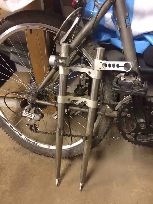

Just starting to rebuild my Torus FS and the information is invaluable.
I'm ok with bikes but I'm no expert so to see the specs and the history is really helping out
Here it is btw
