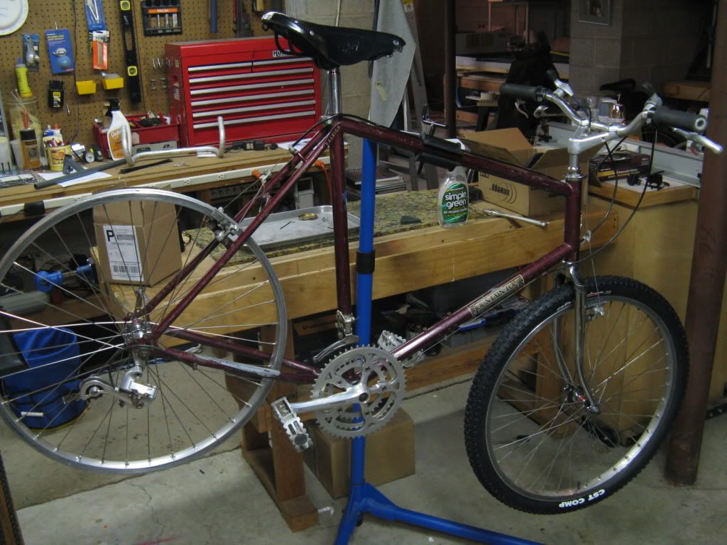

Picked this bike up a while ago, and haven't had much time to work on it. It's almost done, I just need to finish tensioning-truing the rear wheel. I have no clue what year it is, the serial is M5-F0898, if that means anything to anyone. I think it may be a Canadian model. Anyway, here're some pics.
It's just Raleigh 502MT tubing, which I assume to be some sort of heavy cromo. I dug the stem, brake levers, and shifters so I bought it. The most expensive thing so far was all the new spokes.

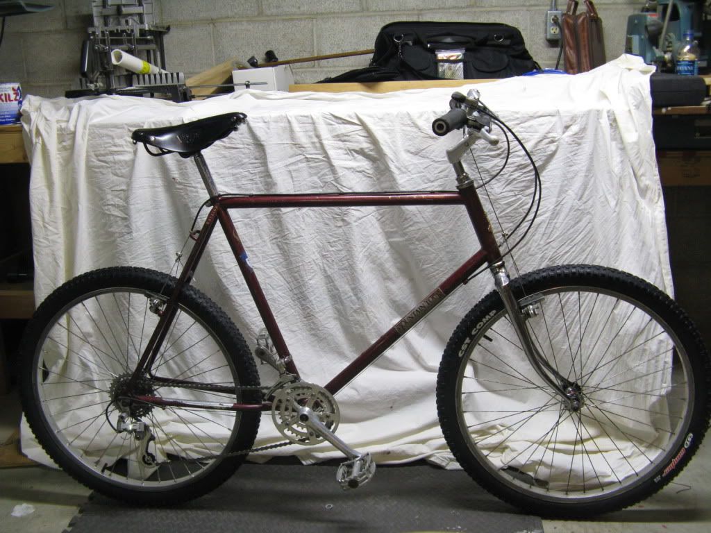

Been busy, but finally finished the bike up. Took it for a quick test around the driveway, and it handles like a tank (in a good way). Very relaxed geometry, something I'm not used to on a retro bike. Should be fun on the trail.
Frame: 1985 Raleigh Rocky
Fork: Raleigh? Chrome
Headset: Tange BMX
Stem: Unmarked bullmoose style
Handlebar: Nitto
Grips: Raleigh
Brakes: "Star"
Brake Pads: "Star"
Brake Cables: stock
Cantilever cable hangers: Shimano

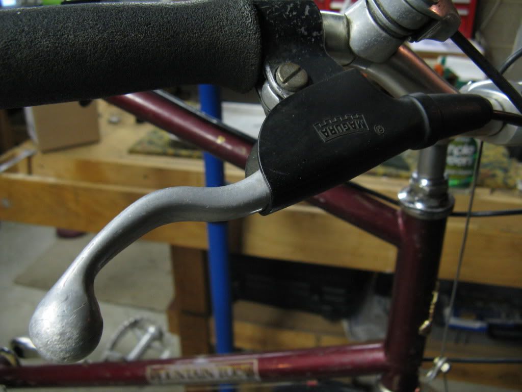

Brake Levers: Magura motorcycle
Shifters: Suntour XC
Front Derailleur: Suntour AR
Rear Derailleur: Suntour XC
Derailleur Cables: stock
Cassette: Suntour "Winner" 12-32 7-speed
Chain: SRAM PG-850
Cranks: Sugino AT
Crank Bolts: Sugino
Chainrings: Sugino 24-34-ground down 44
Chainring bolts: whatever was around
Bottom Bracket: Raleigh sealed bearing
Pedals: SR SP-452
Hub Skewers: bolt-on
Rims: Sumo 26 x 1.75
Hubs: Raleigh sealed bearing
Nipples: -
Spokes: -
Tyres: CST Camber 26 x 2.25
Tubes: original
Saddle: Brooks B17N
Seatpost: Raleigh chrome
Seatpost Binder: stock
Weight: Heavy (32.4lb/14.7kg)

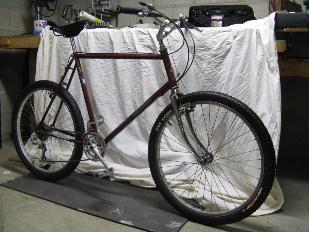

yup thats a big old raliegh clunker
but not a bad bike for all that ,everyone should have one in thier collection
tank like is a bit harsh i think ,gentle relaxed and quite plesant ,
my long winded take on them
Thanks, guys! I hope it holds up to some northeast pounding. Unfortunately, snowed in at the moment, so she's resting in the basement for now, haha.
