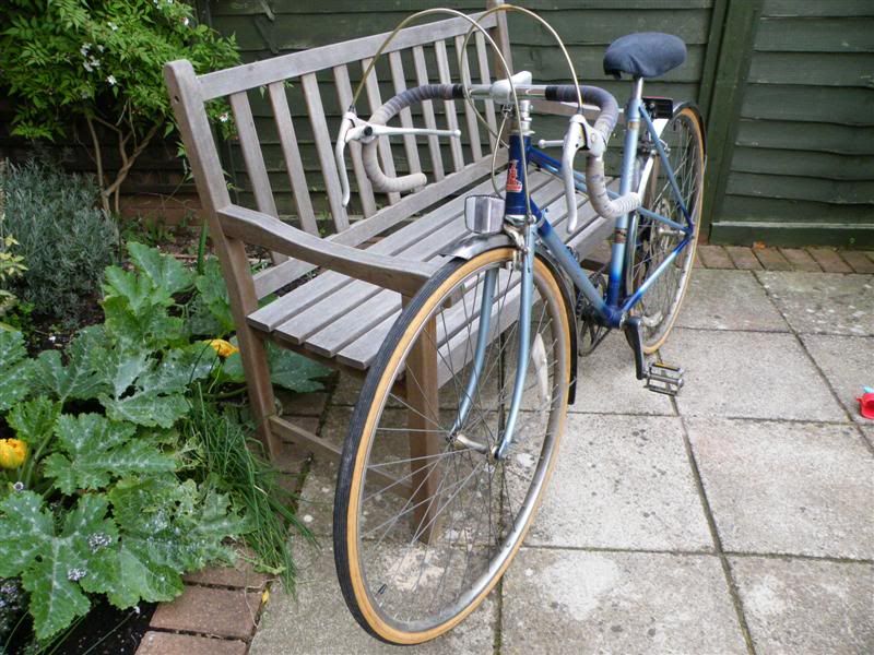

Anyways, here's pics of the bike as it was when I got it home last week.
