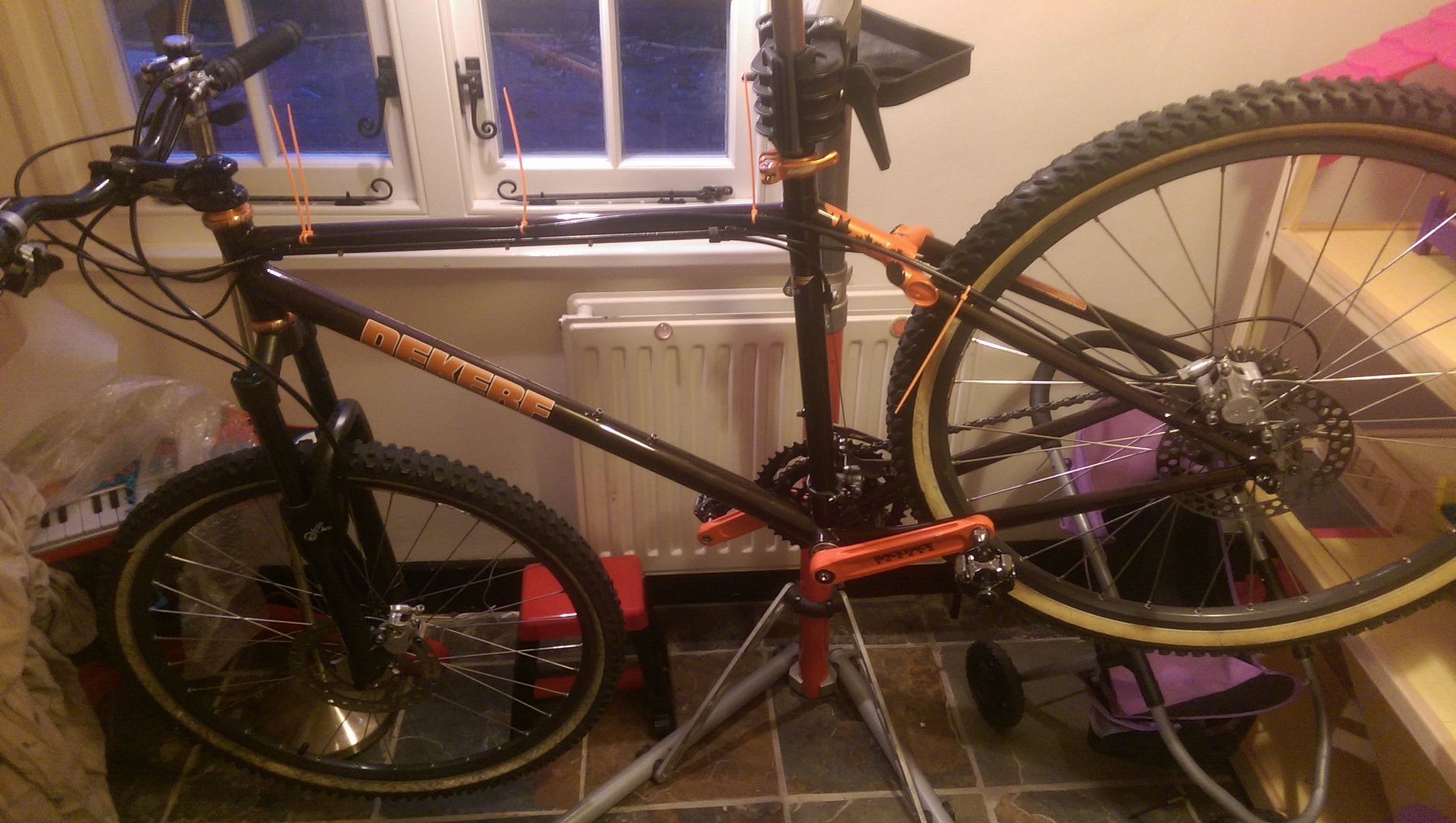

Just a pic for now .. build story to come.

So the above pic shows the DeKerf in "What was in the parts box" mode.
My spare X-lite Ti railed saddle & Use Ti Seat post,
Hope C2's front and rear
Hope stem
Crank Bros ultra low stack headset (but still conventional)
Pace RC38 LT (100mm travel) with quite a short steerer hence Crank Bros
RF Turbine cranks
Black Ti Glide/Suspension and Mavic 317 wheel set.
XTR M95x gear train.
This was mean to be a fling it all on and take it for a spin test ride - unfortunately it turned into much sadness.
Jumped on the bike and headed off the LBS to get a few bits and bobs to tweak the build. All fine and dandy, staff gathered around to admire the build, made suitably appreciative noises.
On the way back disaster happened, chain was making a dragging sound like the front mech was rubbing - didn't think much of it - figured the Mech needed a tweak back at the shed. Without warning the rear locks up as the Rear Mech dives into the back wheel. To this day I don't understand how the rear wheel survived without even a spoke bent, all I can assume is that the back wheel was already locked and stationary before the DR hanger bent.
Turns out what had happened was that the chain I had re-used had splayed out at one of the link and I think got itself locked in the Rear mech, transferring all the power and momentum to the rear mech and hanger, bending both the hanger and mech cage like pretzels. One XTR rear mech dead, and one frame very very poorly.
