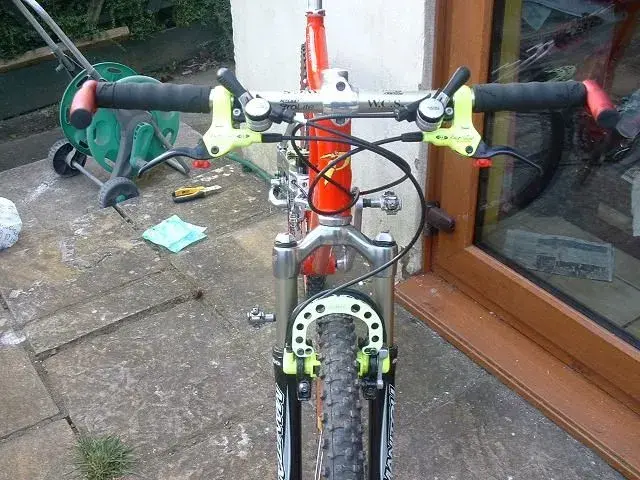

You can see the QR part on the right in the photo below with a silver/grey arm. These locate on the hourglass bolts you have,you may or may not have to put a washer behind the QR part to get the QR tension right.
Drop me a pm if you have any other specific questions :D

Welcome to hell ...I used two washers to make up for the proper ones and then spent hours pulling my hair out fiddling with them!! :twisted:

Ive nearly worked it out,at least the bolts anyway ,I need to work out what the washer with one flat on it does.
I take it the alloy 'arms hook inside the fork legs/stays to prevent the brake pivoting :?
And you have to be very accurate on matching the distance to the rims on each side
The little red adjusters appear to do nothing,maybe when its fitted ill be able to see what difference they actually make
Ach,who needs a manual :lol: :lol: :lol:
