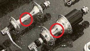

hubs
record OR
icarus
centaur
the difference that you will notice right away is that the grease port is absent in the Centaur version, while the only difference I have found between Record OR and Icarus is that the locking nut is in aluminum only for record while it is in steel for Icarus and Centaur
