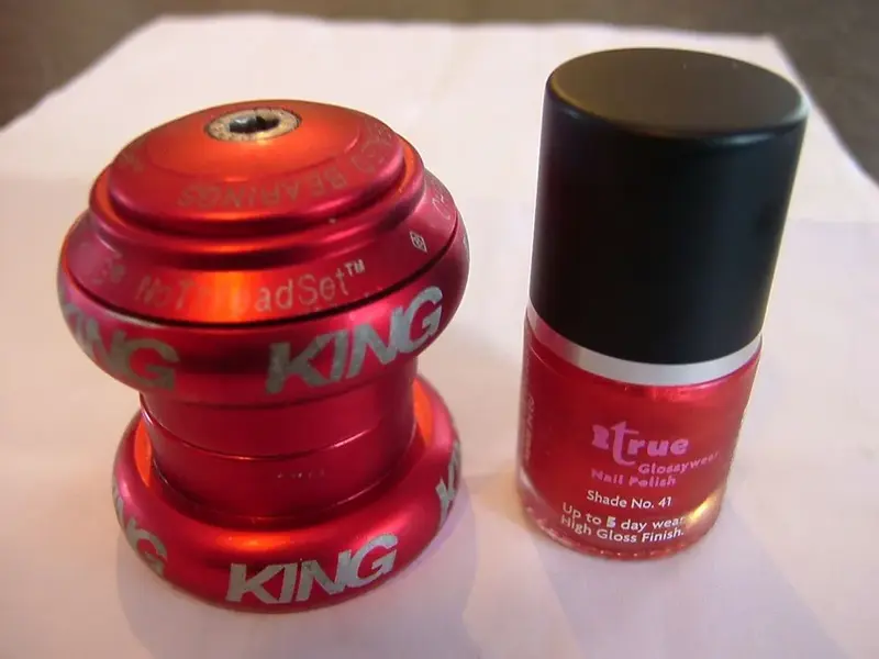

Read about a tip on how to renovate worn and chipped anno red parts and decided to give it a try.
I wanted a Chris King headset in anno red for my latest retro build, but did not want to pay £120 for a new one or even £70 for a mint second hand one.
In the end I bought one on Ebay for only £35 in perfect working order, but the anno red had been worn down to bare alloy by severe cable rub in places.
Now for the tip - I went with my daughter to Super Drug with part of the King headset and then spent the next half an hour looking through all the nail polish colours to find the perfect match. As you may know metallic paints are very expensive and still do not give the right colour and correct finish.
In the end we chose a polish called - 2true in shade no 41 with a long lasting high gloss finish which is the exact Chris King shade of anno red! :D
I applied 2 coats to all the worn patches and left to dry and its spot on - looks like new and is a 100% perfect match! See the picture of my Chris King headset and let me know what you think to this tip. :idea:
I have since used the nail varnish on tiny chips on my Hope hubs, skewers and X-Lite bar ends and now they are all 100% pefect! NICE.
............and now for the best bit, the nail polish was only £1.99 - BONUS. 8)

Wont last it says 5 day wear on the bottle :lol:

Well spotted! I forgot to mention thats it's then best to paint over the repair when fully dry with some clear acrylic car touch up which then makes the repair as tough as car paint. :oops:
I agree, still not as tough as real anno, but its a good tip to make an old retro look fresh and minty without spending 100's on NOS bits and if it does wear off in say 6 months, there is enough polish in the bottle to dab it on again many, many times over. :D

Nice job! I can't figure out where the repair is in your photo....
Funny, I had a LeMond frame a while back with some paint chips. Called Trek about touch up paint and they referred me to the nail polish department of CVS drugs. So many choices... In the end I also found a perfect match. :lol:

I renovated my DMR V8's with some of Mrs P's nail polish, perfect colour match, and not started flaking off yet :D :D

Permanent marker pen is also useful for covering up scratches on parts and frames.
