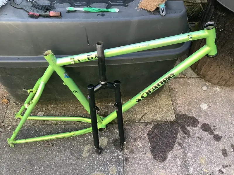

Recently purchased from randomdan... viewtopic.php?p=3034343#p3034343 ...his pic below:

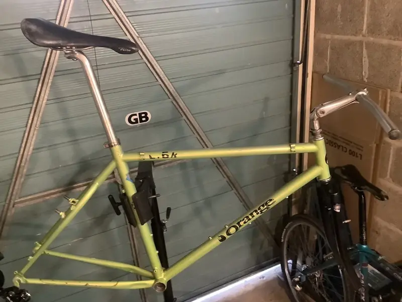

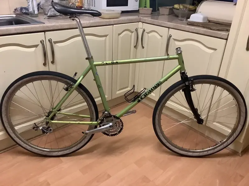

Wasn't going to bother with a build thread but here goes. I'll try to keep it brief.
So far have stripped down, cleaned up a few bits, and started putting stuff together. But let's start at the beginning - with a (clean) blank canvas. No plans to repaint or replace decals, I like a survivor with battle scars and all.

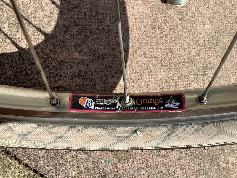

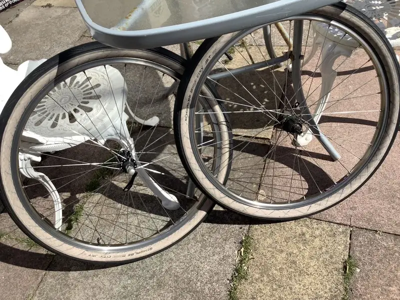

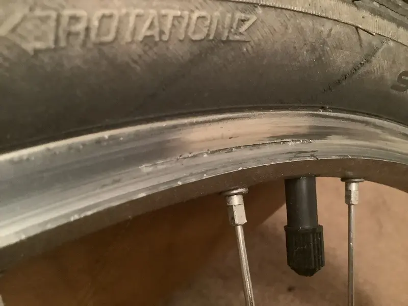

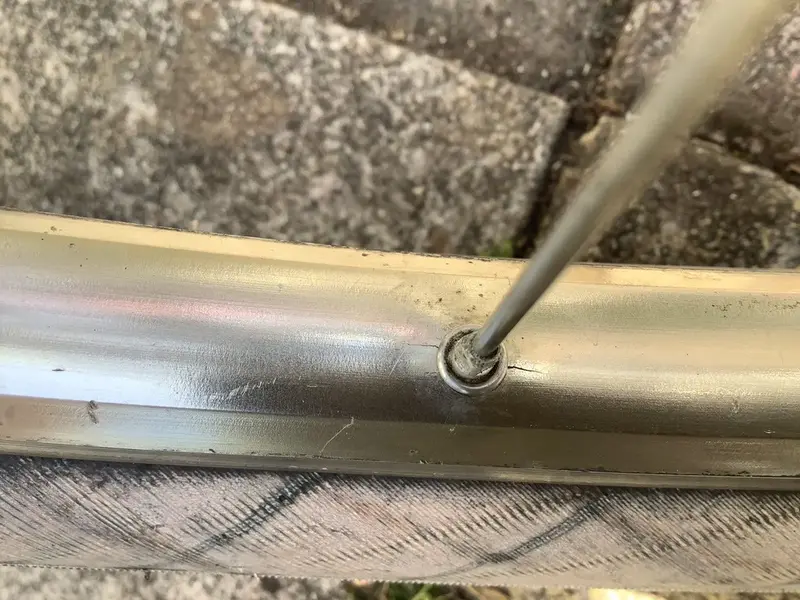

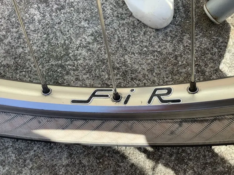

Cleaned up the lovely FIR wheels. Sadly the rear has had it... Kudos to Dan who went beyond the call of duty and sent me a partial refund as he'd missed it. Top retrobiker.
A new rim (Kinlin) and spokes (Alpina) are on order... I've actually got a matching black LX rear hub in the parts box which is all serviced and ready to go. Will hang on to the original and keep my eyes peeled for a good FIR rim... anyone?

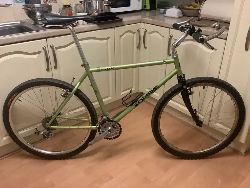

Started putting a few bits together.

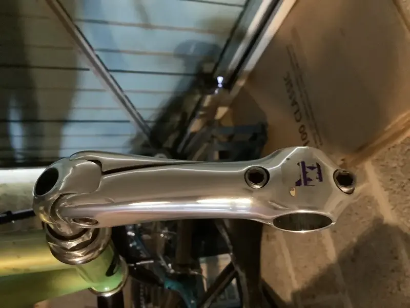

The supplied stem is lovely but it's gonna be too long for me... the best thing I could find was this adjustable one... a bit ugly perhaps but it's actually a really nicely made thing... also looks an ideal length, so I'm going to go with it for the time being. Anyone recognise it? The logo is damaged.
Was chuffed to find a seatpost that fits the supplied shim. Decided against the Orange Enduro saddle - Flite is lighter and I know it'll work.
Replaced the headset too... crown race was really loose on the forks so popped an unused Tange Passage on. Need to find a spacer for it, I don't fancy cutting the forks down.
Continuing the (random) silvery theme I've decided to go with silver hot rods. So far I've used nothing that came with it... so it goes!

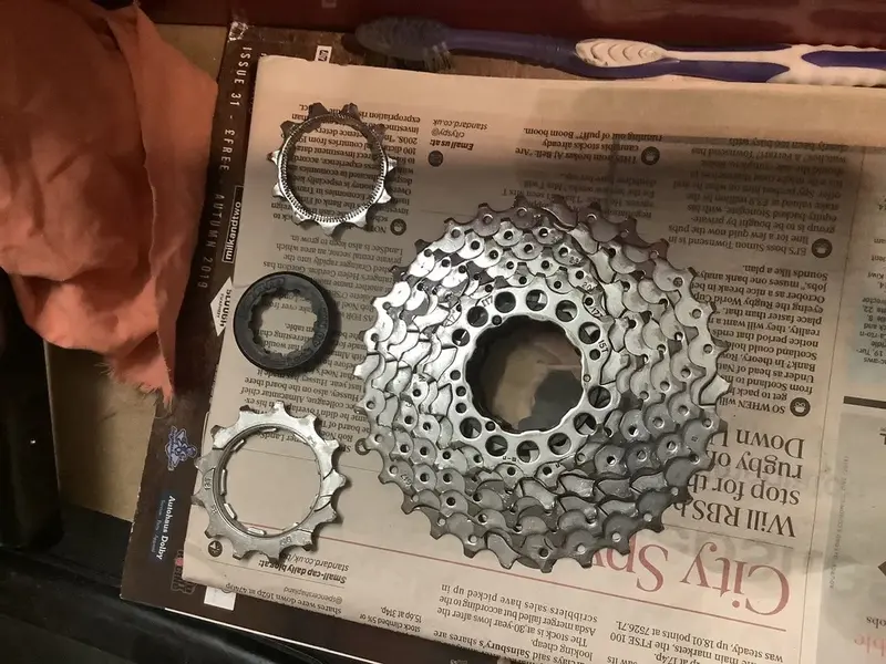

Cleaned up some of the original parts...

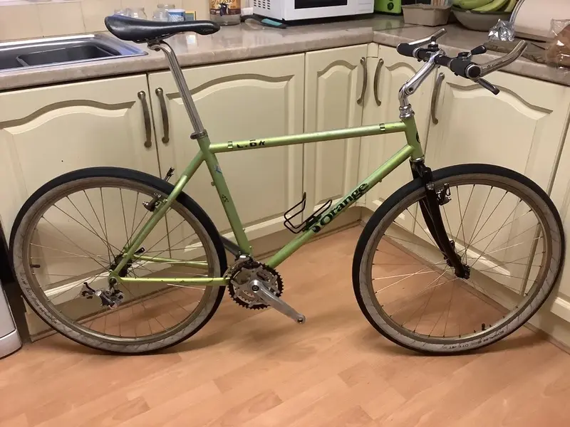

Slow progress... but I'm pleased that the build is moving forwards. Plan for this is a ratty/"survivor" go anywhere weather proof adventure tourer with rack and mudguards. I'll aim for roughly period spec but there will be exceptions.
I decided to take advantage of the frame's e-type front mech boss... which meant that not only did I have to buy a new mech, but also a suitable BB. Sorted that and then had a change of plan re the chainset... I like the concept - band-on mechs have always seemed like a bit of a compromise.
Brakes are hopefully sorted, some tired looking single digit TIs.
Tyres are temporary... Not sure what I'm going to fit.
Back wheel is still to be built, rim and spokes waiting but headspace lacking.
Getting there...

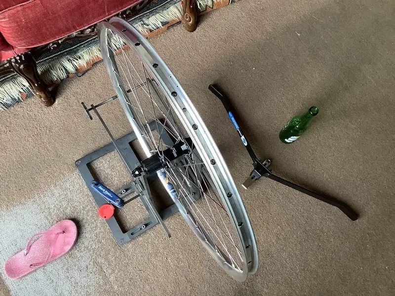

I'm looking forward to getting it ready to ride, only thing delaying me is getting that back wheel built. Haven't quite had the headspace for wheel builds...
