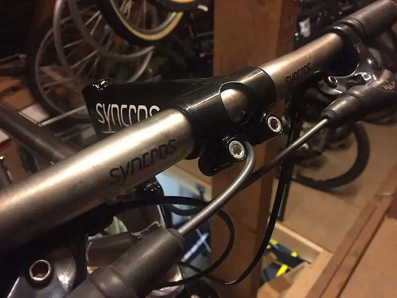

I thought I was going to have to change the bars too – but on very close inspection I could see the distant remains of Syncros stickers – and it turned out they were actually Syncros Ti bars which had also been installed upside down! A quick flip, and with the help of some new decals from gil_m they are the perfect fit!

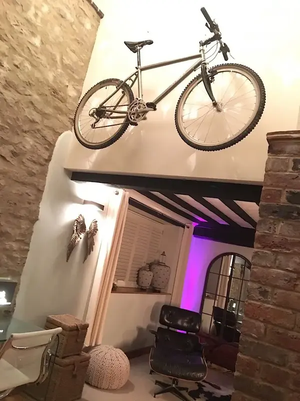

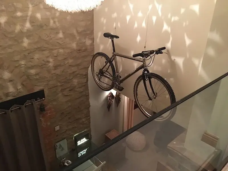

….this build was always destined to be hung in the house as a piece of art!
I don’t intend to let the NOS Smokes touch the dirt!
Thankfully we had a blank wall that needed ‘decorating’, and I have a very understanding girlfriend who OK’d this project (she was given multiple other bikes to choose from, like dolomite Attitudes etc, but this one got the vote. Suits me!). Found an ‘off the wall’ way of displaying it too…
