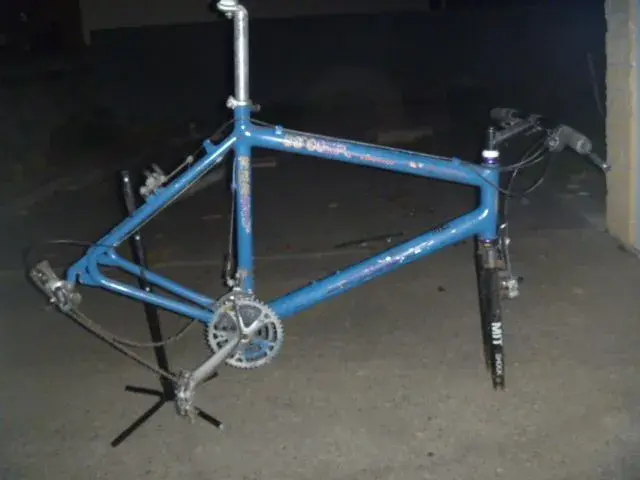

Just picked this up locally: a K2 Comp-1, a bike I lusted after as a teenager but far too expensive back then. K2 is not at all known for their bikes in the early 90s (well before the Proflex buy-out), but here on mainland Europe they sold some fairly high-end bikes. There's little history on the web though.
The frame is crack and dent free but the clearcoat is damaged in several places. Most (but not all) original decals (under the clearcoat) are well preserved, with just a bit of fading. The state of drivetrain, brakes and fork (none original I believe) do indicate it's been well used.
I'm not sure about the exact age. Color scheme (similar to: viewtopic.php?f=6&t=272536 ) and M730 front mech place it around 1993, but the tubing seems to be larger diameter and a lot of the components correspond to 1994 or 1995, although I doubt these are original. There's a code engraved on the seat tube, starting with C98, but for sure it isn't a 1998 bike. By that time, K2 had taken over Proflex, and the logo was entirely different.
Weight of the bike, 90s mud included, is 12.1kg, so the frame itself should be reasonably light.
The goal is to strip it down first and weigh the frame, just to be able to judge what level of restoration it deserves. In any case, I'll renew the clearcoat and decals. I have some NOS M900 parts in boxes, but perhaps these are too valuable for this frame. We'll see.
Apologies for the poor phone photos.

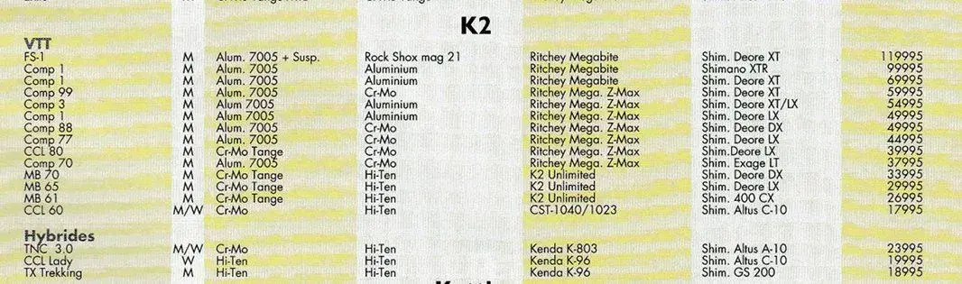

ok, I made some progress, not on the seatpost, but in determining what year it's from and how it fitted into the K2 range. On my bookshelf, I found an old Belgian buyers guide for 1993, and it has several K2's with pictures in there, plus a list of the models with their spec. See below for the scans.
Apparently, there were 3 versions of the Comp-1: LX, XT and XTR. For the rigid frames, the Comp-1 was the top model, while the Comp-99,88,77 etc seem to have been lower range, with Cro-mo instead of alu forks.
With a price of 99000 BEF for the XTR Comp-1, it was among the most expensive bikes available on the Belgian market, costing about the same as a Marin Team Issue. I think this bikes deserves a proper restoration.

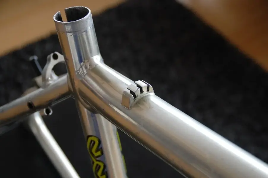

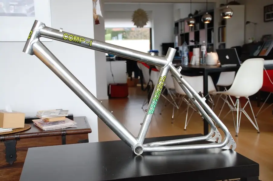

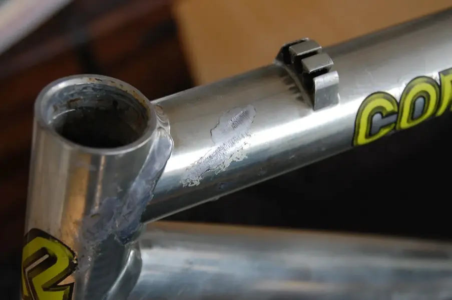

Finally managed to complete the strip down and give the frame a thorough cleaning.
Weight including bolts and canti studs is 2080 grams, so it's a rather sturdy frame.
As shown in the last photo, there's a clearcoat on the aluminium. The alu seems to be somewhat polished before the clearcoat was applied as it looks rather mirror-like. Any advice from the paint experts on here on how to redo this? Media blast + some sanding + some polishing before applying a clear powdercoat? Will the paint stick if I do some polishing?
All advice is welcome!

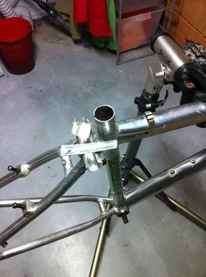

@PaintedDesert I have a pretty similar frame but slightly different... Th top tube is narrowing when it hits the steertube, which leads to the fact that the cableguides doesn´t fit on the top but have to be positioned on the left side of the frame! I guess that I have the 93 Model and yours is the 92 Model. But I do only find the pictures and info on it. The serial number doesn´t even take me further... Can you look up yours? It might start with C98... Does it? Mine starts with M28.
regards Moritz
