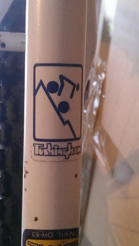

Picked this up the other day, seems to be pretty much in original "survivor" condition. Exage Mountain groupset, some Muddy Fox tyres (a later addition?), and the orange paint has mainly faded.
It just needs a clean and polish, and some new tyres as they're shot, and it should be good to go!

Started working on this today, the serial number on the BB shell is H7N05291, I don't know if that's relevant or if it means anything?
The serial number of my courier is H8O32236 so it follows exactly the same sequence / type.
I believe I found that this meant the frame was Araya made - but that could be hearsay (seems like manufacture moved to Taiwan sometime around '89)
