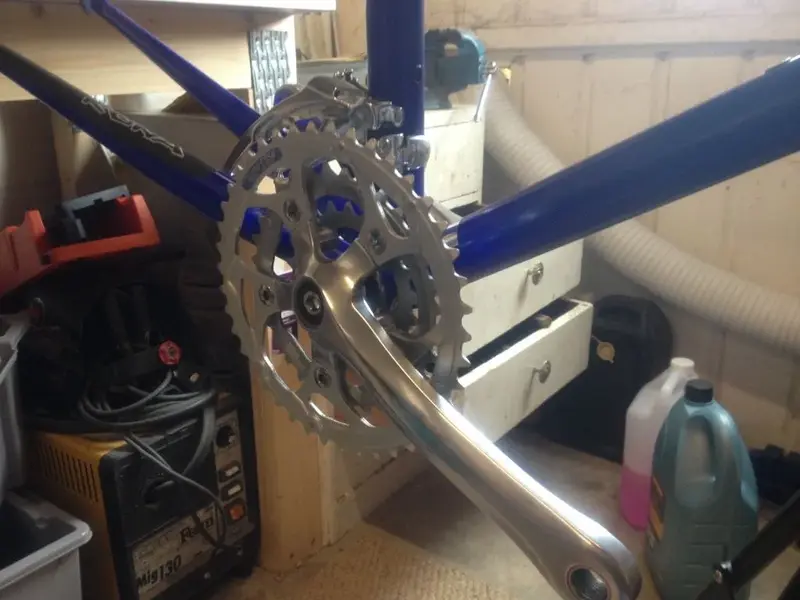

Some Progress with the Cinder Cone, I've fitted a new UN55 BB and some Sugino Impel cranks that have had a bit of wet & dry and some metal polish and treated to a set of NOS sugino rings (42/32/22T)

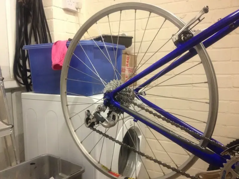

I've also managed to pick up a pretty tidy pair of wheels off ebay that arrived today, XT M739 hubs fitted with Mavic 217 rims with Sap spokes, A quick clean and they look ok, bit of sticker lift on the front rim and one very very small ding in the rear rim the only faults I could find with them.
I fitted a new Sram PG850 11-28t cassette to the wheel and a new Sram PG850 chain and bolted on the tidy M737 XT rear mech I had in the parts box.
More bits are on order but not arrived yet...

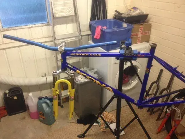

Debating what tyres to fit to this, At the mo I have an Onza Dan rear tyre, a Kona Sniff front tyre and a Tioga Psycho... I have retro love of the Psycho, but would need to source another one really....
Surely if you're just knocking around town, down steps etc, you need some kind of street tyre? Crazy Bobs? Bigs Apples? Insert non-Schwalbe version here?
I know they're not retro, but provided you choose the right size they'll still look good.
