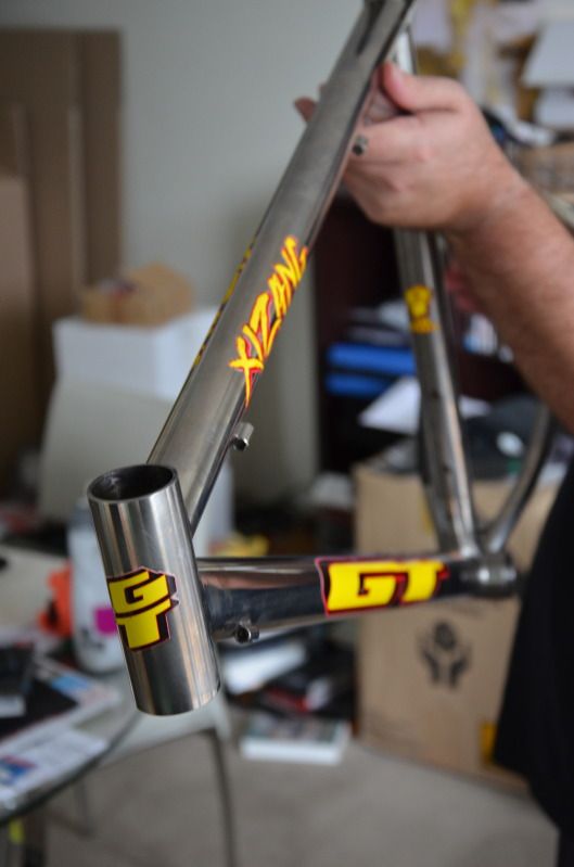

Well I've been wanting one of these for a good long while but haven't had the spare cash to get one till now. Big thanks to CCMdoc over at mtbr, well and here as well, for hooking me up with this one.

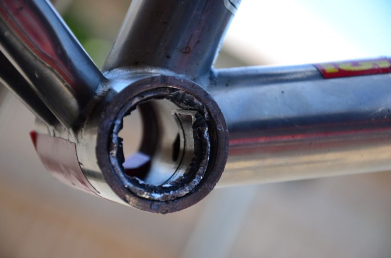

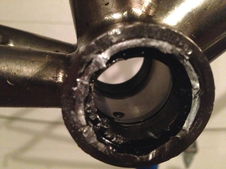

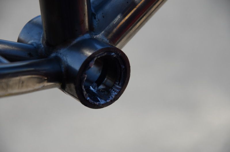

No there was a small problem: (yes I knew about it before buying)
this cause me loads of issues as it was a M950 BB that had some super hard bearing surface in it that was hacksaw resistant... anyway

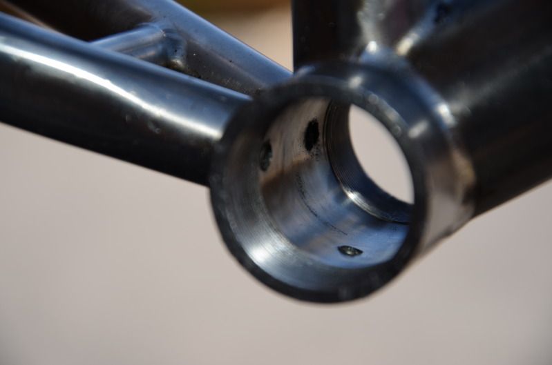

Yay!!
spare BB to see if I didn't screw it up too much...

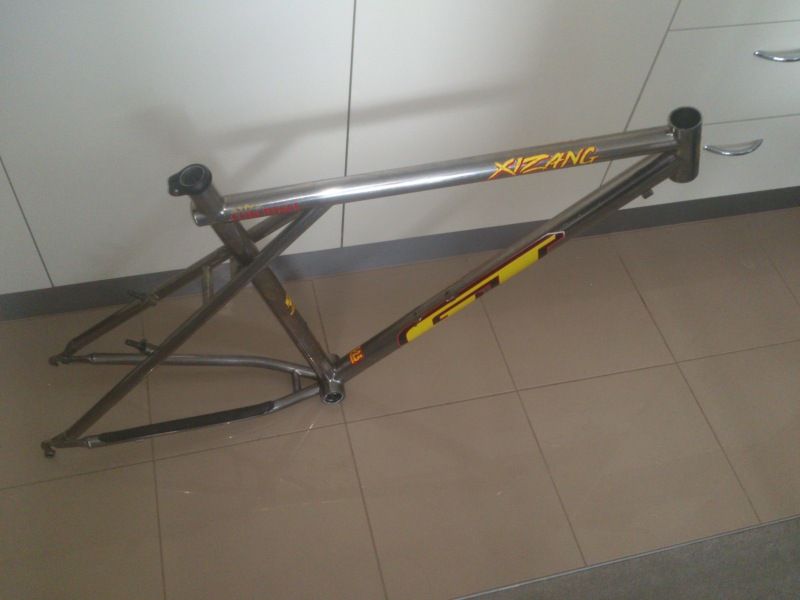

SO now to a build... I will strip down my yet that has mostly late 90's early 00's XT on it and see how it goes...I know a Judy SL would be perfect, but I have a Manitou Mars to go on it as a) I like Manitlou stuff, b) it has a lockout. Then will decide if I go new stuff or try to track down some 95x XTR (NOT a bloody 950 BB thats for sure), all depends on how much I am riding it...
But must say today is a happy day now I have the BB out and can start on the build.

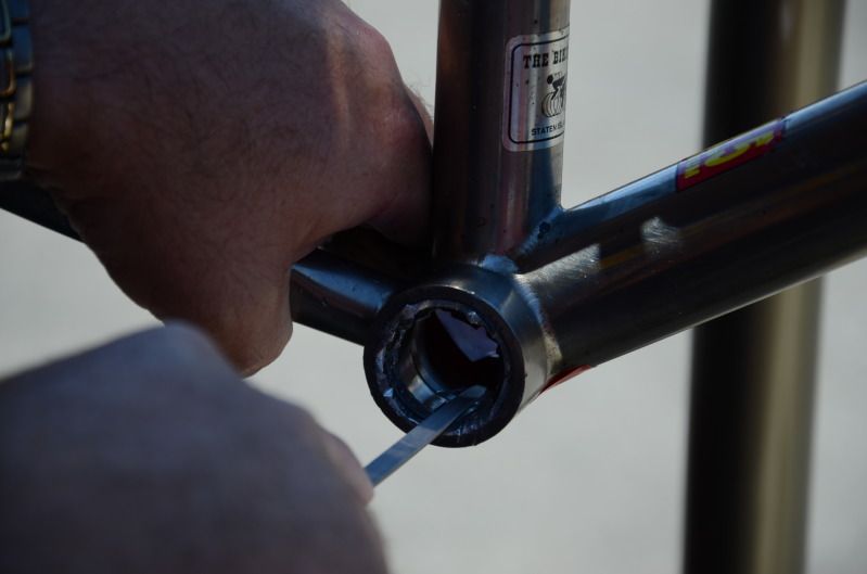

nice one! it must have been very rewarding to get that bottom bracket out! you did a great job. how did you do it? i can see the file? in the pictures or is that a small saw
PostPosted: Sun Jan 27, 2013 6:21 am
Joined: Tue Jun 19, 2007 3:34 pm
Posts: 2300
Location: Launceston, Australia

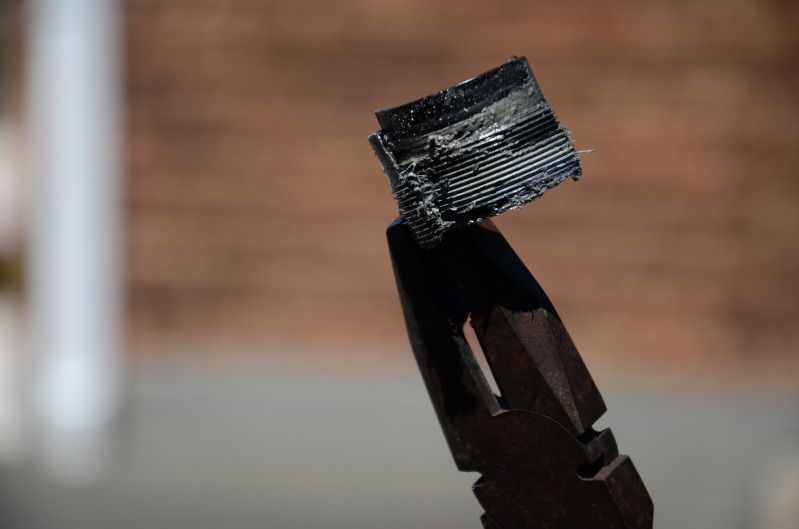

Yeah, well most of the bracket was gone due to the unhappy removal before I got it. Started out with a hacksaw, witch was fine cutting through the aluminium, until I hit the hardend steel (or whatever) bearing face... then it just blunted a pile of hacksaws which only barely made a mark... so today went and bought a dremel and used a grinding bit...woosh straight through, then taped out the hard race and carefully used a triangle shaped file to get through the rest (and a teeny bit of thread :oops: , GF was going your through to the thread...na its still the cup... but was actually through. Then it started to crack, so used a punch to knock it out of round . Then tap it till there was enough threat to grab with pliers and rotate it out.
Was damn horrible.
