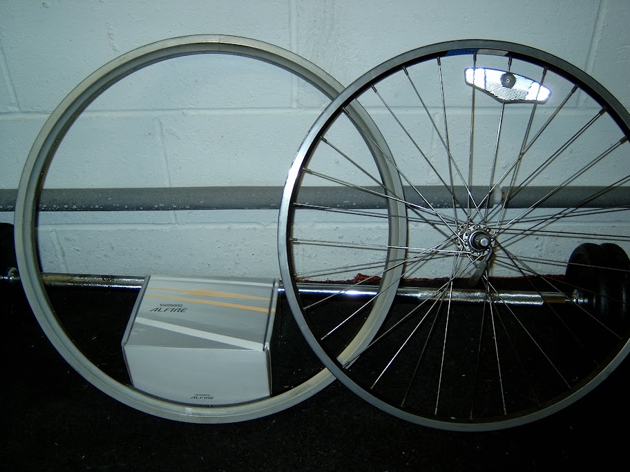

I wanted internal hub gears, to make the bike lower maintenance and fit in with the bullet-proof, do-anything idea.
The rear wheels was not the original one, so I hunted around until I got an Alfine hub at a good price. I then needed a rim to go with it. Initially, I wanted an old Ritchey Vantage Expert in "duranomic grey" to match the front wheel, but decided I would be better served with a modern twin-wall rim, so after much hunting I found one made by Leaf which is a similar colour and also has a similar V profile:
I shall have the wheel built up once the frame is on its way to the powdercoaters.
