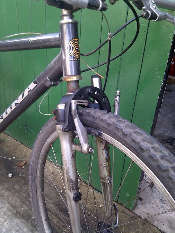

Yesterday i took ownership of a very tatty Kona..
the forks are absolutley fcuked. not even sure they're repairable, especially as i knocked the valve unpacking them and it snapped :(
No seat or seat post. Chap said he's got them floating about somewhere and he'll dig them out if i want them, definitely think i will for the seat post.
Bolts all over the bike are rusted to hell, headset needs replacing. Quill stem looks ok. rear mech is also missing. not sure if he'll find that as it looks like the gear cable has been cut, so that needs replacing too. all new cables..bleeeh, the list goes on...

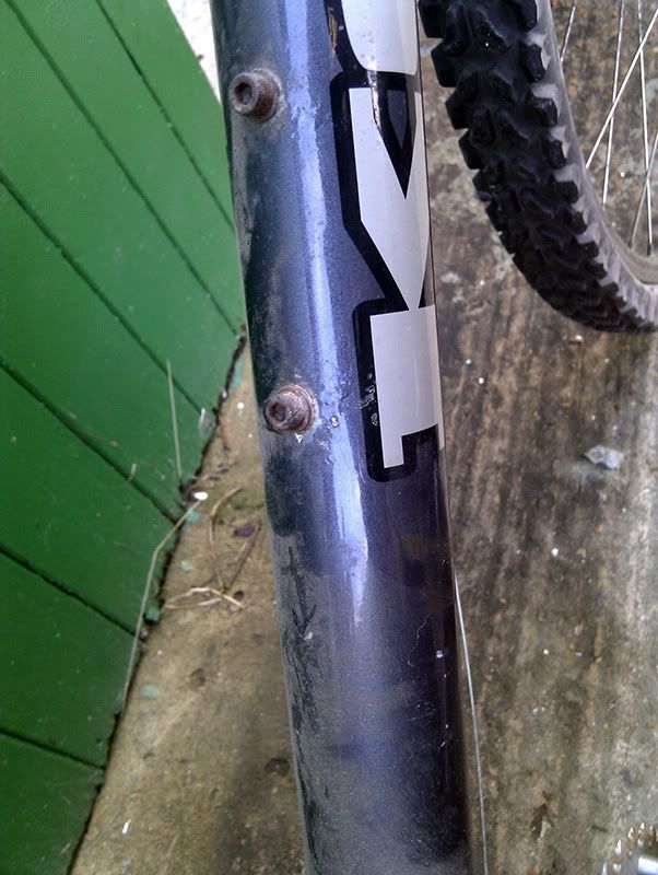

one thing that does worry me is the bubbling paint near the bottle cage mounts..surely aluminuim doesn't corrode??

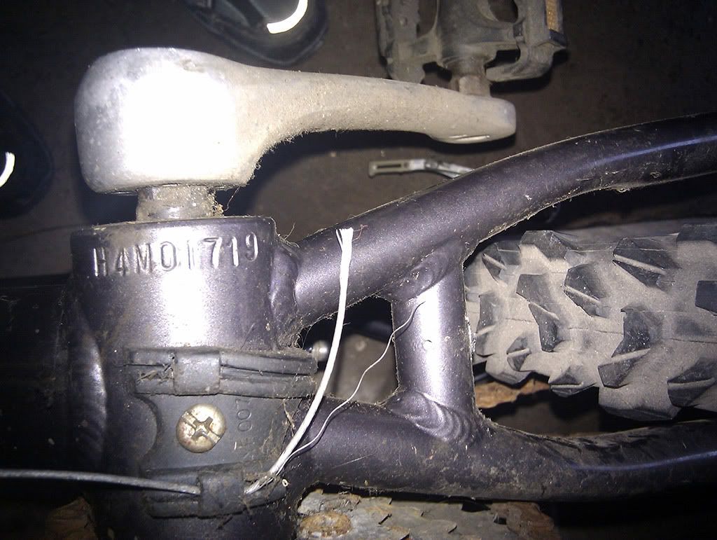

last of all a serial number for ID porpoises
could someone help me translate it?

verdicts please gents..i know it's a long road ahead and would welcome all the advice and help you can offer! (still quite the junior at all this)
made at Hodaka factory / Taiwan in 1994

Not sure about the paint, mabe it is just bubbling an d lifting, as you are right, cant corode.

It looks as though everything that's there is original, except for the LX M600 V-brakes and levers, which were an almost universal upgrade in 1997 and still work very well indeed. If so, the wheels and tyres alone are worth more than you paid for the bike - Mavic 237 on Kona suspension front / LX rear, with Mr Dirt / The Cleaner tyres. Like everything else, they just need to be taken to bits and cleaned/lubed and then everything will look a lot better. The paintwork looks pretty good to me, just needs cleaning and a bit of touching in. I wouldn't worry about a bit of bubbling - it isn't causing any damage, but you could file it off and repair it if it offends your eye.
I actually have one of those forks in working order if you wanted to do a period-correct build, but tbh you would probably be much better off with a Judy XC or Z-series Bomber for it. It would be well worthwhile chasing him up for the missing rear mech (XT), the saddle (worth 15-20 if in ok condition),and the rest of the Impact headset, as it would be a pity if it was MIA.
As to what you've got there, the Sugino Impel cranks look ok from here, you have the LX front mech, the stem which looks in good order and is worth a tenner or more and the original reasonable handlebar. Somebody seems to have done you a favour and put the left hand Gripshift SRT-600 in the bin, which is a good hint for what to do with the rh one. And even if the frame was useless, believe it or not the seat clamp is worth 5-10 and the cable guide must be worth 15 in the rare 31.8 size.
We mustn't get carried away though. We all have the experience of cleaning a frame like that and finding a crack, which in this case would be fatal. You would still be way ahead on the money, so not a tragedy, but I do think you should strip the bike down as soon as you have an opportunity and as you clean the frame have a really close look for any hairline cracks. I'm not saying these frames were prone to it, but just that until you've done that check, you can never really declare yourself content with your new addition to the family.
Subject to that, I can see this bike as being quite a fast cross country charger by the time you're finished with it.

Also I'd dump the forks - I've always thought they were ugly, especially where they narrow to meet the spindle. Period Judys are better IMHO

Love the velocity stem, but not sure i like the options it leaves me with. I fancied some forks with a little longer travel (around 80-100mm) but really want to keep it sympathetic to the original colours (plus i really fancy some orange ano bolts!)

a little thought if i do try and clean up the paint chips, as there are a LOT! how easy is it to paint match ? spot thing from halfords, or is it a little more hassle than that?

Starting the cleaning and polishing tonight and over the weekend, so was wondering if anyone had had any thoughts on the paint and how to match it?
magas' idea of humbro was quite good, failing that should i just take he frame to Halfrauds and see what they can do?
Yeah, spot on with paint idea.
