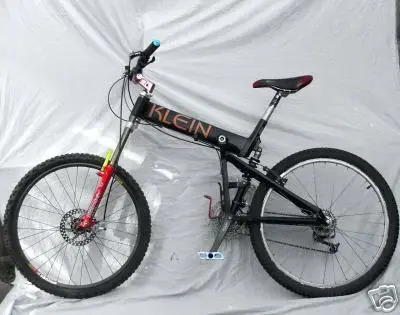

Hi, I have a badarse frame here and I have one little problem with it in so much that the cable guide on the down tube has sheered off. What should I do?

The only thing other than the repair to the cable guide is that the colour isn't the greatest being black and has aged a bit.
I would like to fix this and get it back into the Klein spirit with a pearlescent job, I would like to hear people thoughts on a repaint of the bike and what to do about the decals please. Thanks.

That front fork is wayyyyyy beyond the intended spec. How does it ride?

You have knowledge I don't. This is how I got it and it soak's up everything but it's alittle slow compared to new machine's for the same task, but I can tune it to be better given time but my interest's lie in social/fun riding so it's fine.

Re the downtube cable guide, do you still have it, or is it lost? If it's lost then you'll have to source a new one (from Trek?) and go to a frame repairers and get them to fit it on.
As for the fork comment. Frames are designed to take a certain amount of fork travel. Going above this can and does seriously effect the factory handling of the bike. The Klein Mantra is basically a do anything/xc bike and a couple of minutes research has revealed that keen Mantra riders tend to run 80-100mm forks. The JrT's are probably 120-140mm. If you're only riding fun rides you'll probably be fine.

Could always bodge the cable guide by cutting one off a manky old frame and bonding it on? Worth a try for free anyway...

On the down tube half of the guide snapped off somehow but amazingly the cable is still staying in contact so the functioning is unchanged. It has to be fixed.

just weld it back on.
