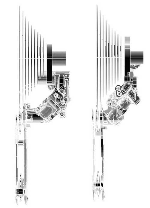

I about to but a new shimano rear mech, but have the choice of 2, shadow or non shadow?
I understand that the shadow rear mech sits closer to the bike, making it not so prone to rocks etc. But apart from that what is the difference? Do they both work with standard shimano shifters?

In a word yes, they are less prone to snagging twigs on the trail as the body of the mech is angled to much the same as the cassette and sits very close
Shadow on the right
PostPosted: Sat Sep 03, 2011 8:42 am
Joined: Sat Jul 18, 2009 8:52 pm
Posts: 799
Location: Costa-del-Oldham
Brilliant picture to explain. I hadn't realised the difference myself & that makes it perfectly clear
Thanks.

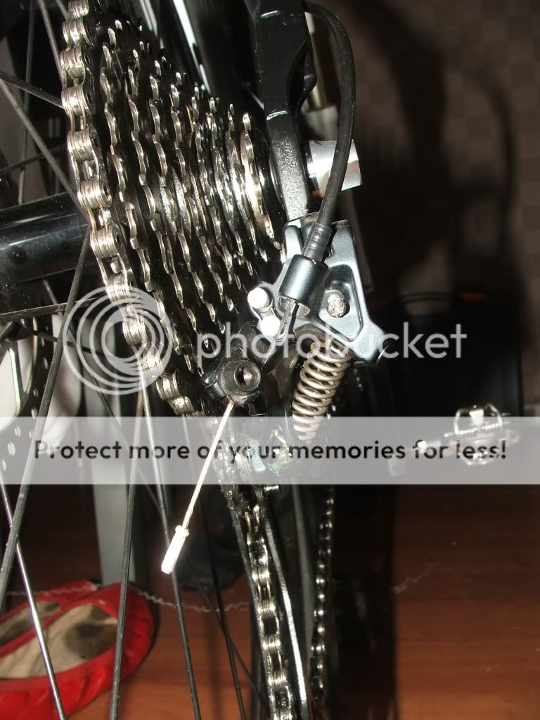

This is what a shadow should look like on largest rear, the whole body is close to the cassette
I really dont think there is any need to be honest, if you snag it on a low branch or rock, it will break the same as a conventional mech :wink:
