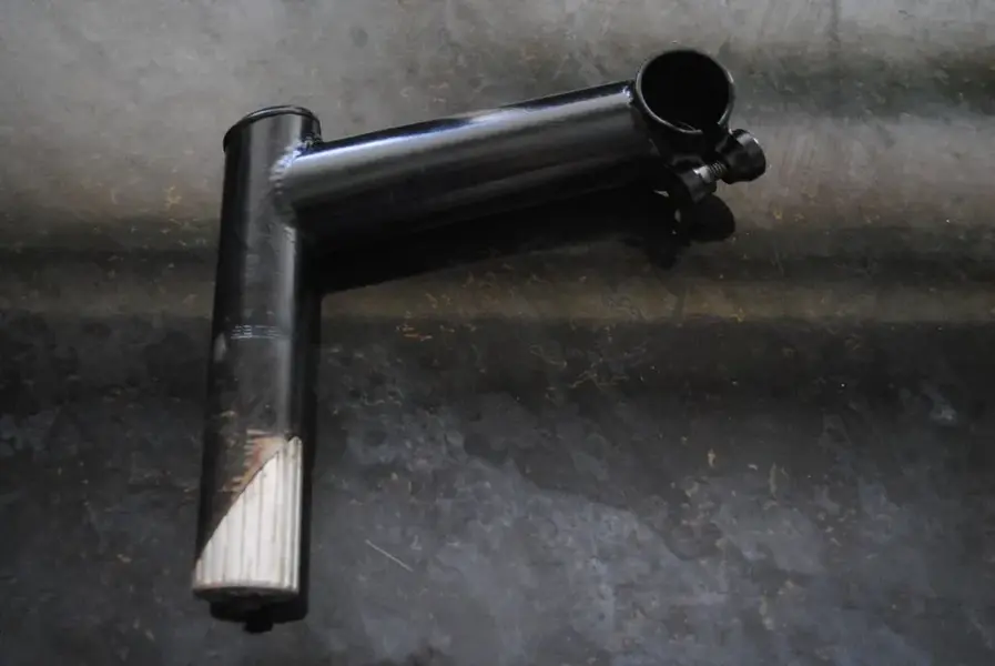

1 1/4 quill stem with rise and Manitou elastomers

Ive just been for a ride and theyve just compressed to nothing. The stem is far too low too so I'd ideally like to swap it out for a 1 1/4 quill with a lot of rise.
