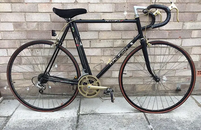

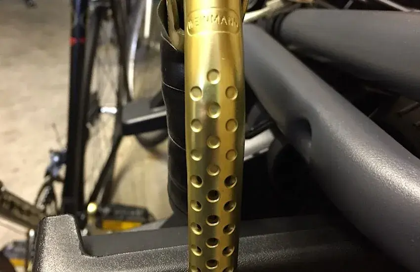

Here we go again one rebuild finished sat twiddling my thumbs. Thinking about another project now the Raleigh Competition GS has been passed on to my son on his birthday. The very same day I chatted to an elderly neighbour and told her about the fun rebuilding the GS and she asked if I would like to have a look at her husbands old bike, been in garage for 35 years and was bought new in 1984 and not ridden very much. Sadly her husband is no longer in a position to ride it.
Result I now have another new project........Watch this space..,,
File comment: All completely original specification.

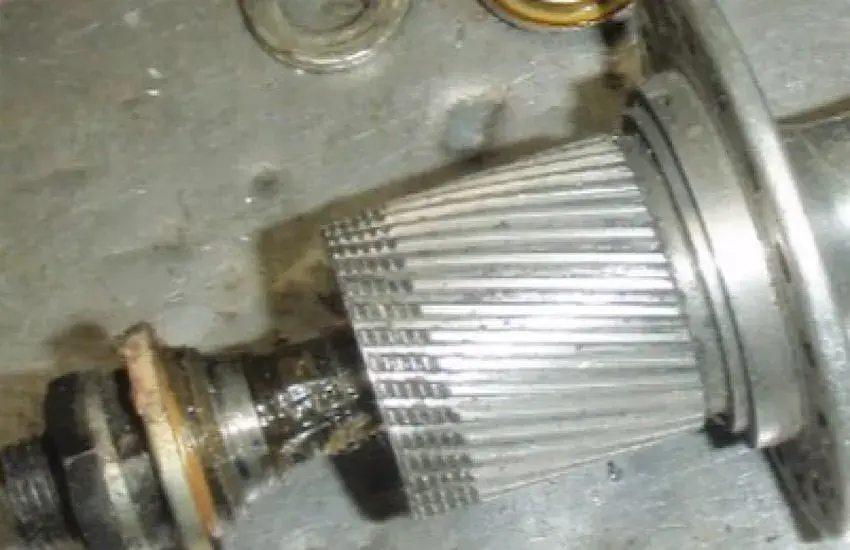

Been working on the bike today. Ordered the Helicomatic lockring removal tool yesterday, but impatience got the better of me and I called in to my local bike shop to see if I could borrow their tool. After a lot of digging they found one, but said they had not used it for many years. The ring came off real easy and the freewheel then just lifts off the spline no unthreading. I believe these removal tools were once given away with every bike with this type of hub. They certainly make removing the freewheel so easy if you can get hold of the tool that is. So If you have one dig it out and put it on the internet, they are going for silly prices for what was once a freebie and most seem to be coming from America.

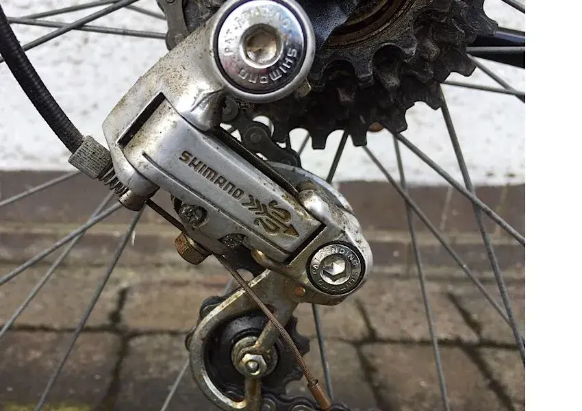

Also can anyone tell me anything about this shimano rear mech 'shown below', its not one I know anything about. Thanks
File comment: Rear Mech

http://velobase.com/ViewGroup.aspx?Grou ... b2798a796b
PostPosted: Thu Aug 01, 2019 8:59 pm
rBoTM Winner
rBoTM Winner
Joined: Wed Sep 02, 2015 8:01 am
Posts: 205
Location: Do not go where the path may lead; go instead where there is no path and leave a trail.
legrandefromage wrote:
http://velobase.com/ViewGroup.aspx?GroupID=a34ae6a0-52cd-4bca-9586-cfb2798a796b
Thanks for this. Now I can see why it was used on this bike being called Shimano Golden Arrow

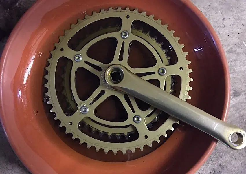

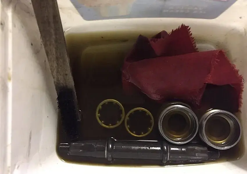

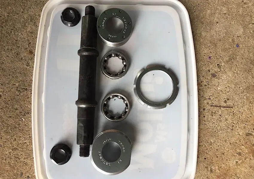

After many years of none use the crank arms finally came off. The bottom bracket cups needed a good clean, the old grease had actually solidified and needed two hours in the degreaser to shift it. I'm very pleased the cups are pristine no pits, even the caged bearings show no wear, but are being replaced anyway. I've already replaced the 2x13x5/32" balls on rear hub and 2x10x3/16" on front hub. Repacking the BB tomorrow then replacing the cranks. Next job the headset bearings.
Incidentally
This bike does not have suicide brakes as described in some other threads for this model and year, and the catalogue I have seen for 1984 does not show them either. Anyone more knowledgeable than me know if they last listed them on 1983 models?
File comment: Crank off and soaking in degreaser.
File comment: Fixed cup coming away nicely
File comment: Soaking in degreaser
File comment: Nice and clean
