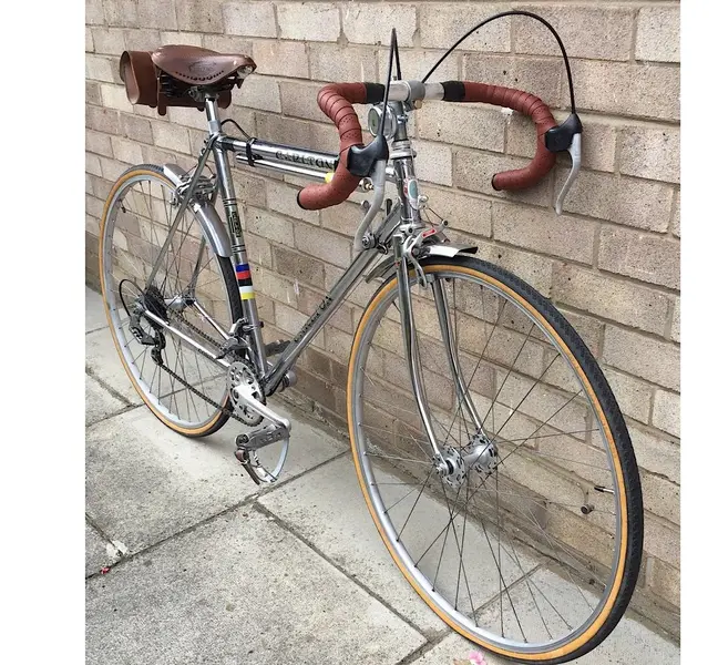

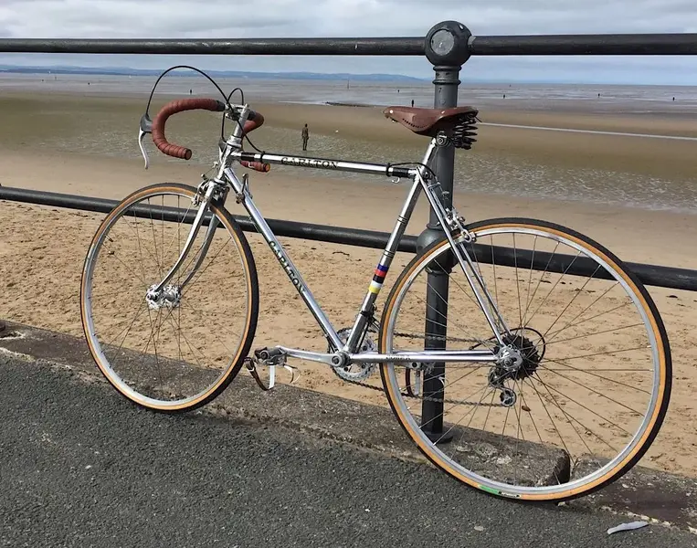

As my name suggests my old 74 Cobra lacked a bit of luster. After many years of good service I decided to give the old bike a full service and refurb. Not being an experienced restorer, I sought assistance on this site. Thanks to all who contributed. The Cobra has a good work pedigree not only for regular road riding., but also for ‘yes’ off road saurte’s including youth hostel weekends and long holidays. In 2015 I decided to give my steed a much needed rest and easier future life. I completely stripped it down, degreased and cleaned all the peat bog, road dust and accumulated grime, and there it sat naked down to the frame on the bike stand for 3 years until June 2018 when family commitments allowed me time to finish the job.
Yes the original blue paint was removed and the chrome derusted using vinager and aluminium foil and a good chrome cleaner. I did make enquiries about a full rechrome, but the cost was extortionate so I decided to continue alternating my cleaning, polishing and waxing of the original frame. Most of the build bits are originals. The major change being the front chainset which is now 30,36 this was changed in 2000 to assist with the many hill climbs and bridleway rides. All cables were replaced in the refurb together with new chain and a retreated Brooks saddle which I darkened to match the new bar tapes. New toe clips were added to complete the image I wanted. Just a couple of chrome shortie mudguards will restore it to the first love of my life status. Much to the annoyance of my long suffering wife. I am looking forward to many more years of use from this trusty steed. Both of us taking it a little easier as the years roll on.

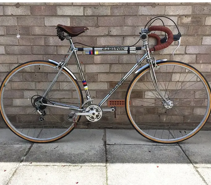

Finished Job...well almost.. Homemade shortie mudguards courtesy of a friend and made from mudguards on 2005 photo.
Just needs a brown leather tool bag to complete how I want it to look. My vision......... :roll:

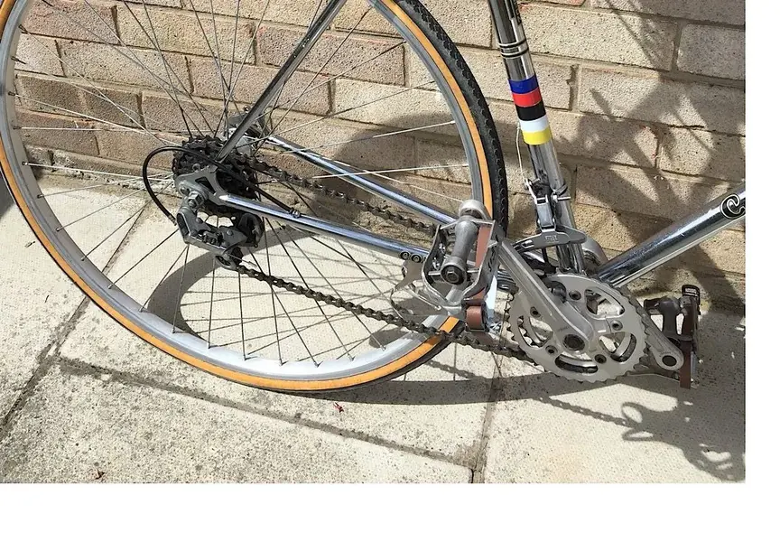

Interesting choice of gearing. Can I ask why you have not dropped the front mech to be closer to the chainrings?
Don't suppose it makes any odds to anyhow, but just wondering.
Hi NeilM. Thanks for the interest in my article. The choice of gearing was dictated by my chosen style of riding in early 2000. I changed the larger chainset to the now 36T large 30T small as this was the only chainset the local bike shop had that could still be shifted by the old original Sachs Huret front derailleur which does have a long casing. I did try moving it down when refitting this time, but the problem was it hit either the frames chainstay or the rear derailleur cable which travels above the chainstay. It may look awkward, but it does change smoothly. I suppose I could try and source the original large chainset and cranks, but really I am pleased with the ride the bike gives me now. Even though both our touring and pass storming days are now in the distant past. Thanks again for your interest.
Chainstays, yes of course. I knew there was bound to be a sensible reason.

The final image may not appeal to everyone, but it is the vision I had at the start of this complete refurbishment. Yes the old bike can still catch the eye and has started many an interesting conversation when out on the road. I look forward to many more years of use from this the favourite steed in my stable. We are always just dreaming of 'Another Place' just down that long and winding road!
