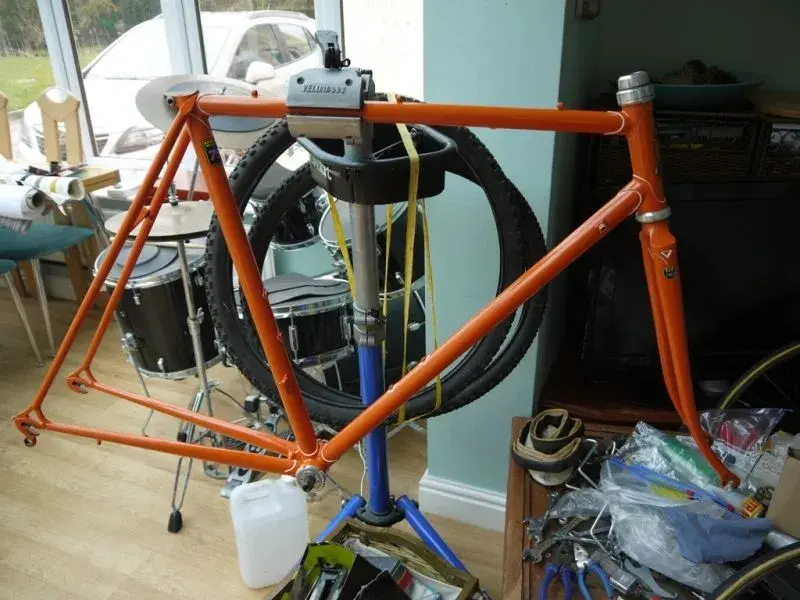

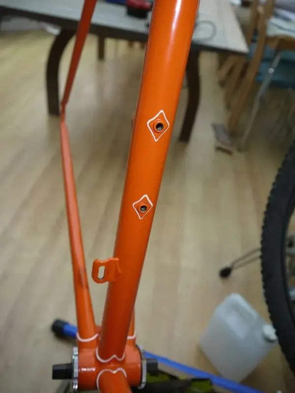

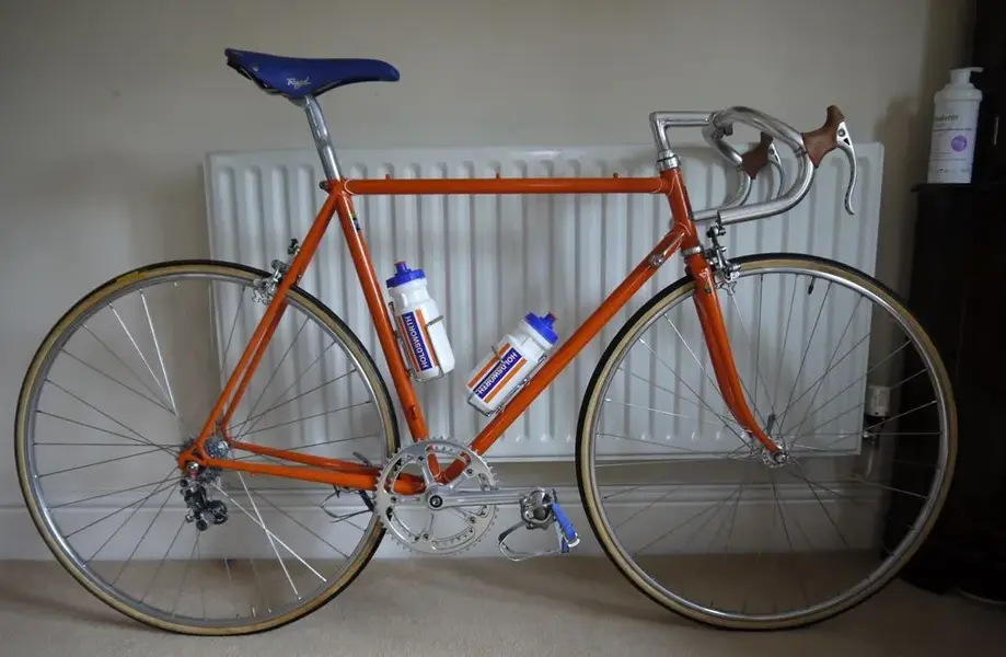

I thought it might be interesting to document my frame+ fork upwards build of this English-built Reynolds 753 frame and 753 fork. Frame and fork came with English/Italian threaded MAVIC 312 Headset and the rare 600RD SSC Mavic BB (116mm spindle, English threaded). It started with the thread here, and a Mavic SSC groupset...
viewtopic.php?f=12&t=381337
.......but this is where the build will be documented and hopefully finished!

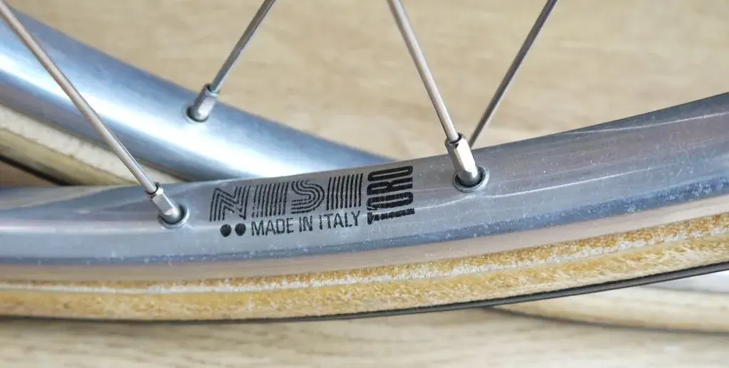

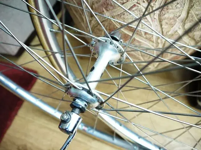

Wheels are Nisi Toro NOS tubular rims, rebuilt by myself and Swallow Cycles in Ironbridge using NOS Miche professional 32h hubs, a Super Record hub copy with oil ports (SC wheelbuilding course-recommended!).NOS Lion GT30 tubular tyres. Regina America screw-on 6 speed freewheel.

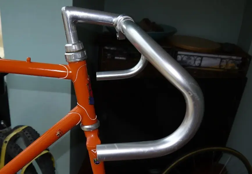

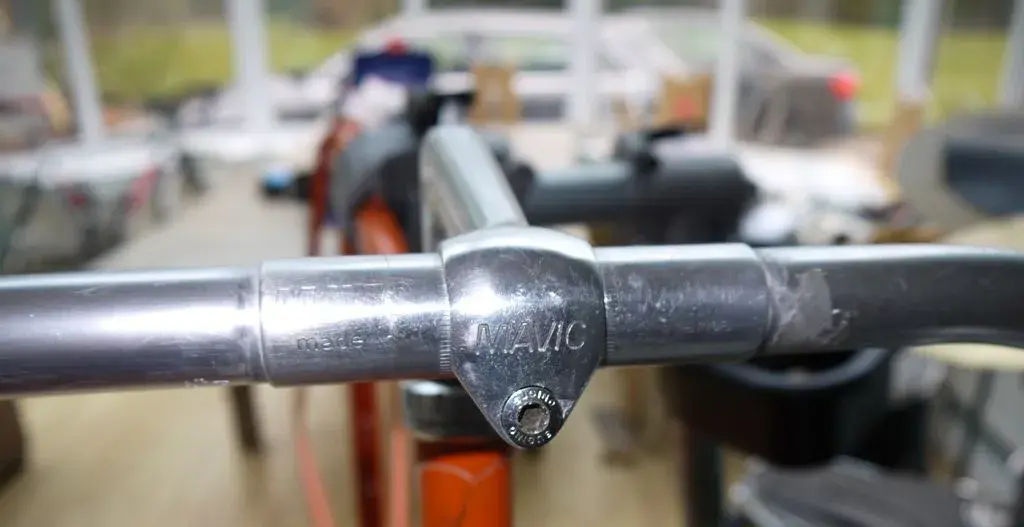

Mavic 360? stem with Sugino bolt (if anyone has a Mavic binder bolt please contact me). These French stems require a 7mm Allen Key for the expander bolt head as based on Imperial size of 9/32".
Mavic 351 handlebars

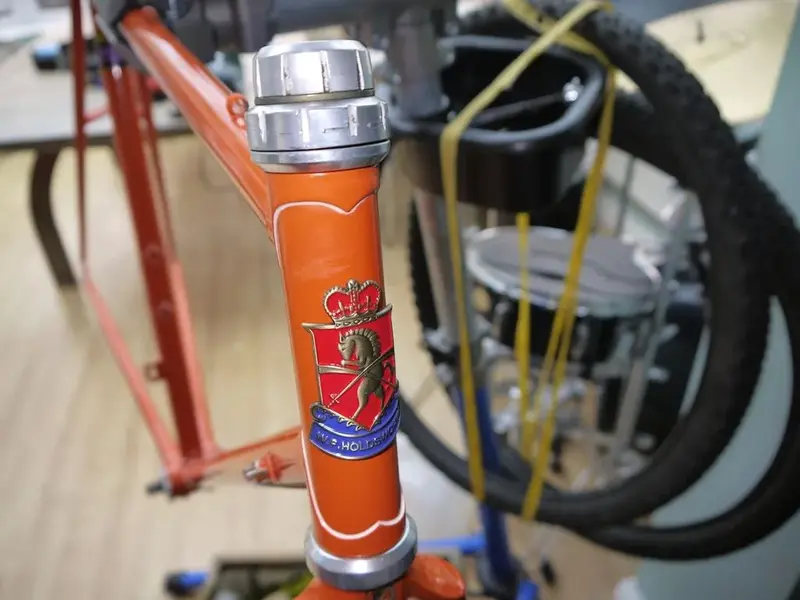

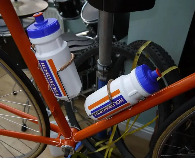

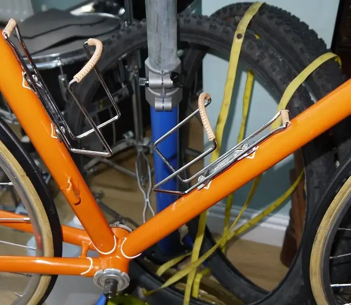

Zefal bottle cages and Holdsworth bottles to match my added Holdsworth headtube badge-do I add matching frame decals.....????

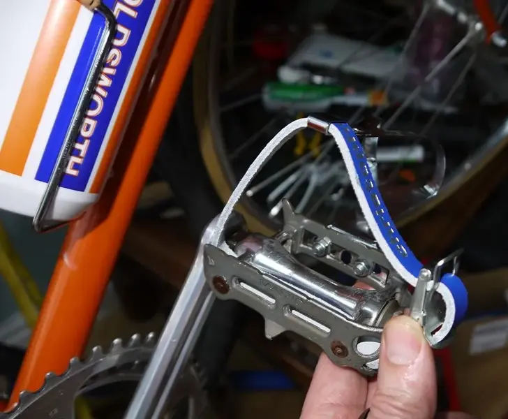

New Christophe cages and leather straps

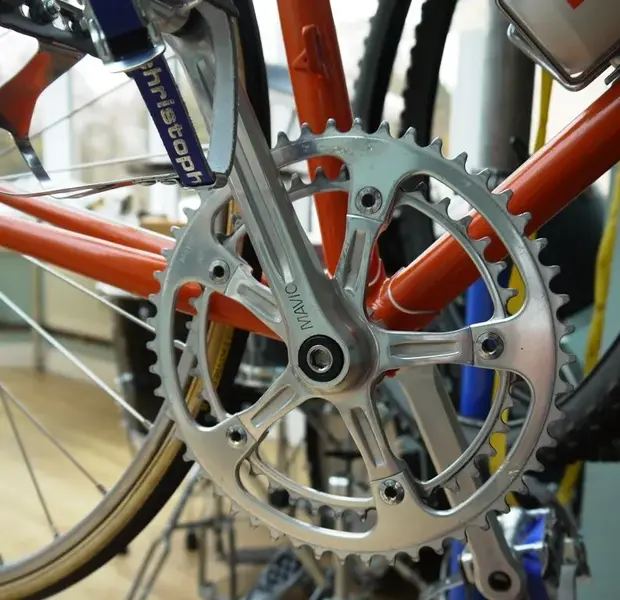

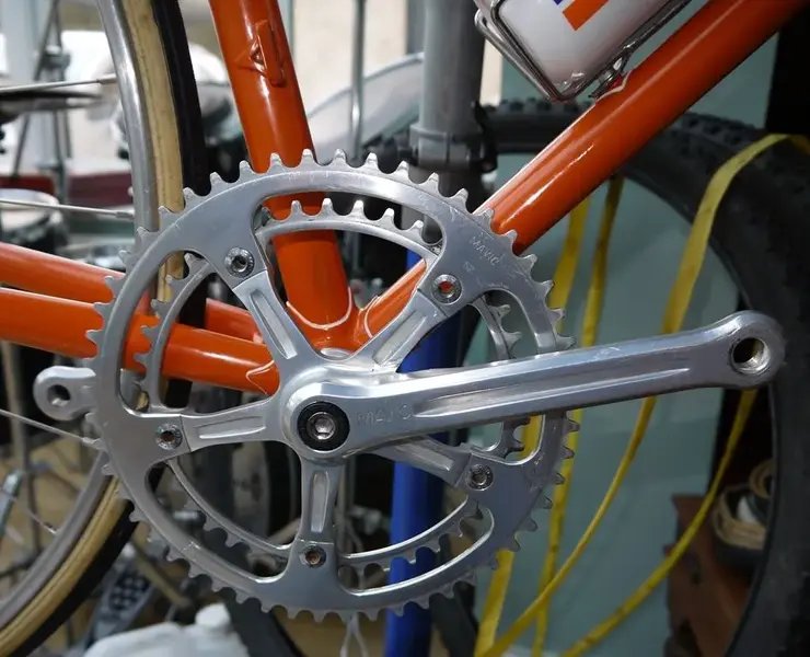

Mavic 630 chainset: cranks and Mavic 52/42 rings

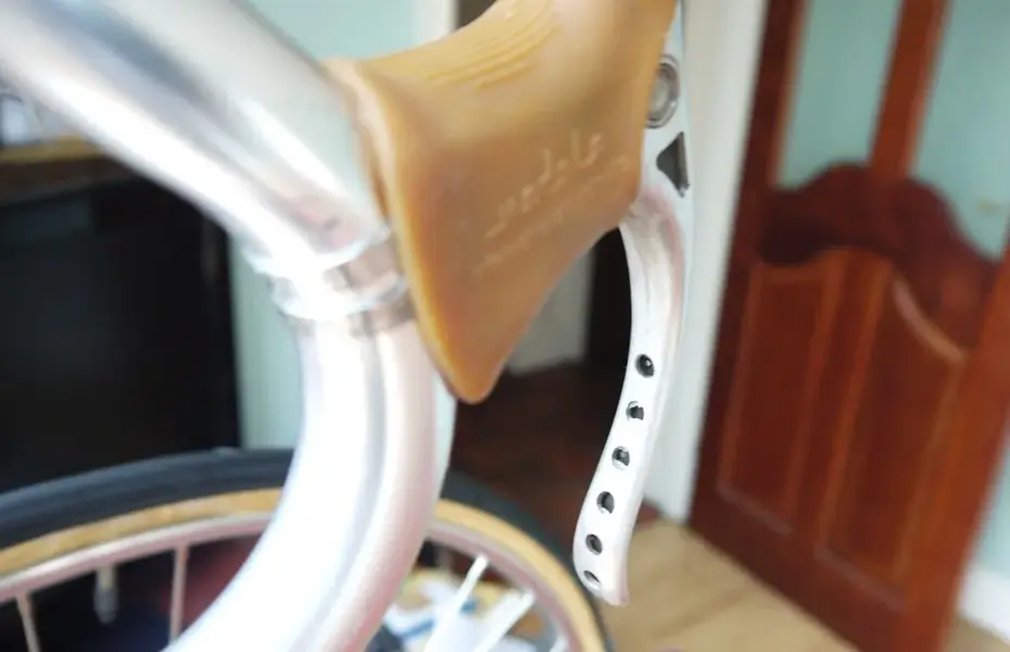

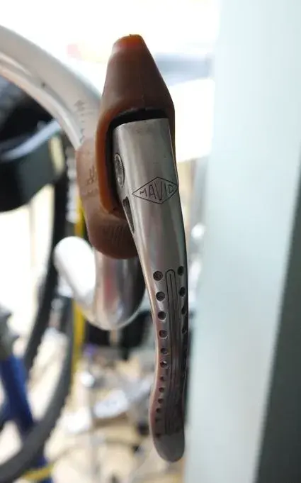

Mavic SSC Professionel brake levers: drilled front and rear, Modolo hoods
Mavic 410/420 Pro levers
Mavic SSC (unbranded but made by Simplex) gear levers

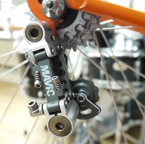

Mavic 851 SSC rear derailleur

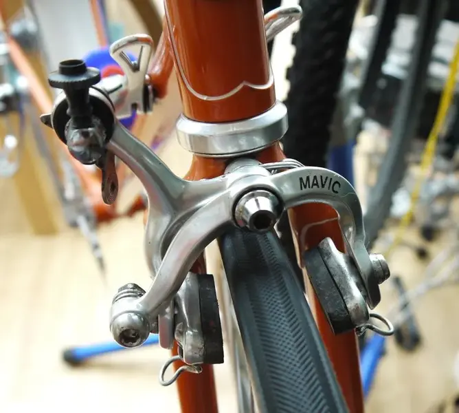

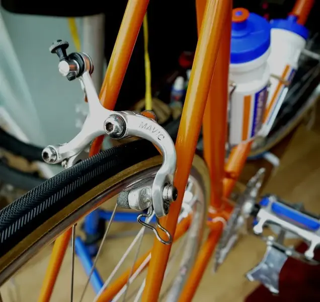

Just needs front derailleur, chain, cables and bar tape to complete...

Midlife wrote:
Smart looking build :). Just trying to work out which Holdsworth it is ? Is it a modern Planet X jobby?

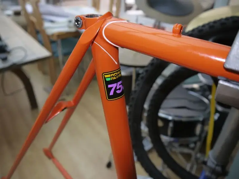

Thanks- it's vintage and original paint & Reynolds decals. Not a modern Mark Reilly- built Holdsworth Reynolds 753 (Planet X). I'm sure some learned individuals on this forum will work out the builder, but let's leave it a mystery for the moment! Is it a convincing Holdsworth!?
Hopefully it's a fitting tribute to Holdsworth who relaunch their pro-cycling team into the spotlight.

Have you thought about changing the 753 decal to the older type?

No Holdsworth decals just a plain orange?
