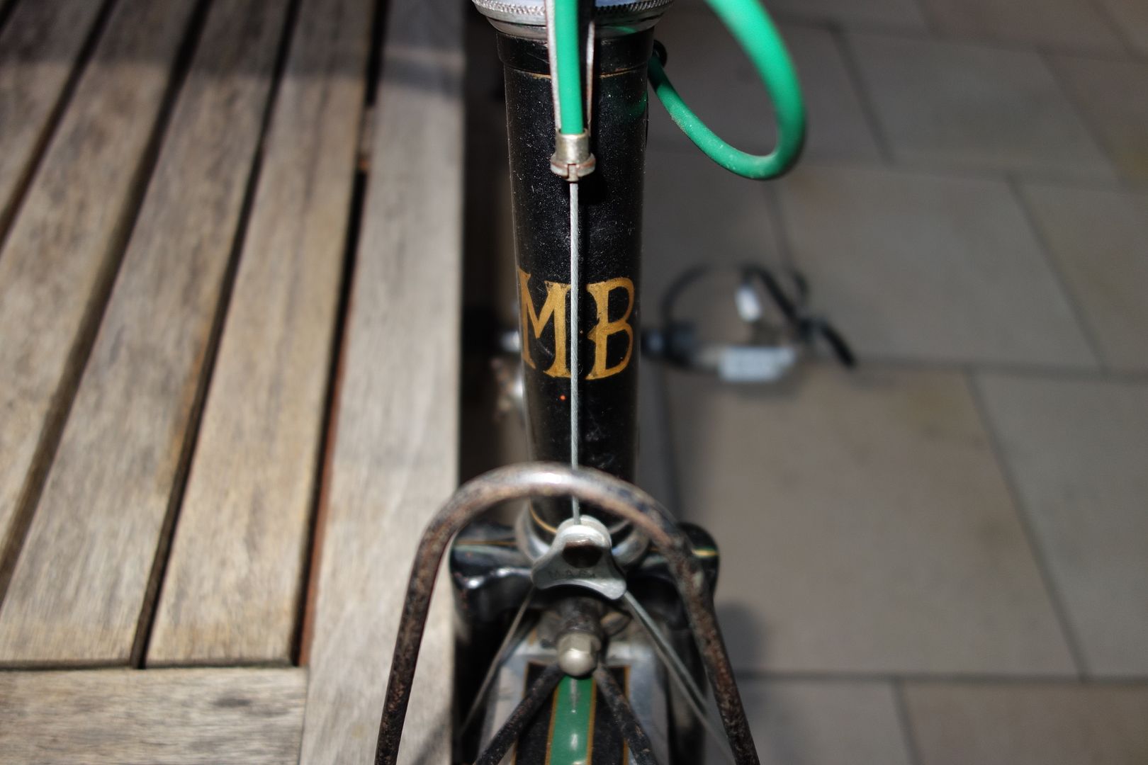

I swear it is , its written on it ! MB in capital letters :mrgreen:
This bike is actually very special.
It sports the most exclusive features of a 1950 high end 650B French randonneuse so is undoubtfully the work of a upperhand framemaker but , alas, is not signed with a full name !
And it has not been resprayed ! And I know its true as I got it from its initial owner who had it built in 1950.

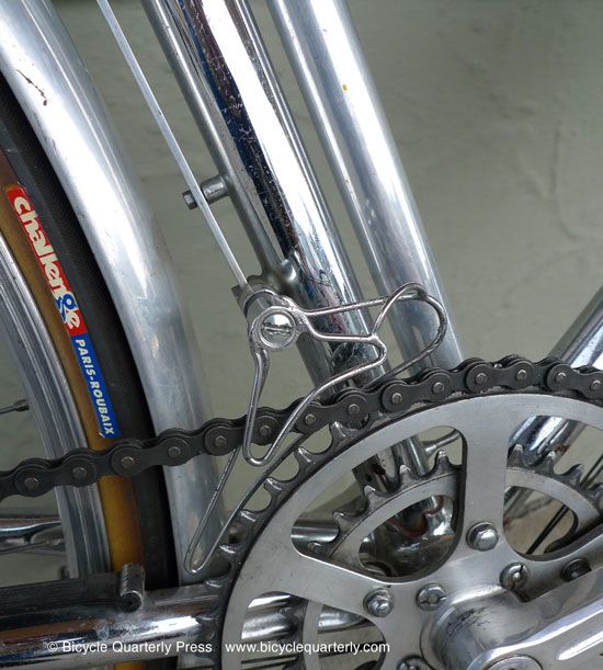

It sports a front derailleur which is undoubtfully a Singer

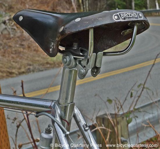

it sports a quill seatpost without frame bolt as a few Singer

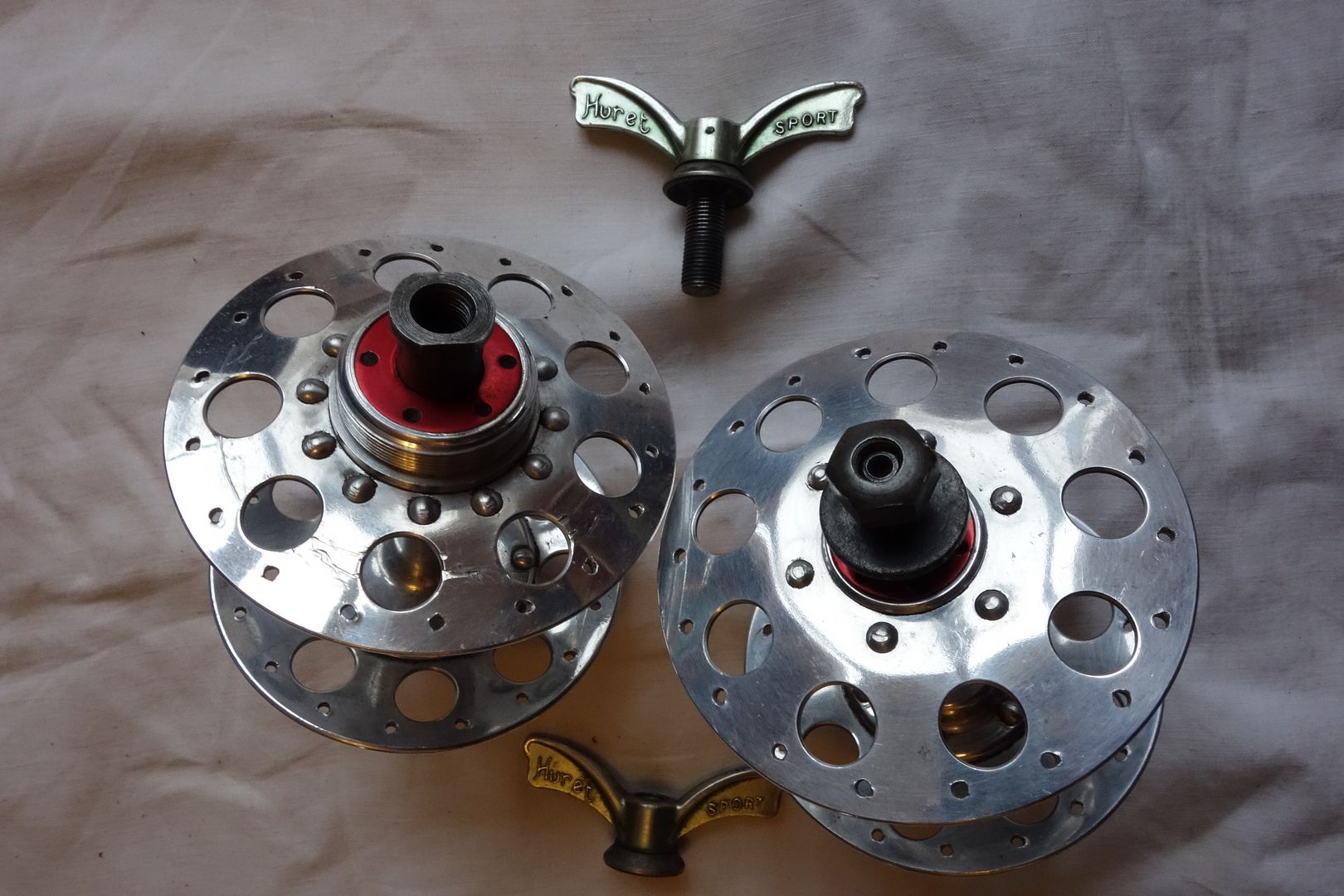

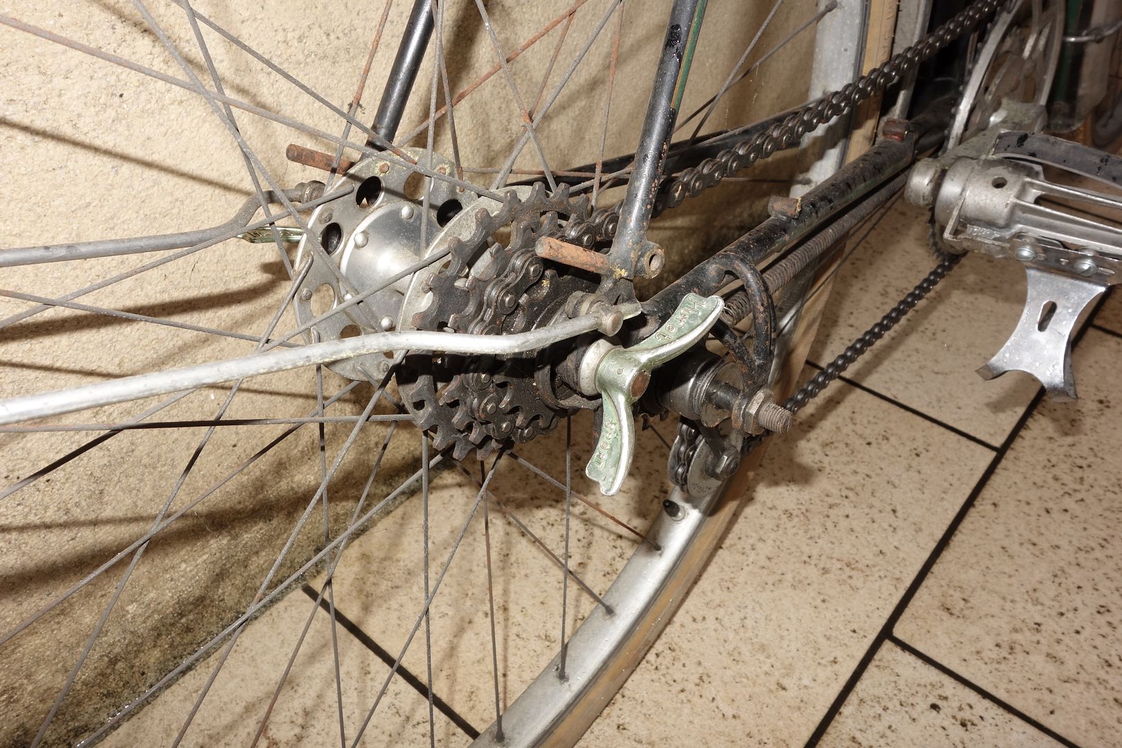

and finally some modified Maxicar hubs, which have been seen only on a few Singer or Herse bicycles.

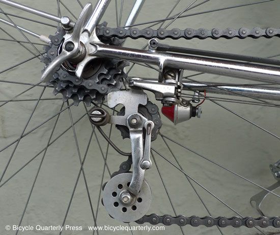

But he more usually had a nivex Derailleur with a support for the chain rather than the cyclo being on this machine
Here the same design for the rear mech and hub as my bicycle but on a Longoni ( another upmarket frenchmaker)
here a Singer with such a feature / Nivex and modified hub, same front mech and quill seatpost ( courtesy Jan Heine)
https://janheine.wordpress.com/2012/03/ ... ng-strong/

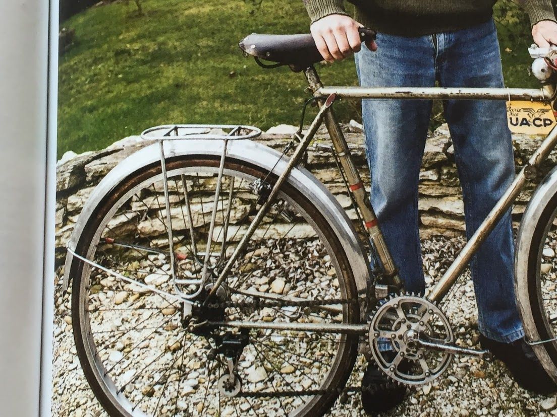

Here a Singer with hellenic seatstays, same crankset, same front mech ( courtesy JP Weigle / Flickr)

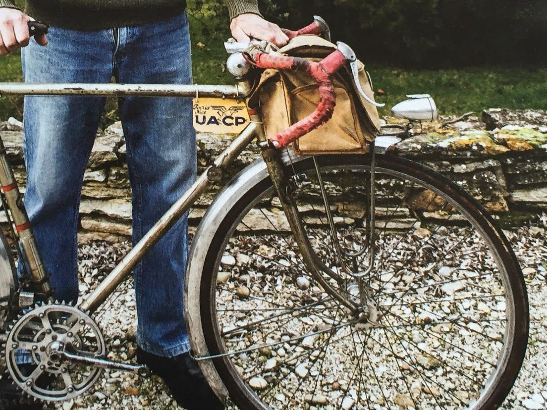

Here a Dujardin with rear nivex , hellenic seatstays ( courtesy 200/ Raymond Henry)

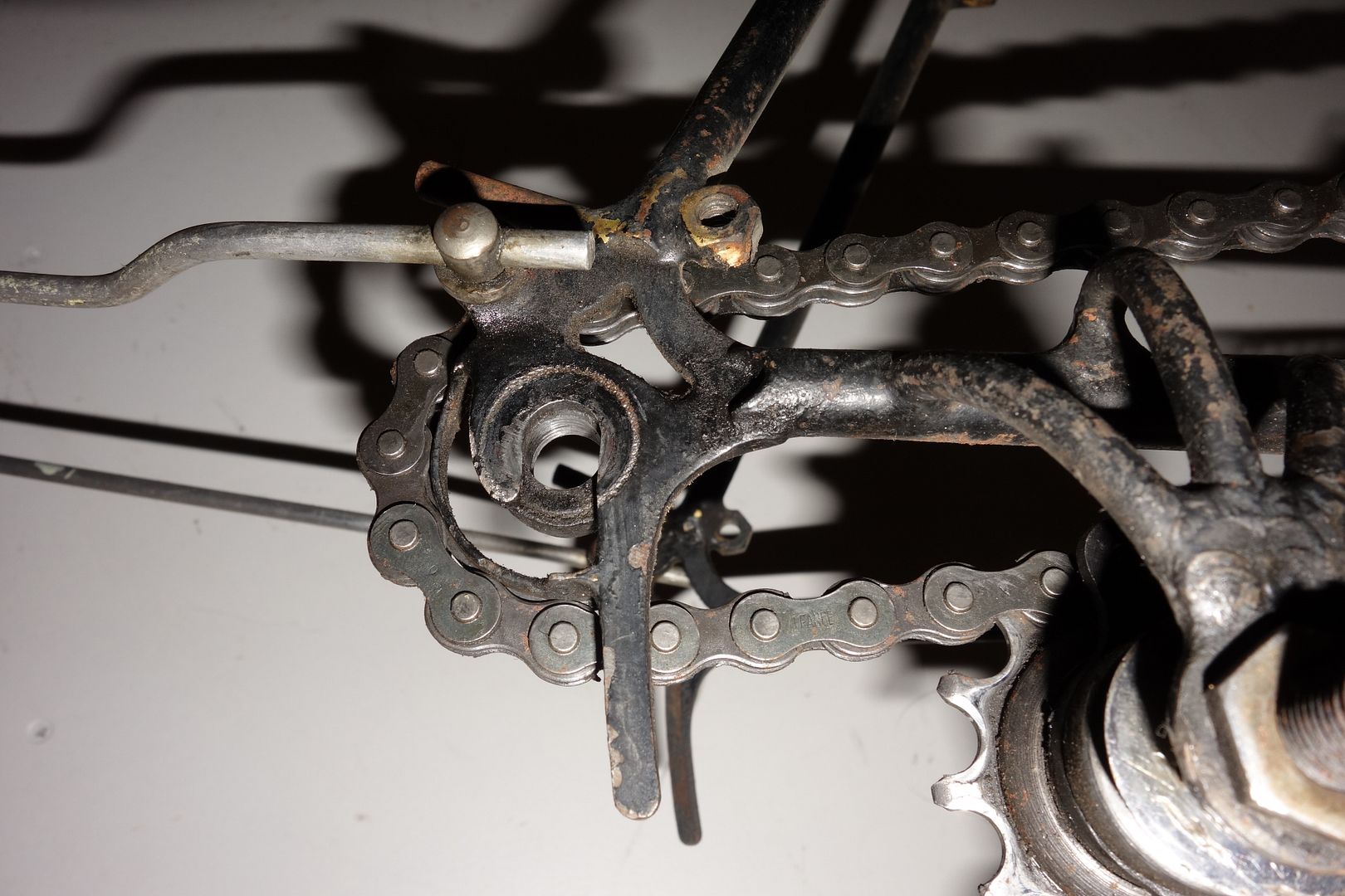

Now a little more details

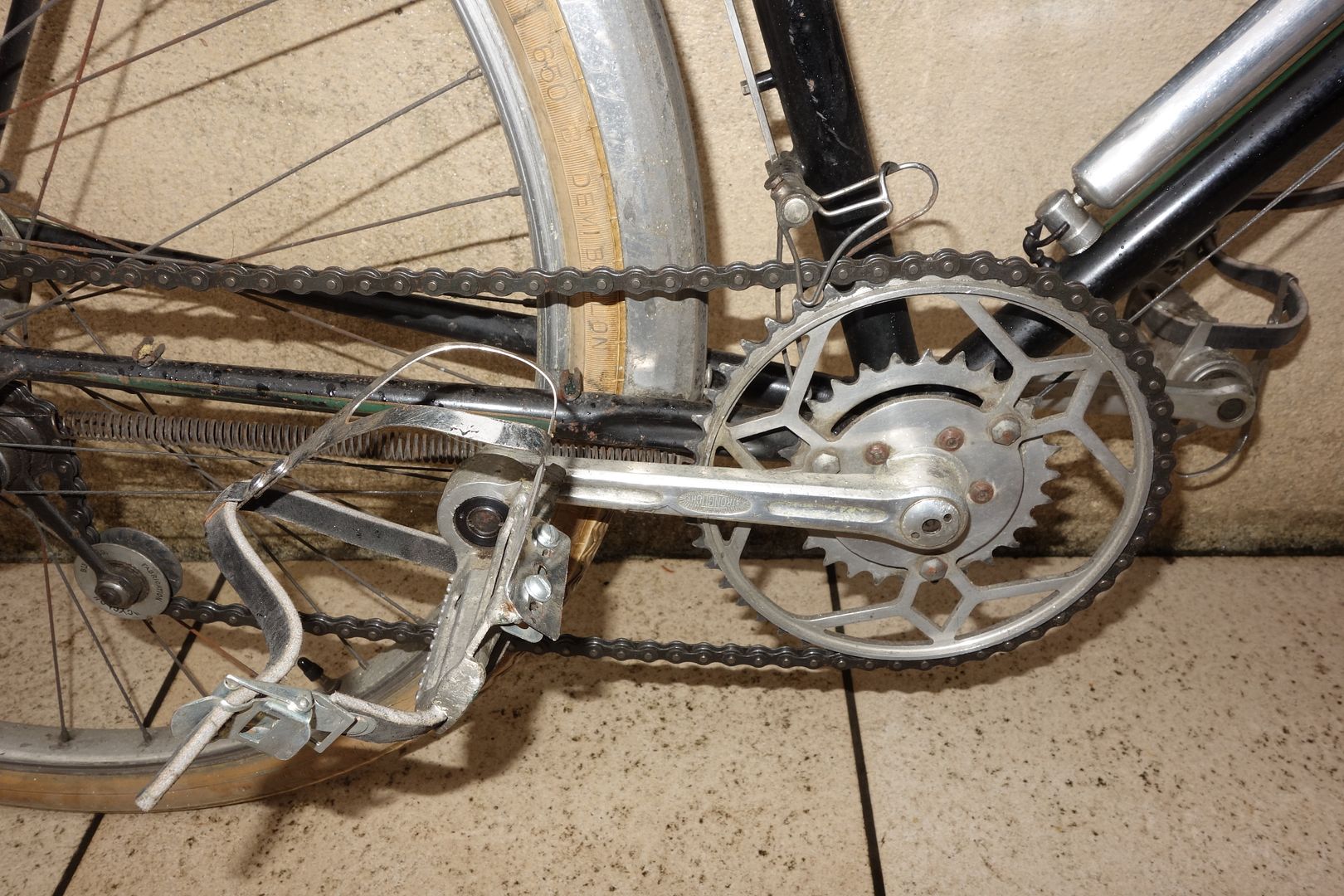

The frame stay is modified with a support for the chain so that the wheel can be taken off easily
as the rear hub is not only a modified maxicar but also one which has a right modified side, so that the screws into it and it is much easier to undo the rear wheel.

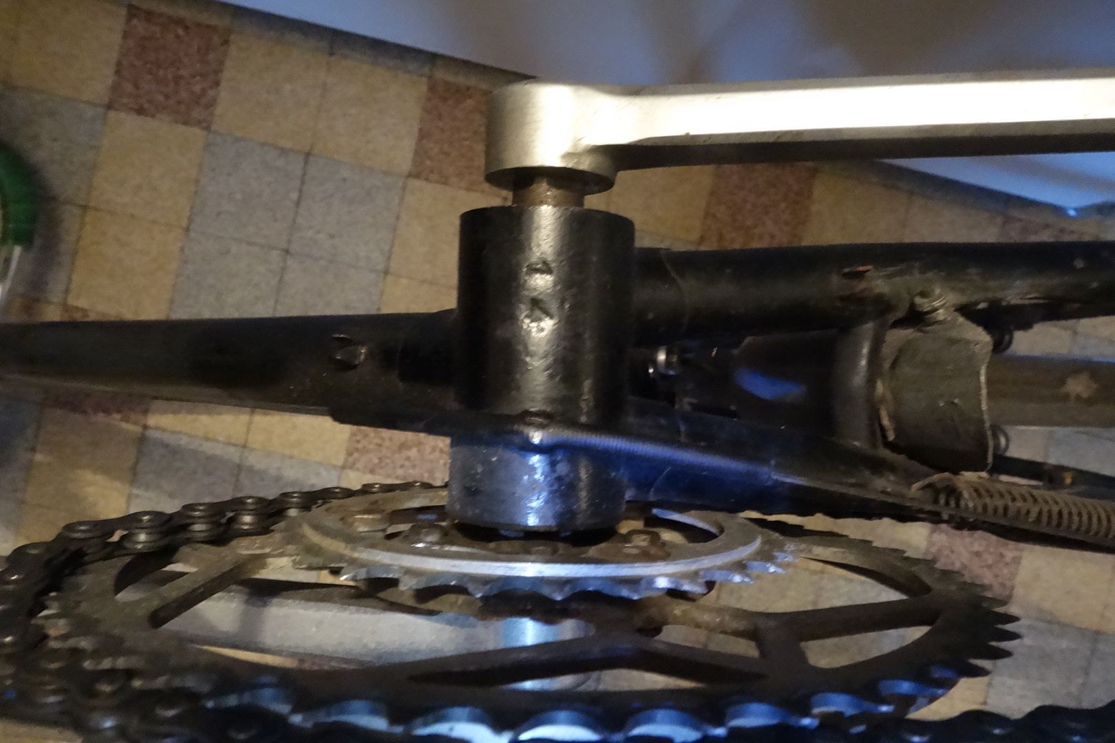

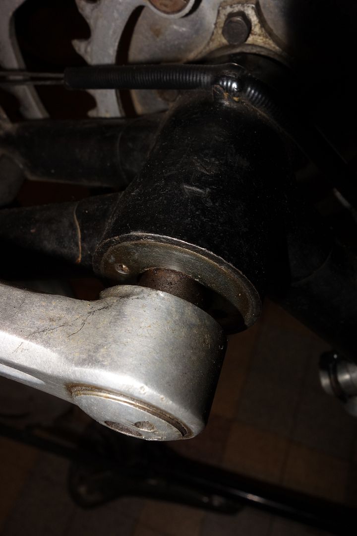

The bottom bracket is again special as its an annular bearings one

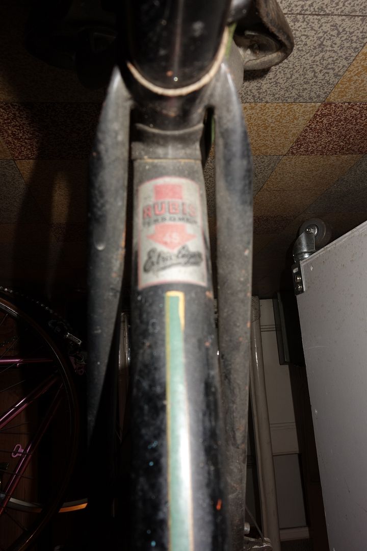

The tubing is not the usual high end Reynolds 531 one, but a french RUBIS Chrome 45 Extra Leger

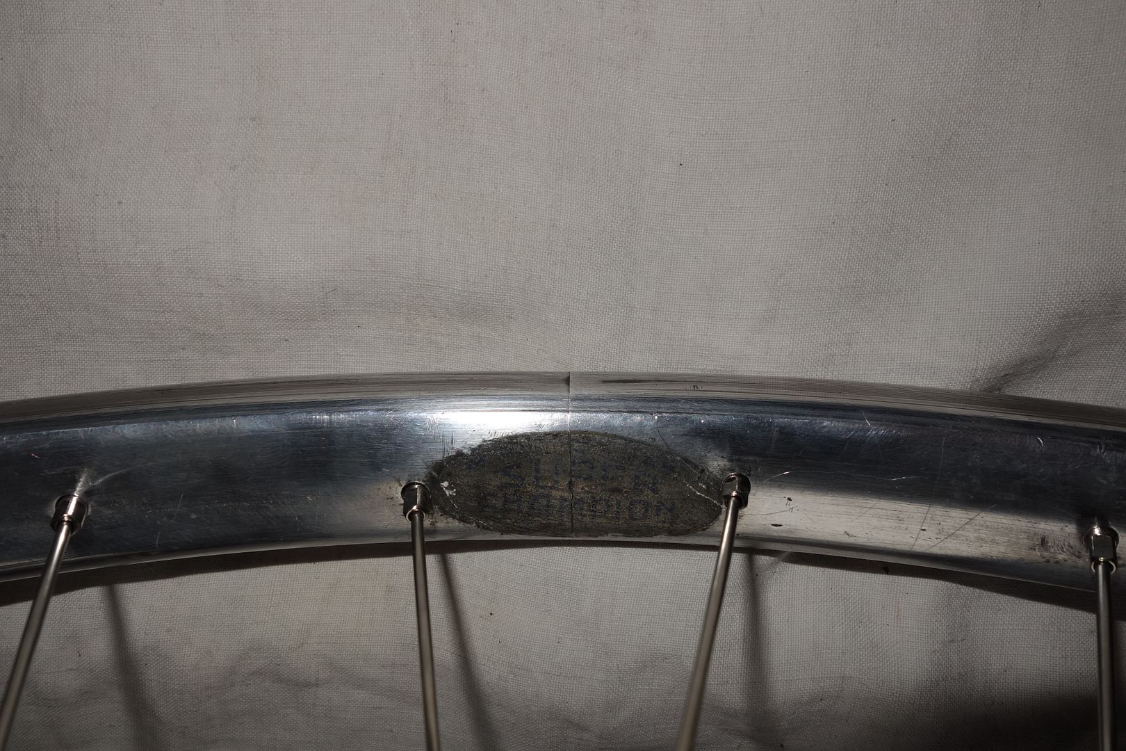

The rims are 650B Super Champion (blue sticker) found on most of the high end bikes

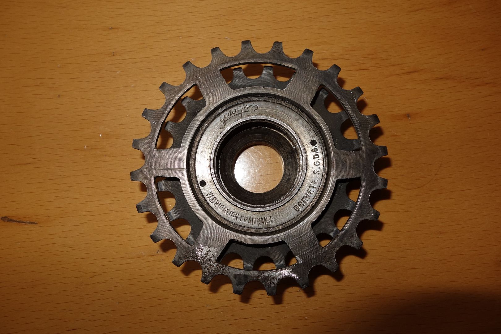

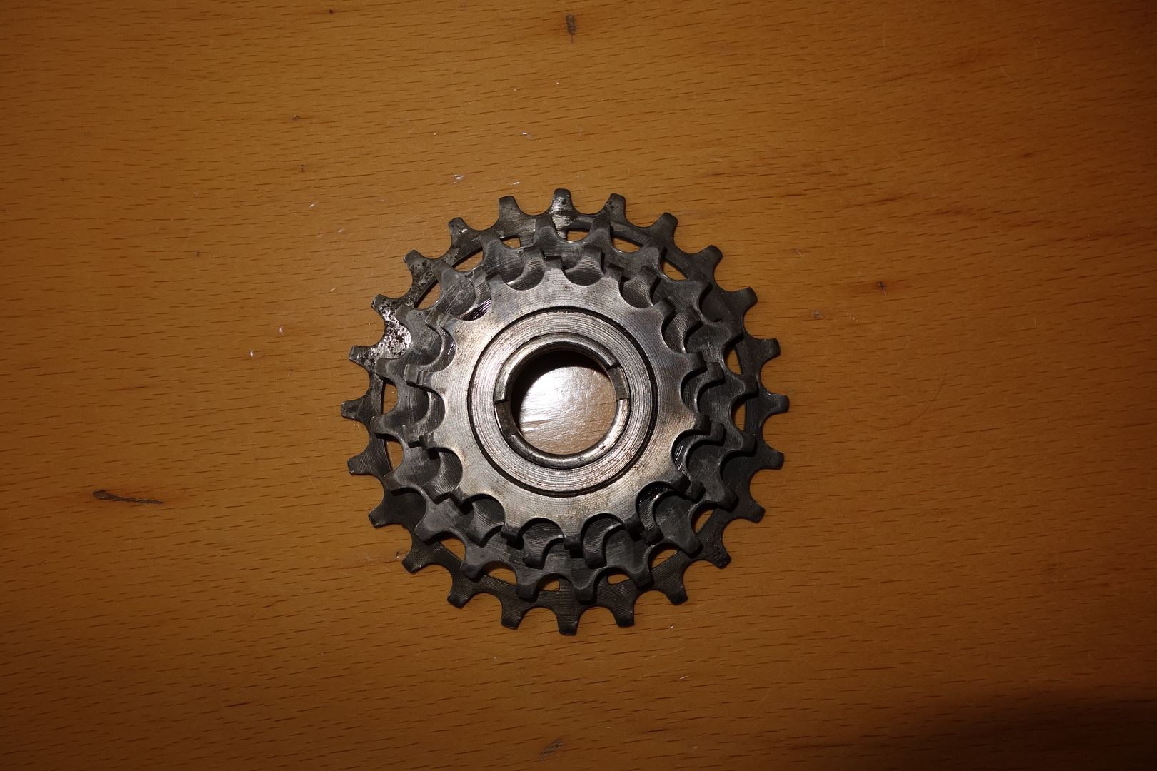

Freewheel is a French 4 speeds Moyne
