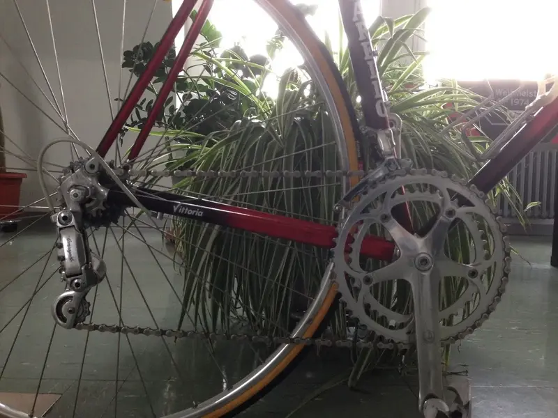

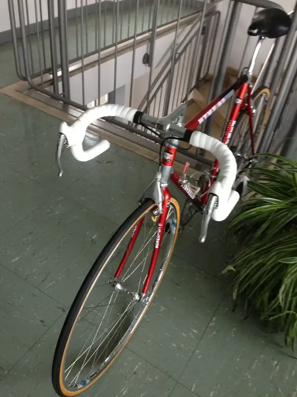

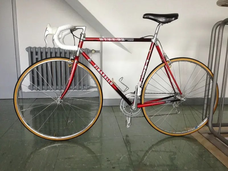

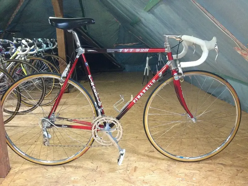

hi - here is the 2nd piece of plastic of Technique du Verre Tissé from Lyon - know as TVT
Sorry - but I love this French TVT92 bikes
This time the base was a early TVT92 Carbone frame set in "rouge", which I had gotten from an
older cycling enthusiast and classic bike collector
Refer to the my principle that every bike within my small collection has to refer to a former PRO-Bike,
I intent to build it up as a replica of 1988s Pinarello labeled TVT92 Carbone.
This PRO-Bike Replica has equipped similar to Delgado's 1988s TdF Bike
frame set: TVT92 Carbon, red-carbon, size 56 cm
forks: TVT originall, carbon-steel 1 inch
headset : Campagnolo C-Record 1 inch quill
handle bar 3ttt Eddy Merckx, 440 mm, silver
stem: 3ttt Record 84, 110 mm, silver
tape: Velox, white
seatpost : Campagnolo Record Aero 25.0 mm
saddle : Selle Italia turbo
brake levers: Campagnolo C-Record, white/grey
brake calipers: Campagnolo Delta 3rd Gen
crank set: Campagnolo C-Record, 53/42z
bottom bracket : Campagnolo Record 1,37 x 34T English
shifters: Campagnolo C-Record, friction
rear derailleur : Campagnolo C-Record 1st Gen, 7-Speed
front derailleur : Campagnolo C-Record
cassette/cogs: Campagnolo 12-23z
chain : Campagnolo classic
pedals: TIME Criterium TBT
rims: Campagnolo Sigma Strada chromix 36 holes, tubular
hubs: Campagnolo C-Record
spokes: DTswiss
tires: Vittoria Corsa SC tubulars (retro)
bottle cage : T.A. Specialites, white
weight 8,7 kgs

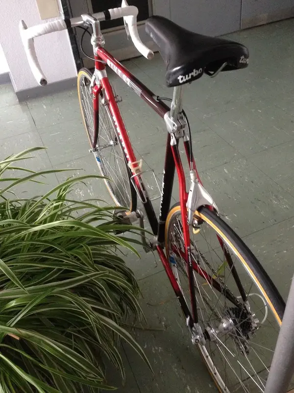

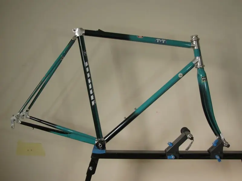

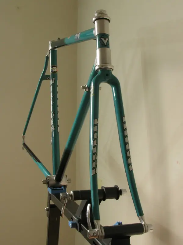

Yes indeed - I got the green frame set for my first quote. The seller had been the same Intention to build it up with a
Suntour Superbe Pro, but he has not enough passion to collect groupset, so he sold the framse set to me. It's in really good conditions a perfect base of the Suntour Superbe Pro PRO bike replica Project.
The groupset is nearly complete, only a Suntour Superbe Pro SP-SB00-L eatpost in 25.0mm is missing, but can substitutby a Taiwan retro looking Kalloy. Now I am looking for a corresponding jersery (see my Wanted -Thread) and for someone who interesting to produce the missing Stickers, ecpecially the Villinger for the down tube.
But remember our conversation about the painting - I think they couloured (not painting) the carbonfibre green too.
sorry I haven't no other pics - they are from Franjo
PostPosted: Sat Mar 14, 2015 5:54 pm
Joined: Mon Jan 02, 2012 8:59 pm
Posts: 1158
Location: Isle of Wight
Sorry No I disagree the frames were sprayed what ever colour & then lacquered. Just look at the Lemond ones! no way is the carbon coloured.

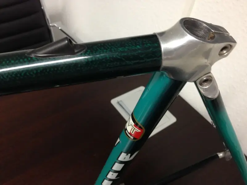

...and what do you think about this here? For my opinion it's couloured carbon fibre
PostPosted: Sat Mar 14, 2015 8:06 pm
Posts: 1158
The Green on the seat tube & the rear Seat stays Is Sprayed on Paint.
Maybe the Lacquer is tinted Green? or maybe the gel coat is coloured.
Look where the paint / lacquer is is chipped & you will see black underneath.
I've had well over 20 of these throughout my hands as I used to sell them new in the shop. Plus I've never seen a coloured piece of carbon even in the factory here on the IOW where the stuff is manufactured, its always been black.
But I will ask a few of my friends that work on the manufacturing at SP Systems / Gurit & get them to check if they now make coloured carbon. as these frames are 25 plus years old.
PostPosted: Sun Mar 15, 2015 7:32 am
Joined: Mon Jan 15, 2007 12:12 am
Posts: 1607
Location: Gold Coast Australia
it is all paint , gelcoat is a completely different product usually for styrenated resins (eg polyester and vinylester laminates), it is tinted clear and solid colour on the carbon/epoxy tubed Helvetica
