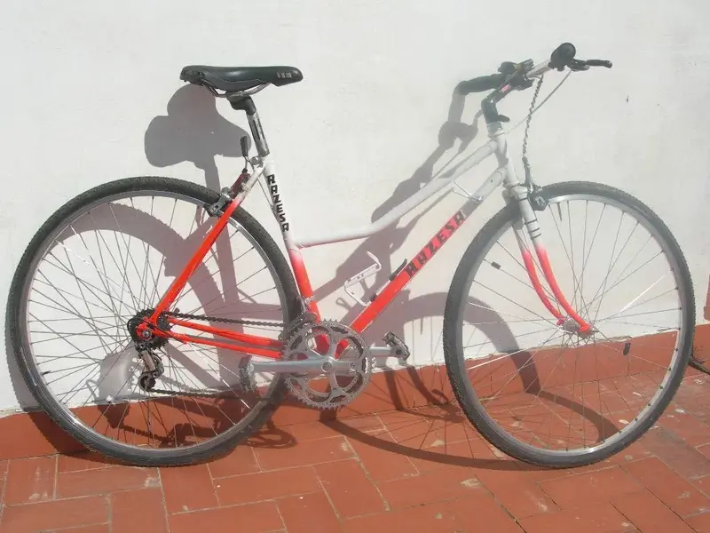

After over a year of on and off searching, yesterday I finally found a bike that I liked, and is the right size for my wife. Advertised on a local pinkbike equivalent, I phoned in the morning, and picked it up after work yesterday. I don't want to hang around with this one, first because it's a secret (she knows nothing!), and second because I'd like to get it up and running in time for the summer.
First job is getting the frame stripped and taken to the painters - the current paint is very funky in an early-90s fluo kind of way (it looks red in the pic, it's actually fluo orange!), and while I quite like it, it's definitely not right for what I have in mind.
Here's a quick pic to be going on with!

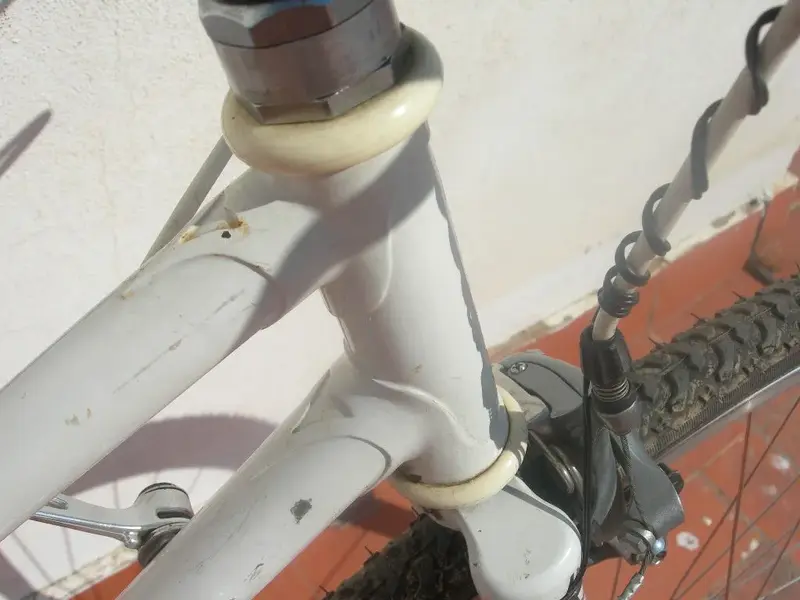

How much are they asking/going for Shaun? They're nice frames, nothing amazing but very decent all the same. I've come across the first problems with thus build already - Zeus 16mm crank bolts, but with a standard 22mm extractor thread. So I need something to fit before I can get the cranks off... Also, the fork dropout slots have been filed deeper, theres still 6mm of material left at the thinnest point. Will post a pic later. I think I'll find a local welder to add a bit of material back again, then file them smooth before painting. My lbs knows a guy who can do it.

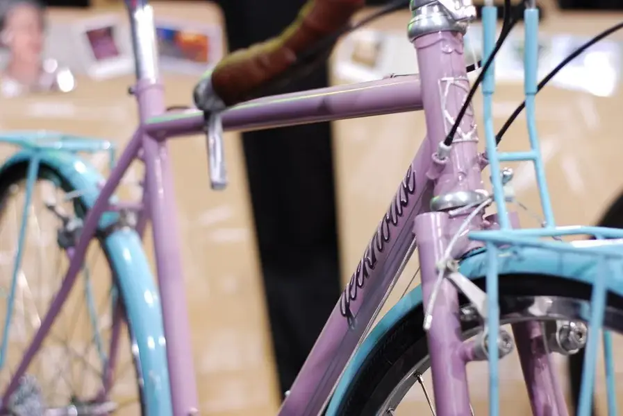

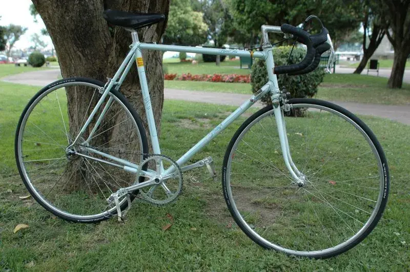

And while I try to get hold of one, I'm trying to think of ideas for the paint. I'm thinking of a single colour, preferably with white decals to keep it "light". Something "feminine", but not "girly". I quite like the idea of lining the lugs with a contrasting colour, or maybe white, to go with the decals I'll be making.
Here are a few pics of random bikes with colours that I think might suit the bike - opinions and other suggestions are more than welcome (but I promise not to ponder as much over the colour of this one as Richard is over his Rossin :lol:)
quick pic of the headtube lugs included too! (first pic)
