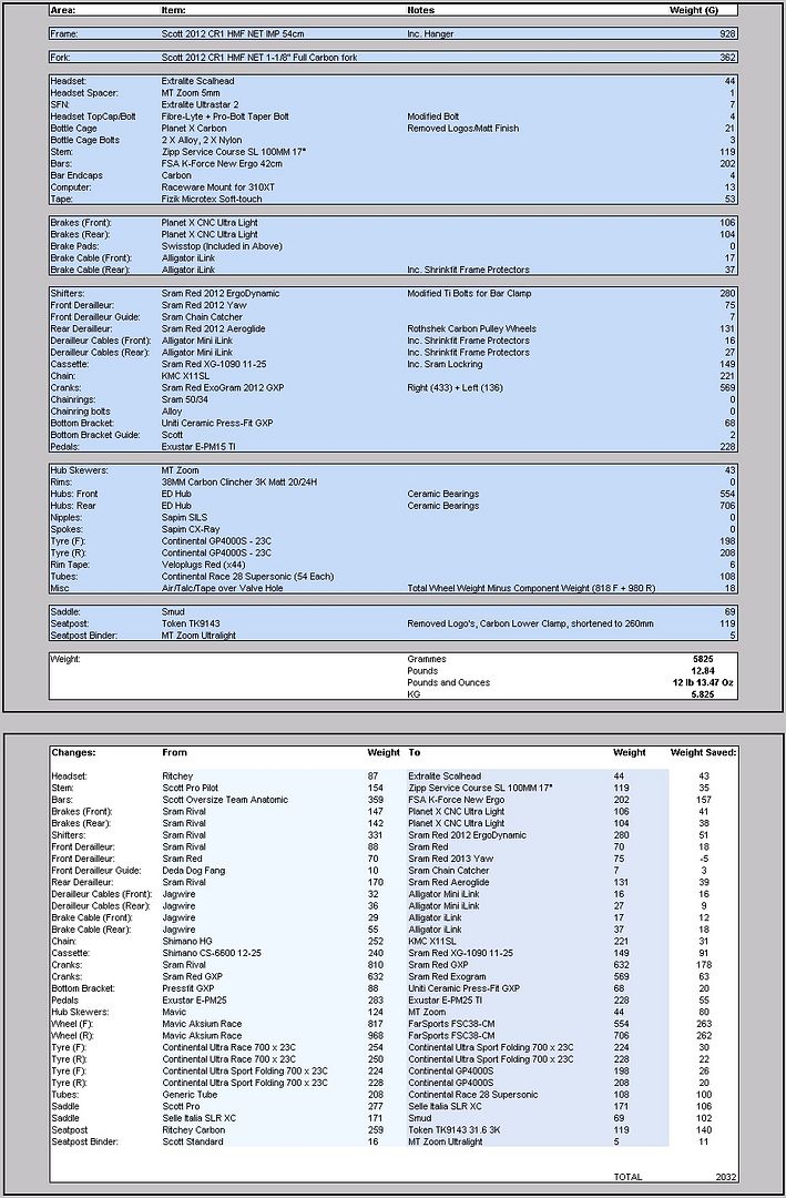

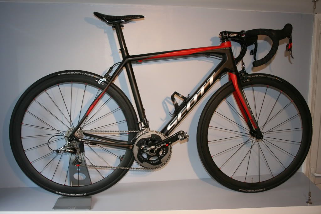

My Winter Project, the re-build and lightening of my previous Scott CR1 Elite, want to go sub 13Ib, which I managed to achieve with room to spare.
Had a few short rides on it so far, but still bedding in a few components but otherwise very happy with the bike, it feels amazingly light and quick to accelerate.
Potential future updates:
-Pedals -> Bebop Chromoly (with Ward Ti Spindle) approx. 147g
-Stem -> Extralite RoadStem OC approx. 81g
All weights on the build list have been verified when the build was in pieces.

That looks great, I really like the CR1, and in stealth black it looks fantastic.

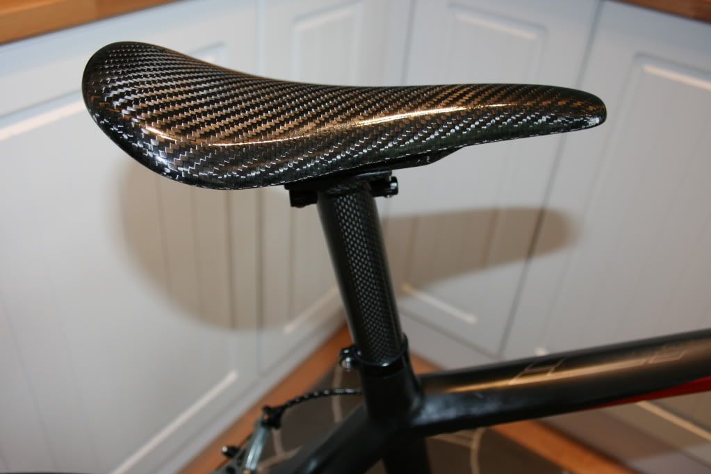

About that saddle though :shock:

Smud Saddle:
Takes some getting used, I found you need to get a perfect alignment from the curve of your saddle and the curve of your bum and then it transforms from OK to super comfortable.

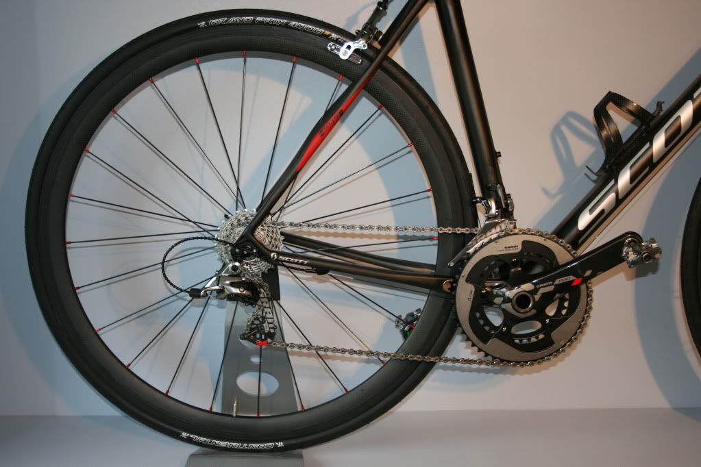

Seat Clamp:
For something that weighs 5 Grams, it has only just passed the test, I have had to re-apply carbon paste, put some tape on the inside to make the clamp bigger as it was bottoming out on itself and overtorque it to get it to clamp it tight enough, anymore issues and it will be binned.

Everything is still smooth and fine, has no issues and the wheels are amazing for the price!

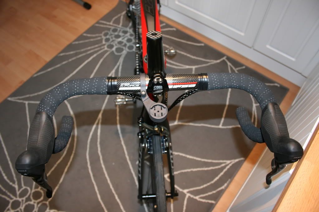

Just updated to Speedplay Ti Pedals and a TillQuist Garmin Mount for Zipp SL stem for a new weight of 5754g/12.69Ib's.
