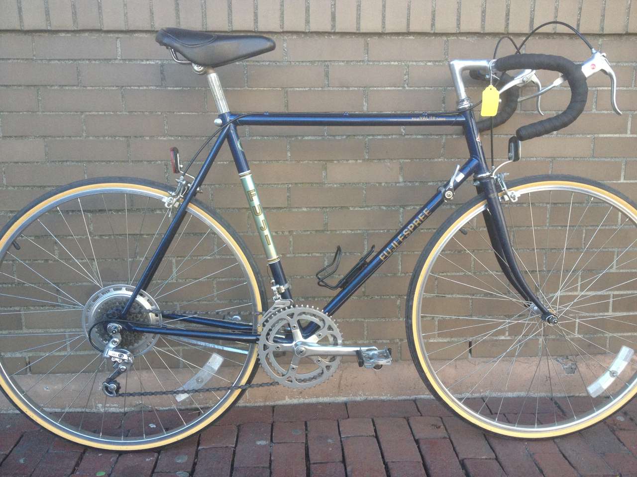

Here are mine:
Knew i had seen this type of fork before. The bike fits the bill for a Fuji Sports 10 apart from the 3 braze on cable guide..... Can we have a pic of the front of the head tube?
There looks to be a big gap between the 5th cog and the frame. I would say there's a spacer in there that's to wide. Fitting a smaller one looks like you could shift the wheel centre over 1/4+"
The fact that its so far out would suggest they are not the original wheels.
