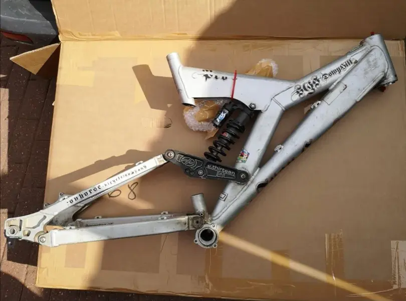

Let's get this DH beast rollin' again! Going to do my usual strip down and re-powder coat job and replace the pivot bearings etc. Not sure what spec to build it to yet... Period, trick or budget?
Since purchasing the frame I've discovered it runs a humongous 165mm rear hub and a 100mm BB shell. I don't know anything about rear wheel geometry and stuff like that but I'm assuming I could run a superboost rear hub with spacers? Then I may need to space out the rear caliper mount to suit?
Any tips on 100mm bb's?

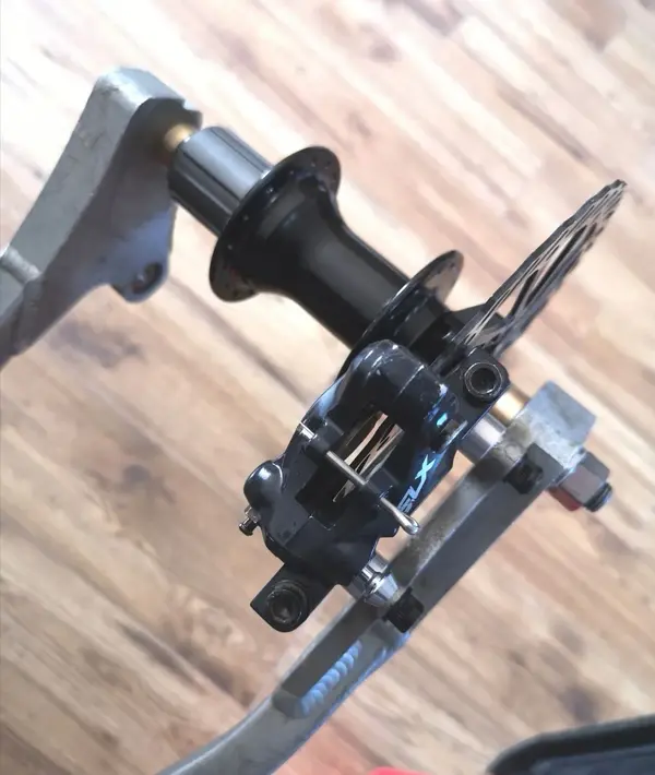

Been working on a solution for the odd hard to get 12x165mm hub by spacing out the back end to work with a 150mm hub. Pretty straight forward .
In the meantime I managed to find a company in Spain that carries new 12x165 hubs. So if there are any Tomac or SGS riders looking for a new hub Google MSC bikes. They have loads of odd sized hubs available. No idea on quality yet....

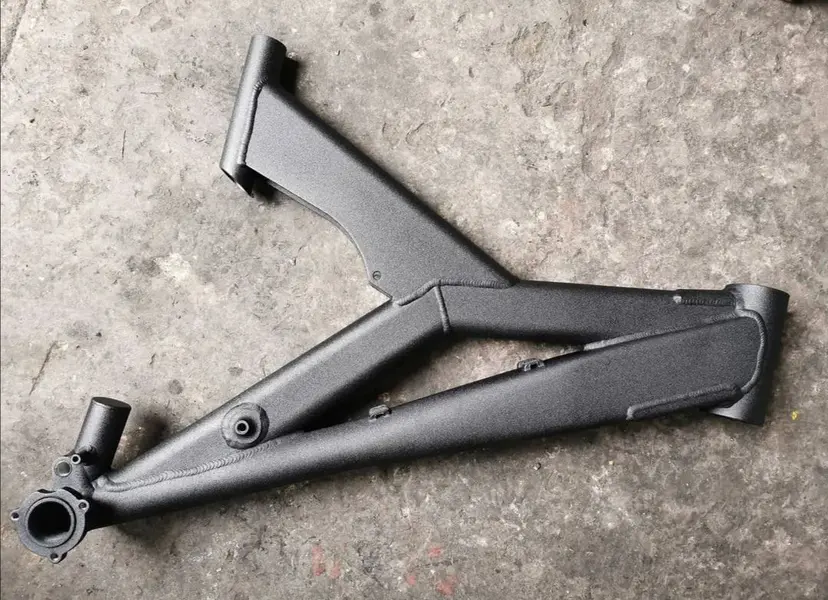

The frame is finally back from metal finish masters powder coaters. Went for something a bit different, a textured Matt black. Rear triangle is silver.
Looks well. Have an uplift booked for Sunday so it's time to cross my fingers I have all the parts and it all fits together and get it built.
