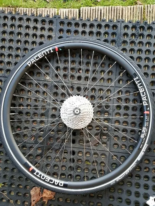

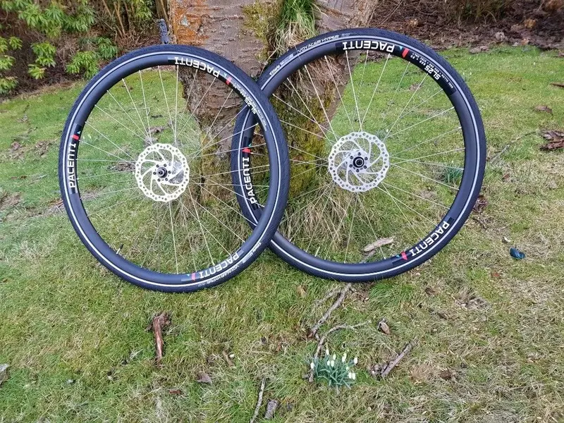

First up were the wheels... Pacenti SL25 on 32h Hope Pro 4 hubs built with ACI Alpina DB spokes (2.0-1.7-2.0). Build up very easily and look great except when you look up close at the Pacenti stickers which are really thick, cheap affairs.
File comment: Pacenti SL25 on Hope Pro4 with Vittoria Voyager Hyper

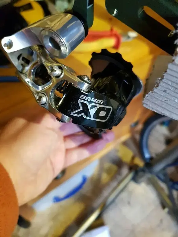

The solution for me is 10 speed SRAMpagnolo - basically, a full Campag groupset with the rear mech swapped out for a SRAM one... Which, in this case is a mint condition shiny silver X0 long cage from eBay. It's an absolutely gorgeous thing which is a first for me to say about SRAM!

I've read that the long cage sram mechs play well with the sinrace 11-40t cassettes if you needed a bit more
