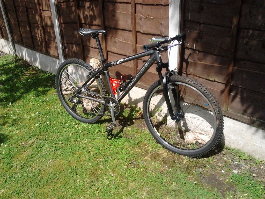

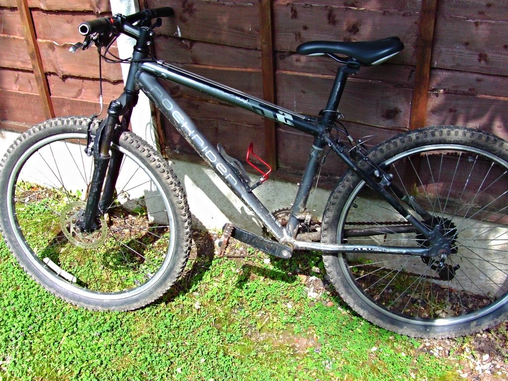

Well i bought this in it's current condition cheap off ebay last year and i just want to get it road worthy again for now but i will slowly get better parts for it as the year goe's on :) .
All components on the Rock Rider appear to be original and as you can see the bike has had some serious abuse by it's previous owner but i will br getting it working again this week hopefully and parts will be a mix of old and new lol :p .
Rear wheel and front have serious wear on the rims with both being buckled but the rear is worse off with a bad split and the rear mech and pedals are trashed along with the gear leavers and tyres are scrap to so you get a general idea of whats to be replaced so far and although the frame could do with a new coat of paint that's on hold possibly till next year :| ..

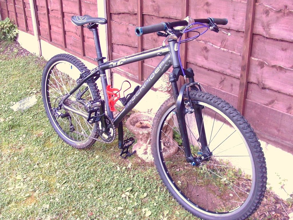

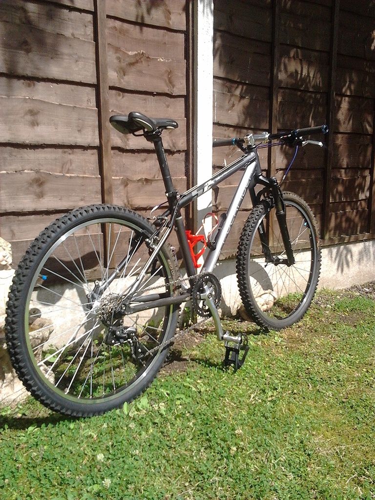

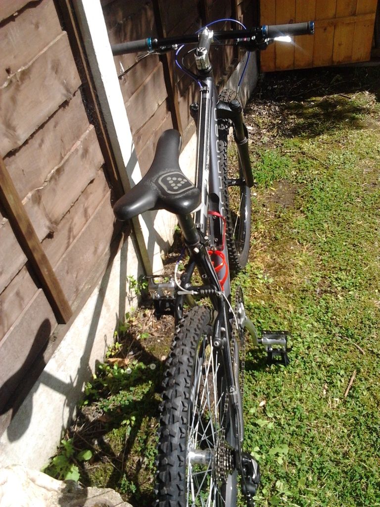

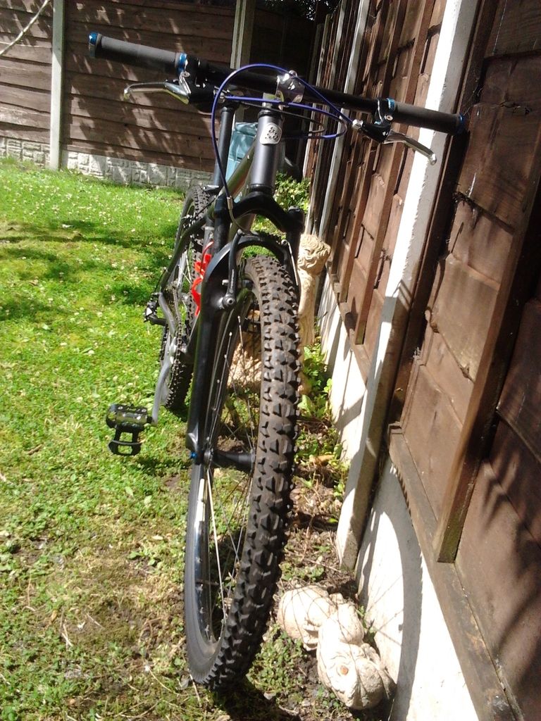

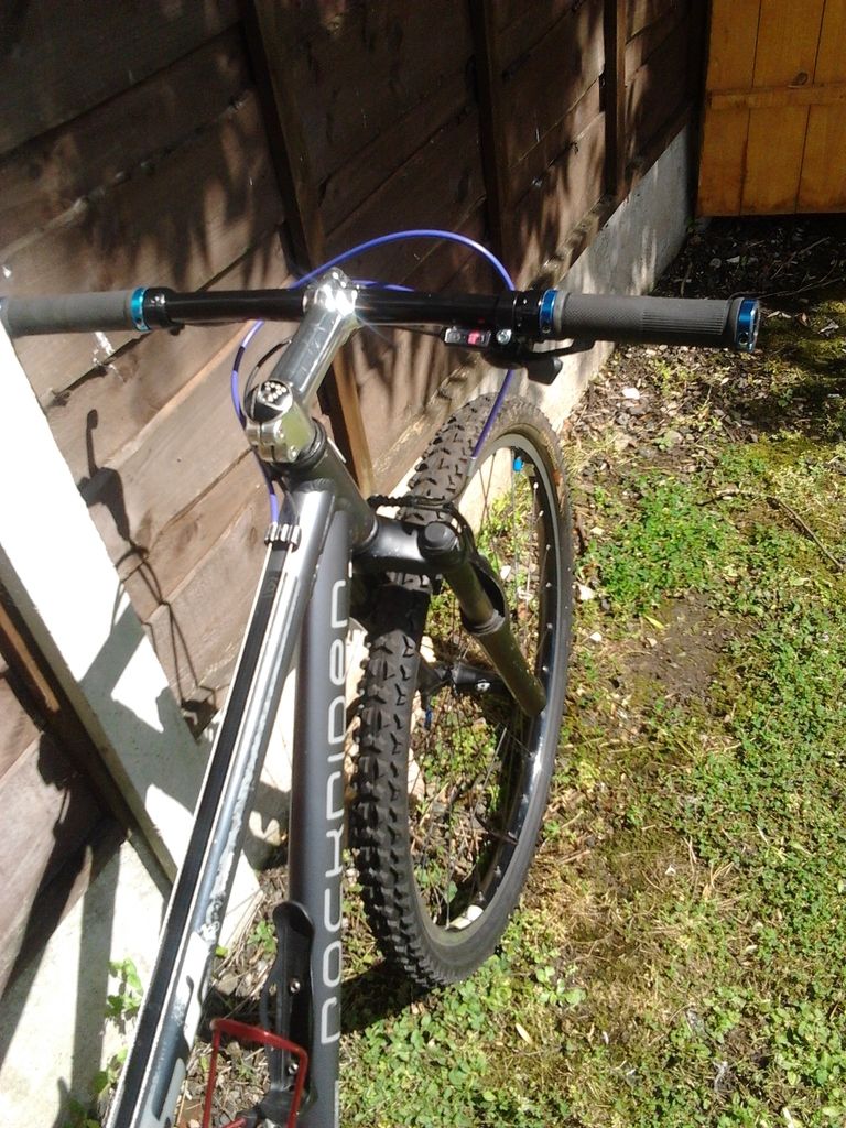

Well this is how she stands atm and although she is initially completed i haven't finished fully as i need to gain a bit more room in the cockpit area as it's feeling a little cramped and i've already moved the saddle back as far as i can without putting it under any unwanted stress so any help or suggestions would be hugely appreciated and excuse the pics as i struggled to get the camera to agree with the daylight :facepalm: :lol: .
Parts list .
Handle bars black 600mm riser Barelli 31.8 AL2014 T6 butted .
Brake levers 2 digit Honga off previous bike .
Front wheel Karma Bontranger off Liam .
V-brakes original rockrider .
Rear wheel Shimano nexave silent clutch 7speed cassette hub .
The rim is Cyber 10 .
Shimano hyperglide 42 tooth crankset .
Cassette is 7 speed Shimano Hyper Glide 41, 28 x 11 toothed sprockets.
Shimano uniglide 7/8 speed chain .
Bottom bracket is original unknown brand.
Raliegh Eiger 26x175 Tyres n tubes .
Raliegh Strapless toeclips .
7 speed Shimano Acera SL rapid fire thumbshifter .
Cane Creek 1.8 ahead set .
Decathlons own brand handelbar stem.
Shimano long caged 7 speed Tourney rear mech .
Karma Purple outer brake cable casing off Liam .
Original Decathlon style saddle ( comfy for now! ) .
Rockbros purple handlebar Grips .
I've been on a hours ride today and have made further adjustment to the gears as they were sticking when dropping from 5th but great on the upshift , found overall though the bike is a little gem with quick pedal response and twitchy steering and i can't believe how comfy and light it is though so to say i'm pleased with it is a huge understatement 8) 8) ..
C & C's welcome :wink: .

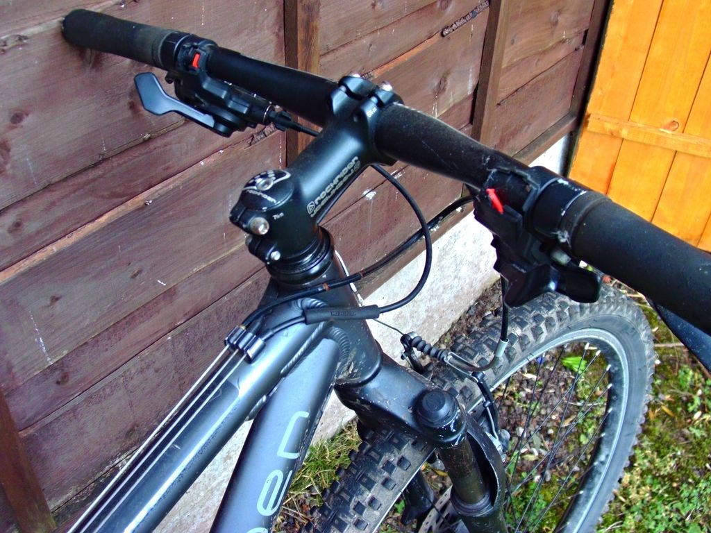

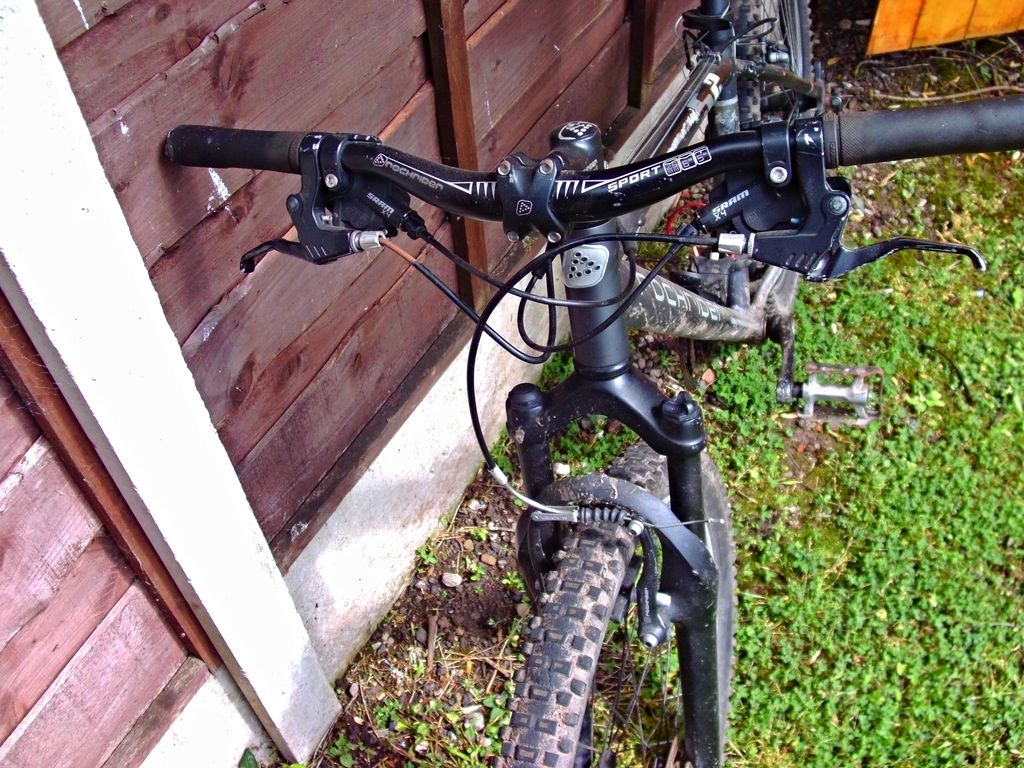

PostPosted: Mon Jul 27, 2015 10:33 am
Joined: Tue Oct 09, 2007 1:55 pm
Posts: 10504
Location: New Forest, UK
A very tidy job!
I'd twist the bars round - the curve is meant to give some sweep backwards not downwards. Standing on the right I reckon they need a turn of almost 90 degrees clockwise. Your wrists will thank you.
If you are still feeling cramped, then check saddle height - an outstretched leg's heel should be about 1" or so below the pedal with the crank in line with your leg. Also, the bars are pretty high compared to the saddle. I would try flipping the stem the other way up.

Thanks Hamster ,
Yes the bars aren't quite right but i'm not to concernd about it as i'm waiting on posty bringing me some slightly wider one's and as for the handlebar stem i totally agree they would be better the other way and will be doing that very shortly so the bars will get sorted aswell .
I've altered the saddle height since the pics were taken and it feels much much better than before so once the bars and stem are done it will feel a lot more comfortable and i'll be altering the crankset to just the 42 tooth single as i'll be using my bike mainly for trails so the forks will be changed for straight rigids too ..

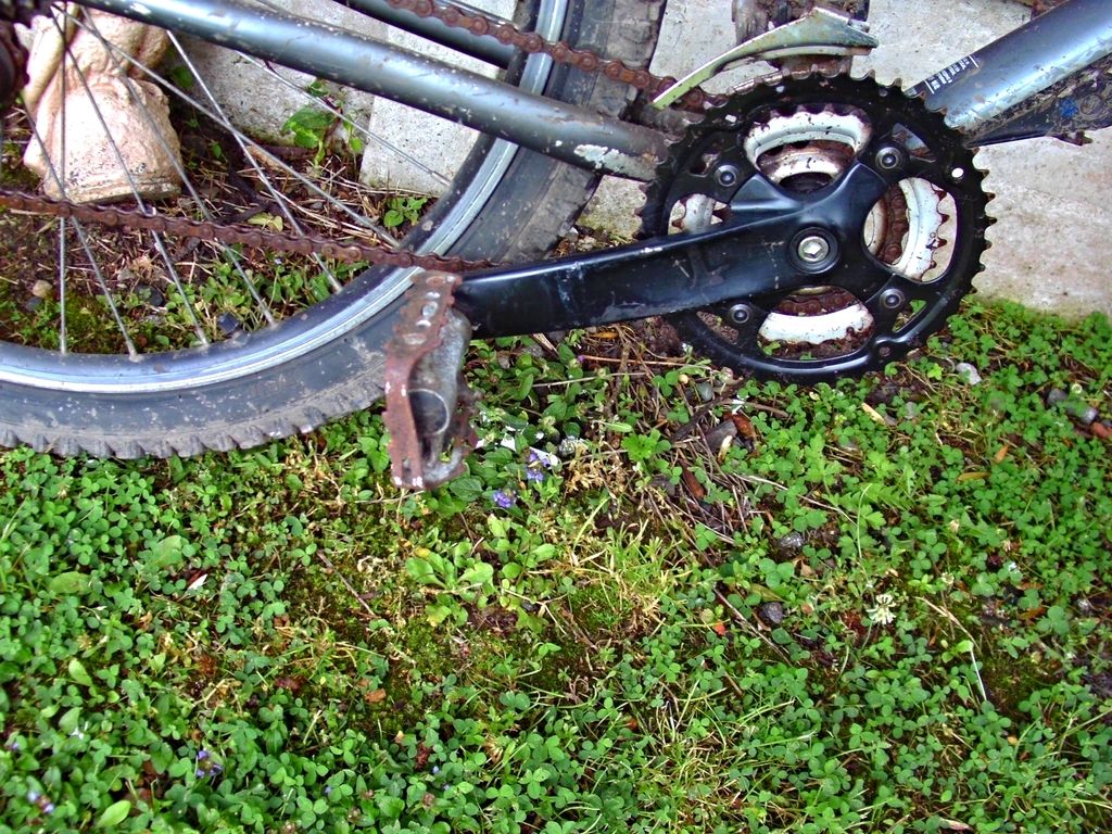

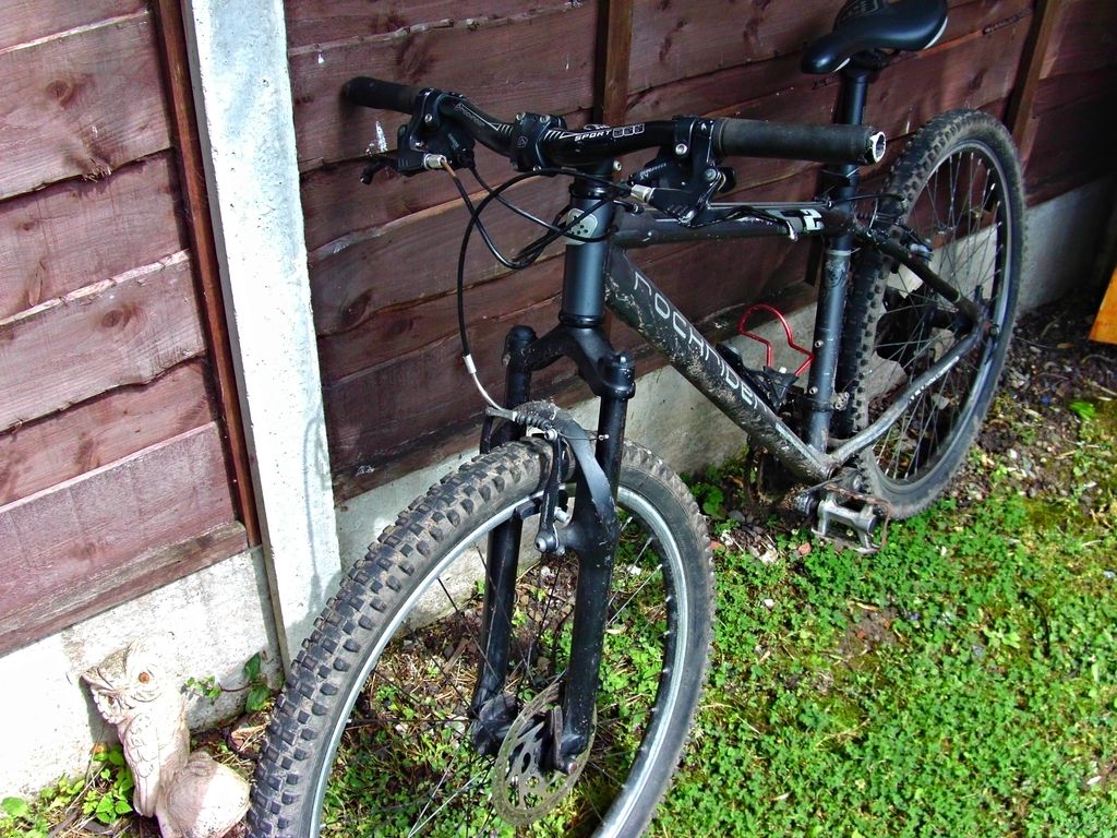

Just a wee update as i've now altered handlebar stem and handlebars plus changed and modyfied the crankset for better chain positioning .
Thanks to my wife phone camera i've got clearer pictures and as usual all construtive comments are welcome ;) .
PostPosted: Thu Jul 30, 2015 4:12 pm
Posts: 10504
Very nice! You could unleash a massive :roll: weight saving by shortening the brake cable outers a fair bit. The front one in particular would sit a little happier with about 10cm less outer. It's unusual to run left-front right-rear in the UK.
You can tuck the excess inner of the brakes behind the pip on the brake arm which holds the spring for a neater appearance.
