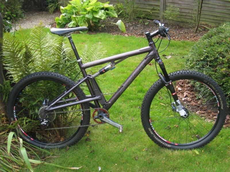

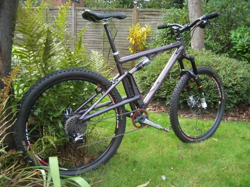

I'd been looking for a grey anodised SL (with V-studs!) for quite a while. Aquired this one a few weeks back, built like this...
I fancied trying a 1x10 set-up and (surprise, surprise, for me!) I wanted lightweight as well :)
Now built up as below...
Spec:
Frame: Santa Cruz Superlight - 2066g (bare frame) + 295g (shock and bushes)
Fork: DT Swiss XCR 100 RLC - 1159g
Headset: Chris King No-threadset - 91g + 14g (crown race)
Top-Cap: Hope top cap and bolt - 8+3g
Stem: Syntace F99 (inc ti bolts) - 101g + Spacers (12g)
Handlebar: Easton CT2 Riser - 175g
Grips: Ritchey Foam - 24g
Brakes: Hope Race X2 - 214+252g (inc. adaptor, hoses and levers)
Mounting bolts and washers - 18g
Discs KCNC - 75g (160mm)+60g (140mm)+16 (ti bolts)
Shifter: XTR M980 10spd - 103g
Front Derailleur: NA

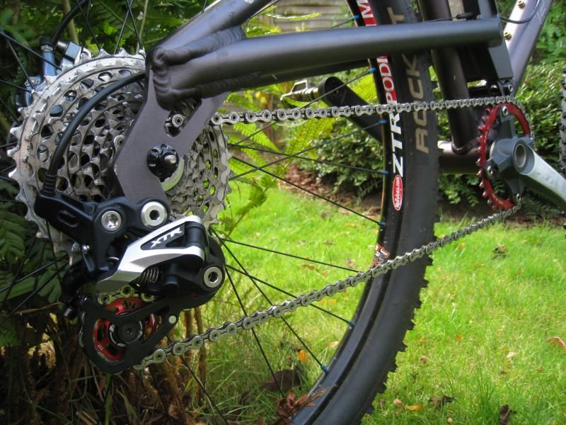

Rear Derailleur: XTR M980 (with Saint short cage) - 177g
Derailleur Cables: Quaxar outers - 6g+2g+1g + Powercordz inner 1g
Cassette: Sram XX (11-36) 10 speed - 208g
Chain: KMC 10SL - 242g
Cranks: XTR M970 - 535g
Chainring: Wolf 32T narrow/wide - 41g
Chainring bolts:Steel - 15g
Bottom Bracket: Shimano XT (Hollow Tech II) - 88g + 2g (spacers)
Pedals: Crank Bros Eggbeater 4Ti - 168g
Hub Skewers: KCNC - 46g
Rims: Stans Podium
Hubs: American Classic
Nipples: Alloy
Spokes: - 1262g (wheelset)
Tyres: Schwalbe Rocket Ron (2.25) - 888g
Tubes: Stans Fluid - 20g per wheel
Saddle: Flite Titanium Alpes - 198g
Seatpost: USE Alien Carbon - 189g + 21g (shim)
Seatpost Binder: Clamp + bolt - 17g + bolt 6g
Weight: Approx 8726g / 19.24lb
Cheers :)

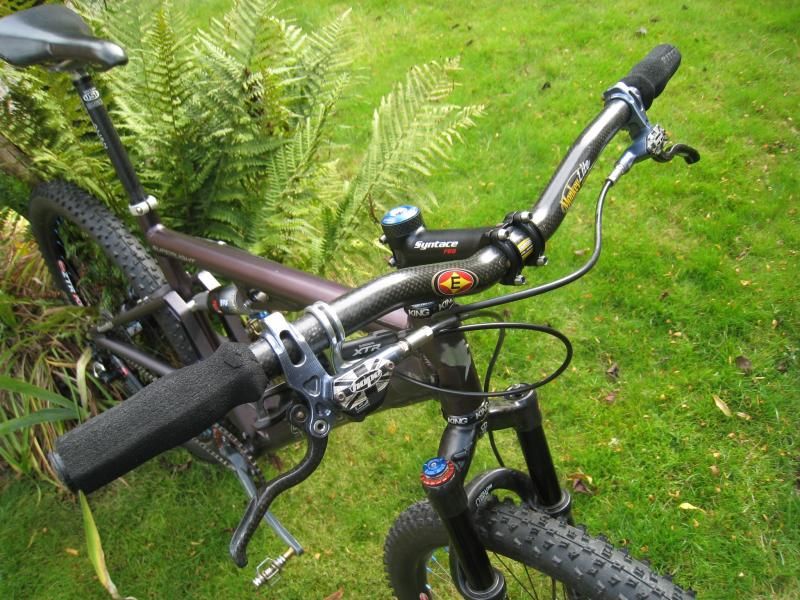

Nice indeed, I'd ditch the red ring for black, spacer above stem must go and so must the hateful ritchey grips.
